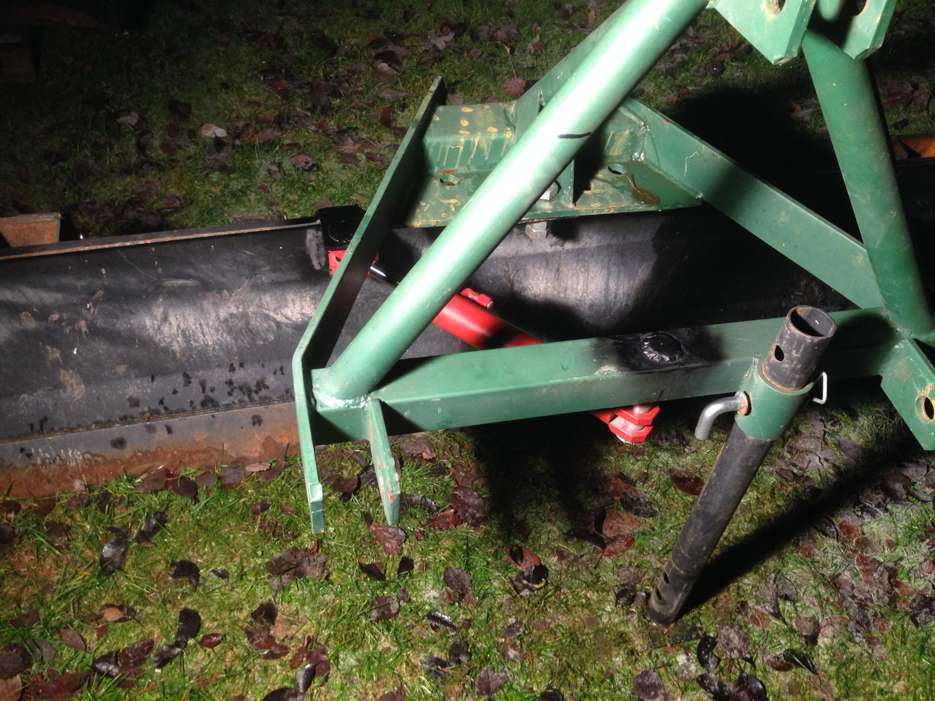

I need a 6/2 valve to get an extra output for the back-blade. As i understand it, i need another valve then...
I ordered a hydraulic sylinder today, so with some welding i will be able to turn the back-blade in both directions.

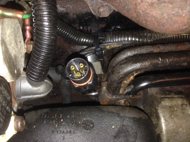

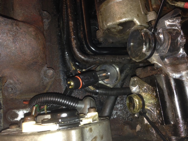

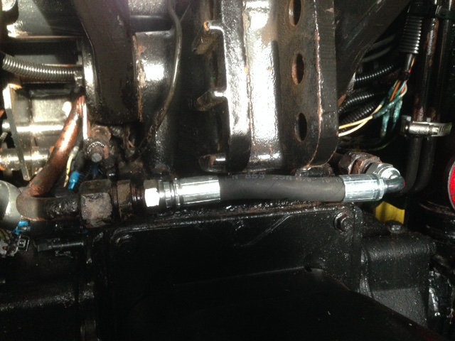

Got a little further now. I finally decided to remove the valve, so i replaced it with a hose. Problem solved :)
I also mounted a block heater. A DEFA with 1". Thanks to this forum, i was able to find the right size. The lokal dealer only had the one for fros-plug, but now i have found the type with the right threads. It was quite hard to put it into place. the pipes had to be bent a little. But it was possible, and im very pleased with the solution.

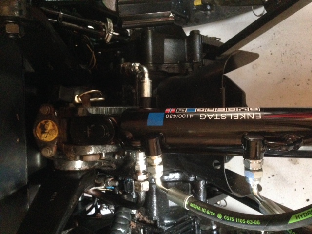

Finished the back blade with hydraulic sylinder. Seemes to work great!
I also made an extra hydraulic outlet using a electric 6/2 valve.
