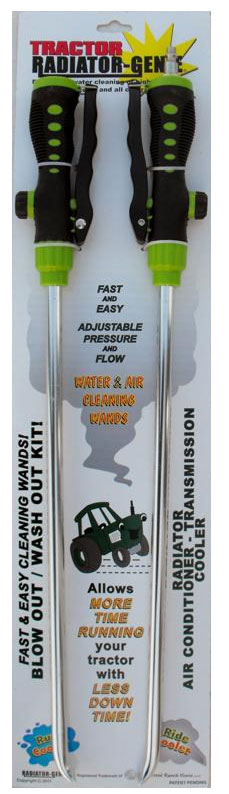

I only use air for cleaning the air filter. This is what I use for blowing filters and the rad clean. One is for air and one for water. They both are adjustable for low pressure high volume cleaning at just short of a 90 degree angle. They're sold on line but my dealer stocks them. See them here
Radiator Genie Cleans out Clogged Radiators
