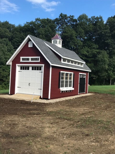

I agree the ROPS should be under 8ft for this category of tractor. I am looking at buying a new tractor. The wife said I have to have a shed to store the tractor before I can buy it. I had my shed built with an 8ft garage door. I am considering Kioti, Mahindra, and LS. The height of the ROPS is making me think twice about buying the Kioti.

It all depends which tires you choose. The 99 inches in the specs is for AG tires. R4's is more like 91 or 92 inches. I can just barely get in my door with the rops up, but my door is less than 8 feet of clearance due to the way the door is mounted. I usually fold mine, just so it isn't that close. The 3510se came with pretty convenient pins on the rops, I just replaced the cotter pins with lynch pins, and it takes 10 seconds to fold it down.

FWIW, my CK3510SE HST has the big Titan turf tires that Kioti offers. They are filled. With the ROPS up, the height is exactly 92-1/2". My garage doors are 8 footers, so with the door up, the height to the lip of the door is about 95". Like NYCheese, I can drive right in. I do believe, however, that the R4s sit a bit taller than the R3s, so you'll probably want to double-check that.

i have a cab model 3510, and lets just say its a good thing i opted for the commercial size doors on the garage i built last year! doors are 10 wide and 9 tall. i have clear 12' ceilings. i think i have about 4 inches to spare with the cab and R4 tires.
