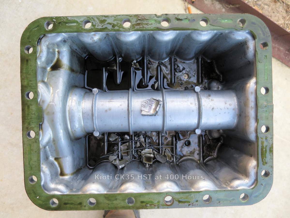

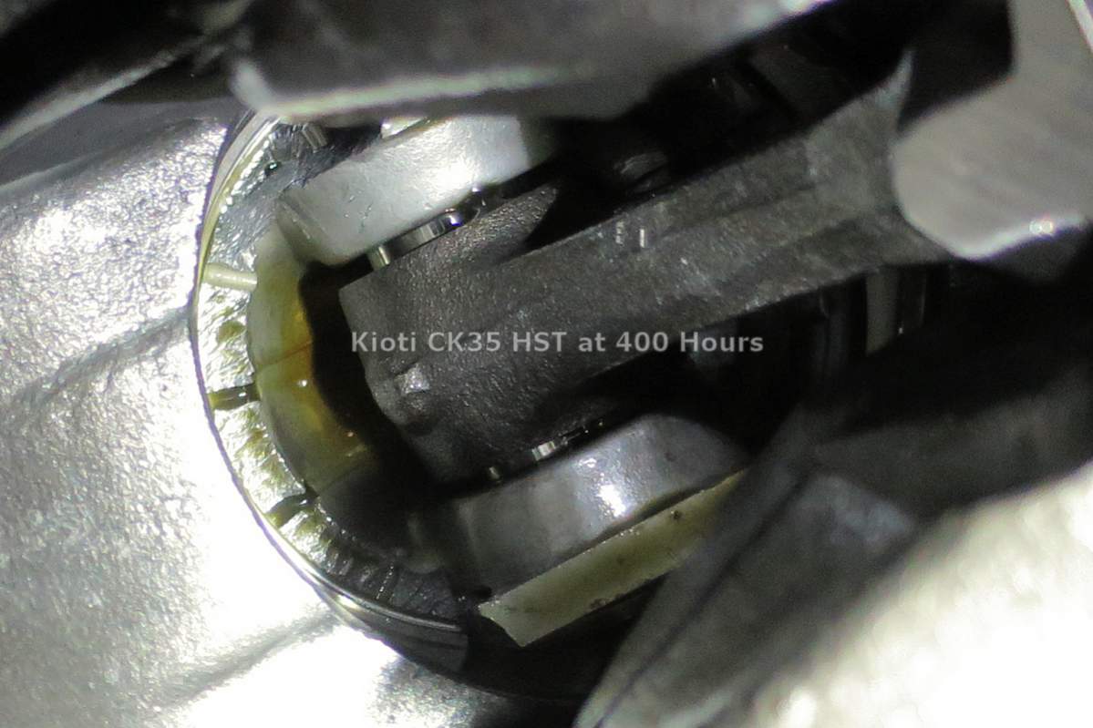

I really appreciate that, thanks. Initially I had thought, this has to be his fault, that he over-worked the engine while grading our road and moving around buckets of gravel. However, I've since been told that these engines can't be over-revved because they have built-in governors... is that true? Also, during the time that he had the tractor, he would work for about an hour in the morning and then go home and take a break to cool off from the sun, and then do the same in the afternoon, and then put in another hour or so near sundown. It wasn't like he was on it all day, every day. He can't take that kind of heat (few of us can down here). So yes, my gut reaction was that he over-worked it, but then I thought, how could that be? And now based on the input from you folks, it sure seems to make more sense that the cause was most likely a manufacturing defect.
I'm not a confrontational guy, and my neighbor is indeed a good neighbor. I harbored ill thoughts about this situation, but haven't actually said anything to him about it. He knows the tractor has a serious issue that happened while he was in the seat, and he doesn't feel good about it. To me it would be a relief to know for sure that it's a defect and not mis-use.

CenTex Chris;4203084 My neighbor had borrowed my tractor to spread several truck loads of gravel on our private road. It's a 2010 Kioti CK35 HST with 408 hours said:
PS By the sounds of this description it sounds as if this person wasn't smart enough to shut the machine down when it showed signs of something wrong. That being said I wouldn't let him borrow anything else ! Think about it "I smelled something hot" They keep running it and next thing you know you need a head replacement because they overheated it. Common sense approach to any ones machine is if it starts acting funny you shut it down right then and there and call the owner, not continue to work or drive it back for them. Any damage done will only get worse with more run time !
That pretty much true.
But going down a steep high with the throttle open the weight of the machine can overrun the governor
