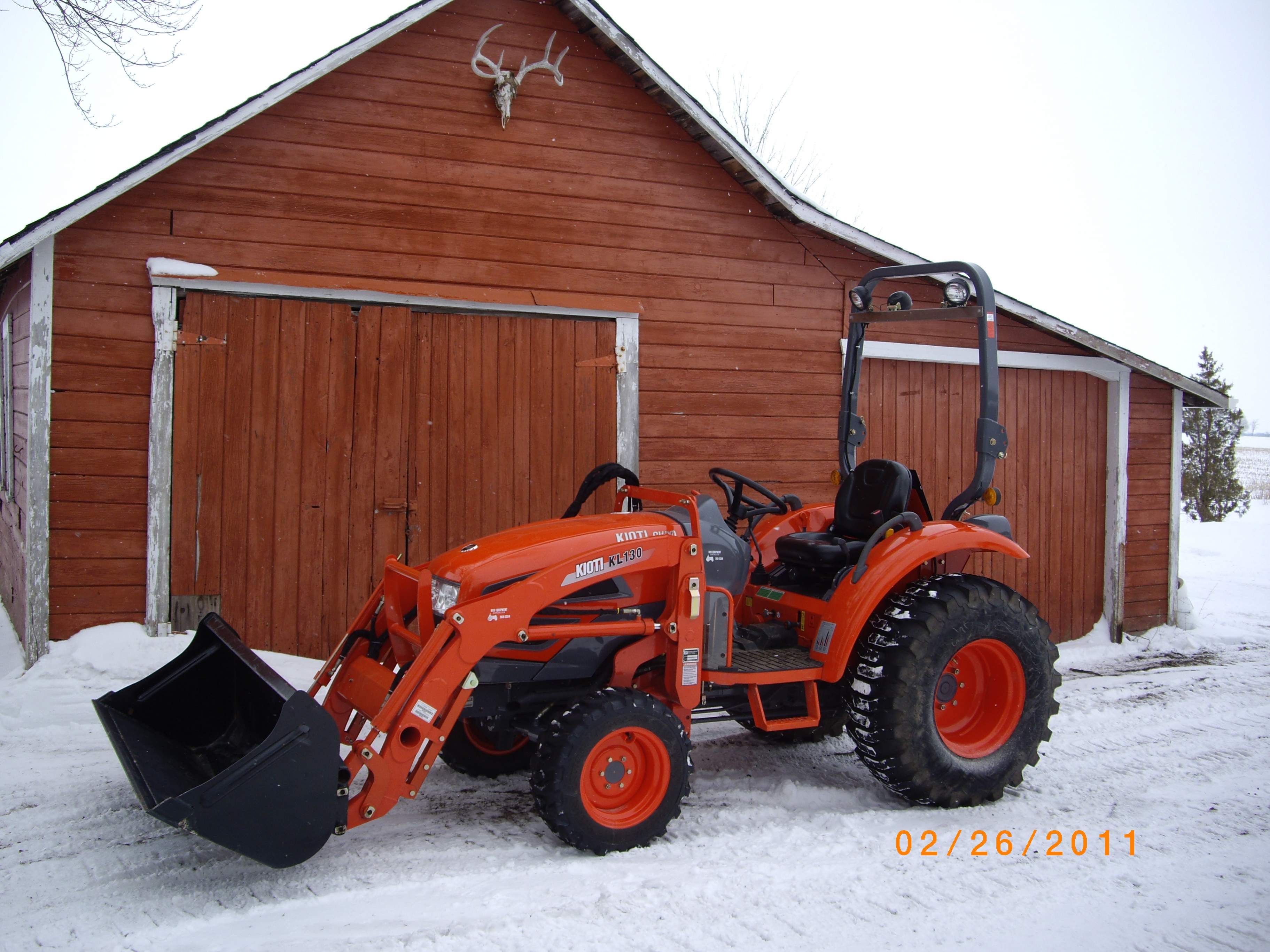

Interesting Motorseven
here is a picture of my bucket could you post yours?
Pay no attention to the snow in the picture it's not here now!!!!!!!!!!!!!!!:thumbsup:

That is a very large bucket for that size loader...
I have a Stoll FC 350 on my New Holland and the bucket on it is 1/2 that size...
I don't think that anything is wrong with your loader...
It looks like they put a bucket larger than the lifting capacity of the loader...
   / CK30 FEL lifting weight? #7
That does look like a HUGE bucket for the loader.

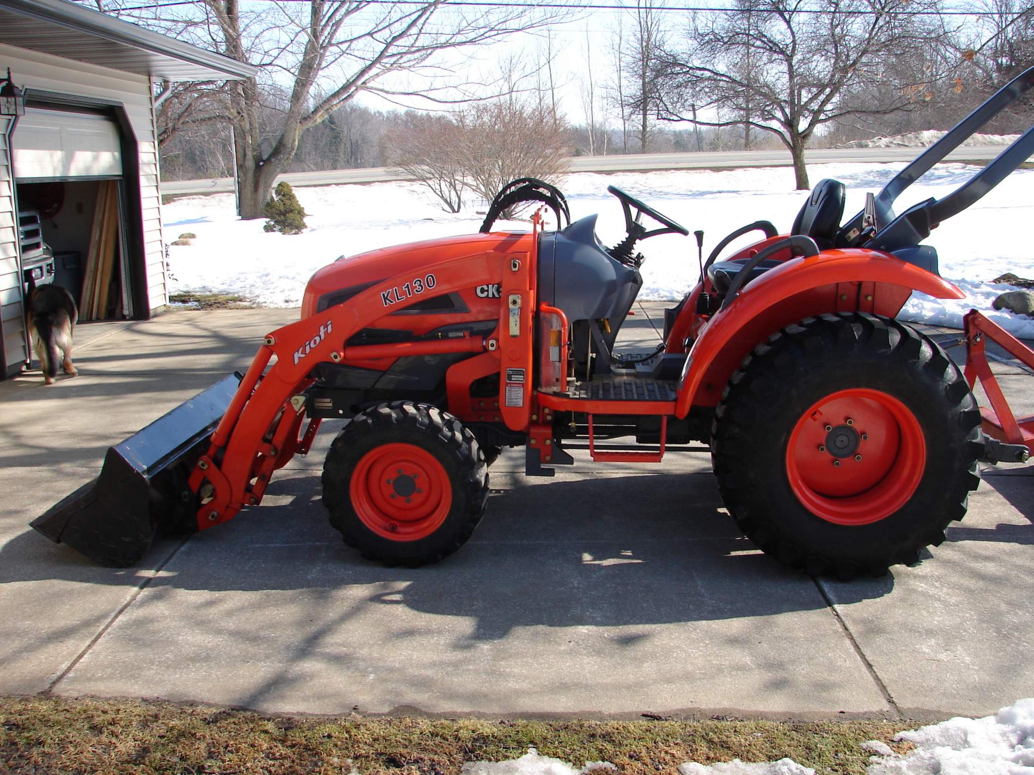

That is the newer and larger bucket that Kioti uses for the QA. Besides the bigger size, you'll see the formed ridge on the side panels. The smaller bucket is flat on the sides with an extra 3/16 by 3 inch or so stiffener welded to the front edge. This is a picture of my bucket.
   / CK30 FEL lifting weight? #9
Yep, Victors is the same bucket my CK30 had. HB, I don't think your problem is the Q&A or the bucket size, something is wrong with the plumbing/pump/valves/cylinders.
The new KL130 bucket level(not heaped) volume is about 7 cubic feet. A cubic foot of gravel weighs a littl over 100lbs, so a bucket will have max 700 lbs in it which is well under the max lifting capacity of the loader. But, your relief valve kicking in at 2700psi does not help matters...it should be 2000psi. I would get them to fix the relief valve and try it again.
Even heaped it's 10 cubic yards & your tractor should lift it. But I have to be honest, one of the reasons I traded the CK was lift capacity due to the fact that I was picking on things that were well above the Ck's weight limit. The KL401 is a beast of a loader but even so I have found some things it can't do....a 24"x16' fresh white oak log for instance.
