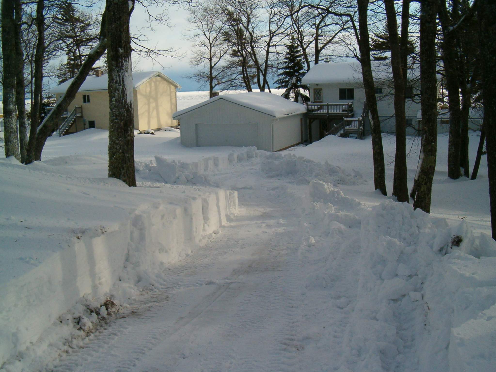

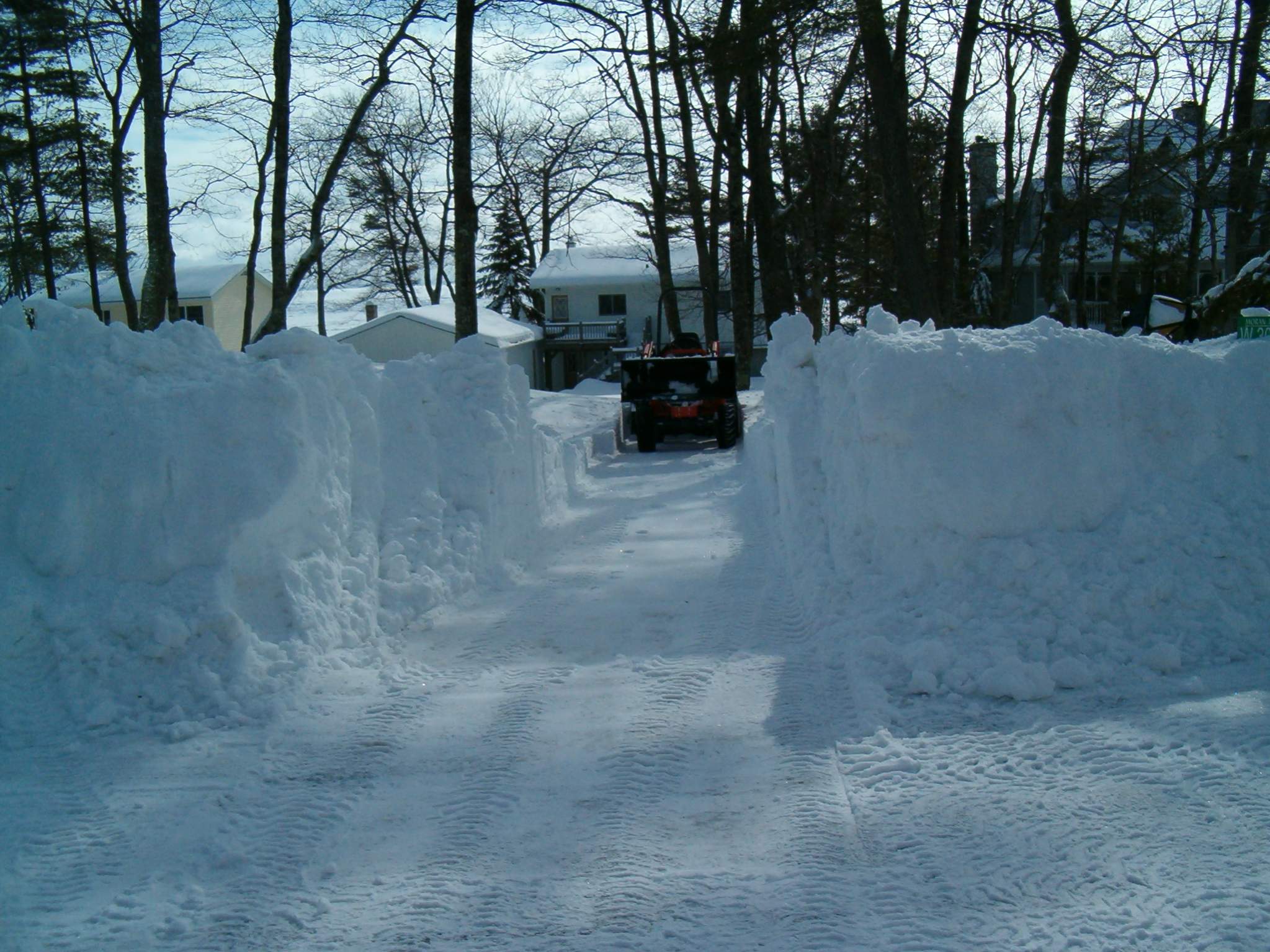

Just a little last minute tip for the first time you put your rig to work. Remember to shift pto in gear and let up on clutch slowly while engine is at idle or perhaps 15-1600 rpms. That will start the auger turning. Now bump up your RPM's slowly to the red triangle on the tach that gets you the desired rpm's for your meteor. If you have babied your CK20 it will sound like that little diesel is really racing but that kick's the snow up and away. Same thing when slipping PTO out of gear, throttle down and don't use clutch this time as you slide pto lever out of gear.
My rig should be identical to yours. As I recall on the tractor there are three holes for the tractor side of the toplink. Adjust and set the top link to fit in the middle hole. The first time you raise the three point/blower should you use the top hole the handle for chute rotation could possibly strike the slow moving vehicle placard. Either the handle or the plackard holder can get bent if this happens. You can also set the stop for the 3ph lift lever so it can control how high the blower & handle come up when you lift your blower. Just keep an eye on that for the first few times and adjust if necessary so you don't have any issues.
I keep a coffee can with some 30 wt. oil and an old paint brush so I can paint on some oil on the blower ooodrive chain. A little light oil keeps chain llubed and clean used before each job.
You have a real beast there. I have carved through drifts of packed snow on the beaches of Northern Lake Michigan. Pickups with plows could not touch those same drifts but that rig cut those wind rows of snow like a drill. Have fun but be safe.

Have you ever had the ice pile up on the shore close enough to cause concern? Looks like you have a beautiful spot there snow included. By the look of the radars you should have some more snow in your future.

In the thirty years that I lived there that never happened, Steve but a few miles West of there that phenomenon came about one Spring. The ice broke up in the spring and was floating around out in Lake Michigan when a strong South wind came up suddenly. The wind managed to heave those ice sheets up on shore until it reached the state highway where it blocked traffic. It took the State Hwy Department more that rock salt to clear that ice from the road surface.
