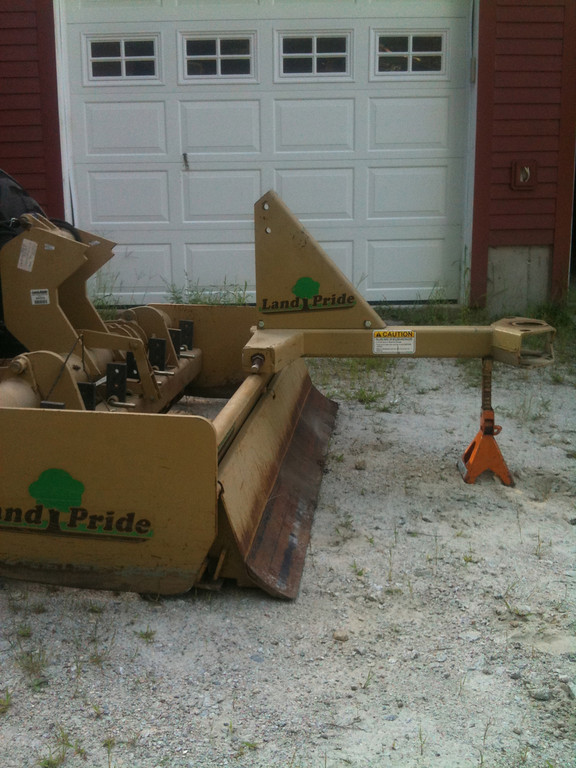

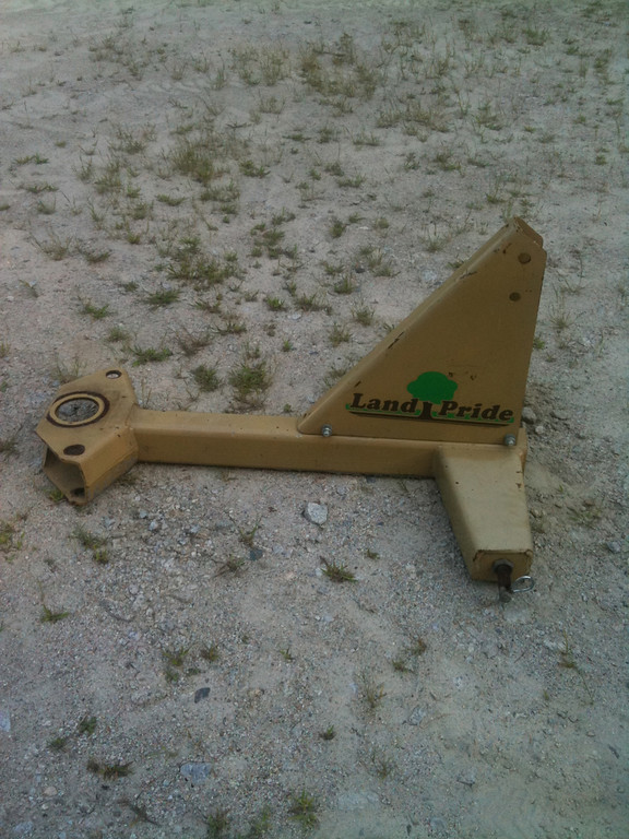

Here is an idea that I thought of quite a while ago, when I was considering building a gauge wheel for my box blade. I had a spare 3 point hitch frame from an old rake that was destroyed, it's fairly light duty, but I imagine would hold up just fine. I was going to build a wheel setup that I could either bolt, or weld to the end of this frame.....
Then I was going to mount it to the box blade like this.....
I was planning on using a hydraulic cylinder connected to the upper portion of the box blade (where the top link connects to) going to the top link connection of the 3 point hitch frame. I never did build this wheel setup but I still have most of the parts for it. The way I was going to mount it to the box blade, was by welding some mounting points for a quick hitch setup onto the box blade. Then, when I wanted to use the gauge wheel, I could quickly attach it to the quick hitch (the quick hitch would "live" on the box blade). This way, i could easily remove the gauge wheel when I didn't want the extra length of the gauge wheel sticking out past the box blade.
I may have a picture or two of how I was going to mount the quick hitch, I'll see if I can dig it up. I believe the quick hitch from harbor freight was less than $100.
