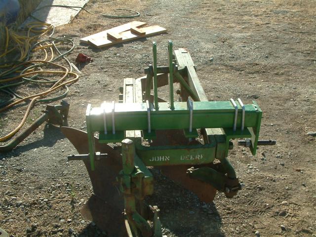

Do you think it would be reasonable to ask my Kubota L2350 (25HP 4WD) to pull this plow or one like it?
John Deere plow
My Dad used to pull a two bottom plow with a IH Super C gas tractor with no trouble. Can I expect similar performance from a CUT of similar HP?

I have that exact plow--paid $150 for it a few years ago. I pull it with my Mahindra 5525 (54 hp engine, 45 hp pto, 2WD).
The 3pt hitch assembly on the plow was shot--wouldn't hold adjustments. So I had to weld up a modified hitch to get the plow to work.
Your 25 hp tractor probably only has about 18-20 hp on the drawbar. Even with 4WD I'd say you're marginal on power.
That is a nice mod on that hitch. Looks like you got your hitch pins offset about right. Ken Sweet
Thanks.
I measured the old hitch assembly and used the two diagonal supports that came with the plow to get it close. I allowed for a little bit of adjustment in the new hitch assy.
