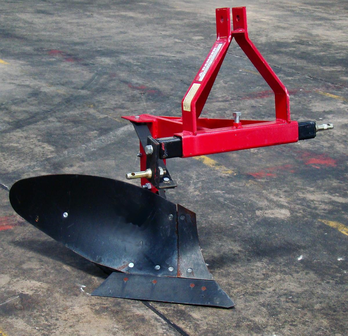

You'll be cutting and pulling roots for days out of tiller .. plus the carnage of the unseen rocks can do..
I would bottom plow it, harrow it, rake it... Then rototill all you want.
   / Can I plow a garden with only a tiller attachment on new, never plowed, rough ground? #3
Agree with RedTop. If you know there are roots and rocks you are just going to destroy your tiller. Plow is a fairly cheap investment. You may even be able to borrow or rent one.

Bottom or moldboard plows were originally developed for breaking new ground for crops.. you rollover the soil to breakup and expose unwanted debris in soil ..
Harrowing/disc will loosen up soil more and break down debris a little more... Then you can use a landscape rake or manually pull unwanted rocks, roots..debris out of soil
