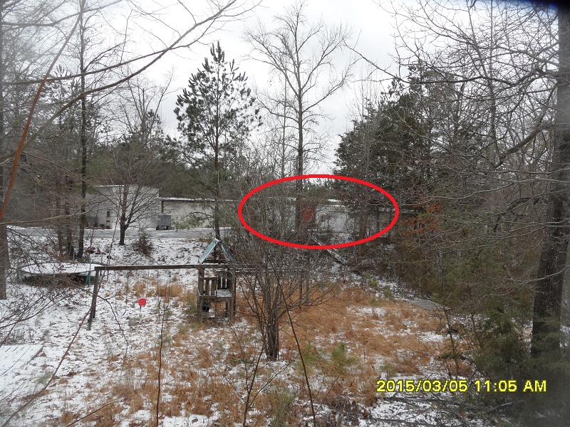

The problem is trees, I've a small lawn in front of the house then about 30 yards there is a tree line and a steep slope. That treeline is fairly dense and is holding the slope from eroding down and removing my lawn. Then there is an almost clear area and another upslope with another tree line holding that slope. This is a 2 year old old photo showing a shot from just past the first treeline of the shops.
attachment.php
The red circle is my target area. During summer the shops are virtually invisible form the house. I've tried putting a 2.4 Ghz antenna outside past the first row of trees and still get virtually no signal with my wifi sniffers outside the shops. 5 Ghz would be even worse. 900 Mhz might punch through both tree lines but as I mentioned I'm looking at them and they are about $250 for 150 Mbps, and the 150 is best case.
493995d1483637277-can-anybody-share-experiences-laying-wl-shops-lawn-jpg
That's going to make it a little harder, but I wouldn't give up on wireless yet. What type of antenna did you have when you were testing? If it was a yagi/directional antenna, then you may still get through the trees. Also, there are move ups for the P2P stuff that will get you even more distance. Trees are a problem though, no doubt about that, I might take a chainsaw to the worst offenders. ;)
Fiber will absolutely get it done; you may want to try some antennas though first (just make sure you can return them) to see if that can do it. As mentioned before, fiber is a real PITA to deal with and there's just not much "consumer grade" hardware designed to work with fiber. Yeah, you can get cheap media converters, all the one's that I've used are crap. I'd get a Ubiquti or some other "prosumer" device that can use single mode GBICs for each end if I went fiber. That's not gonna be cheap, but a lot less than using something from Cisco (where the darn GBICs can be 1000 bucks a pop).
