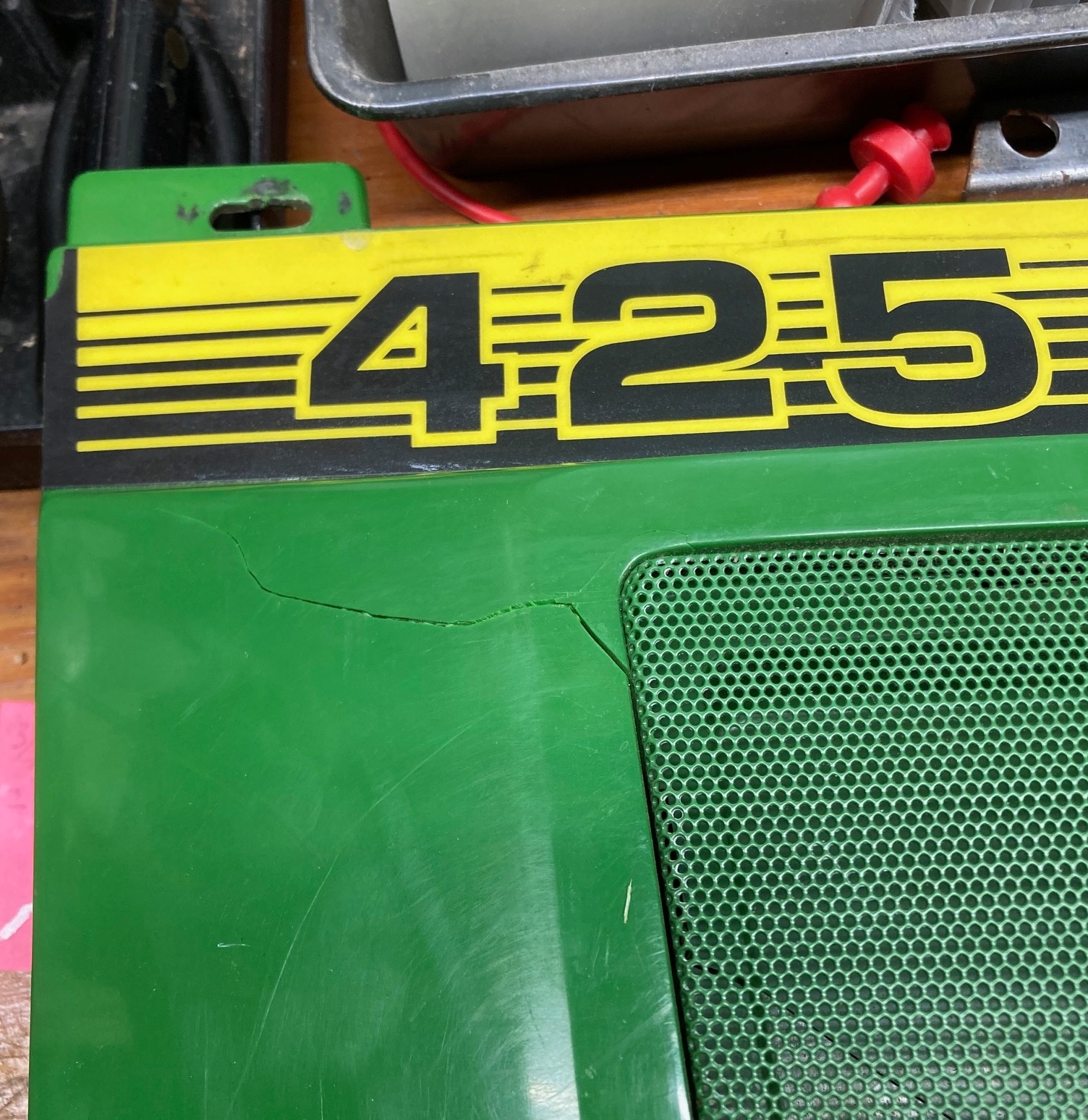

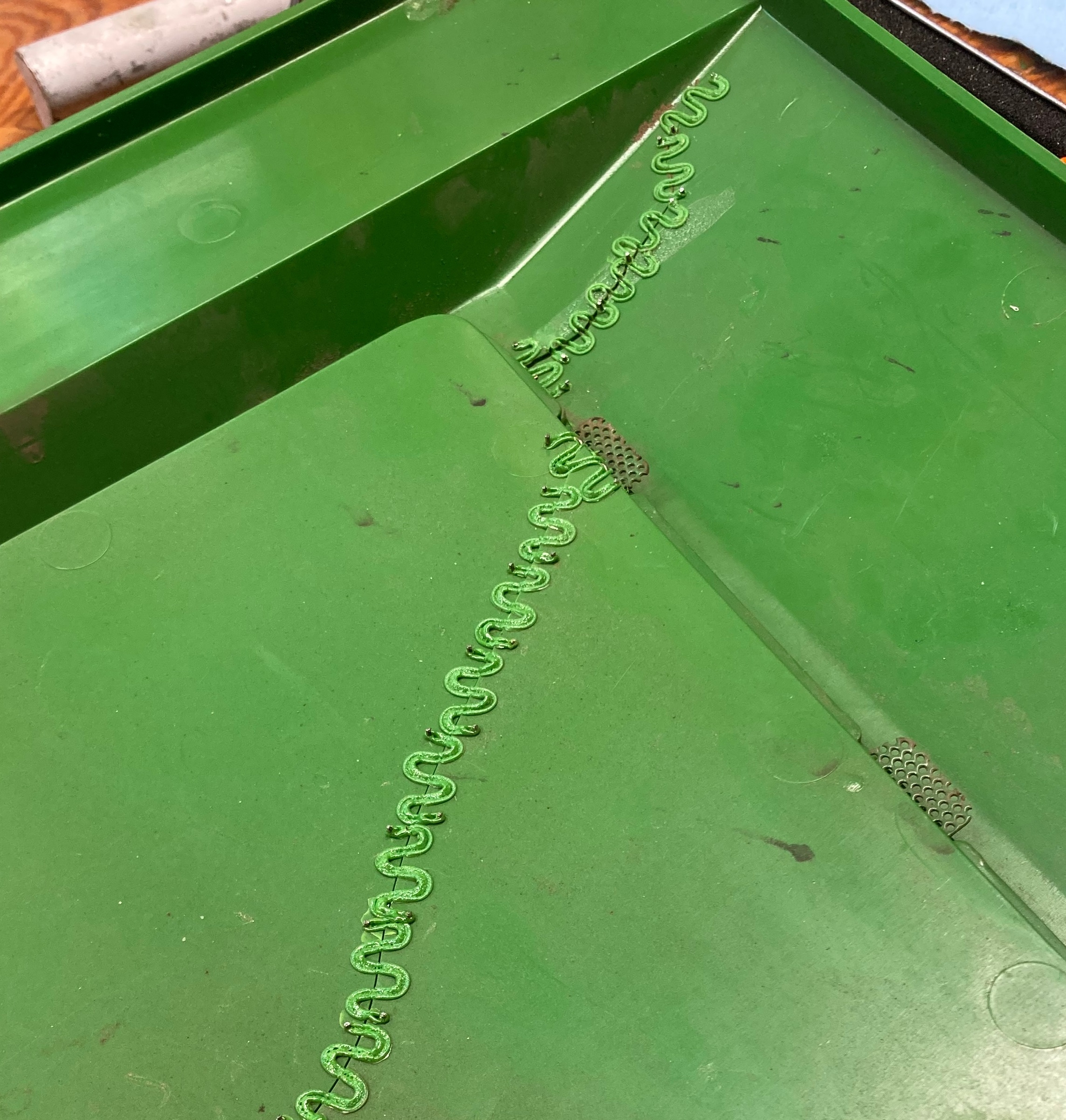

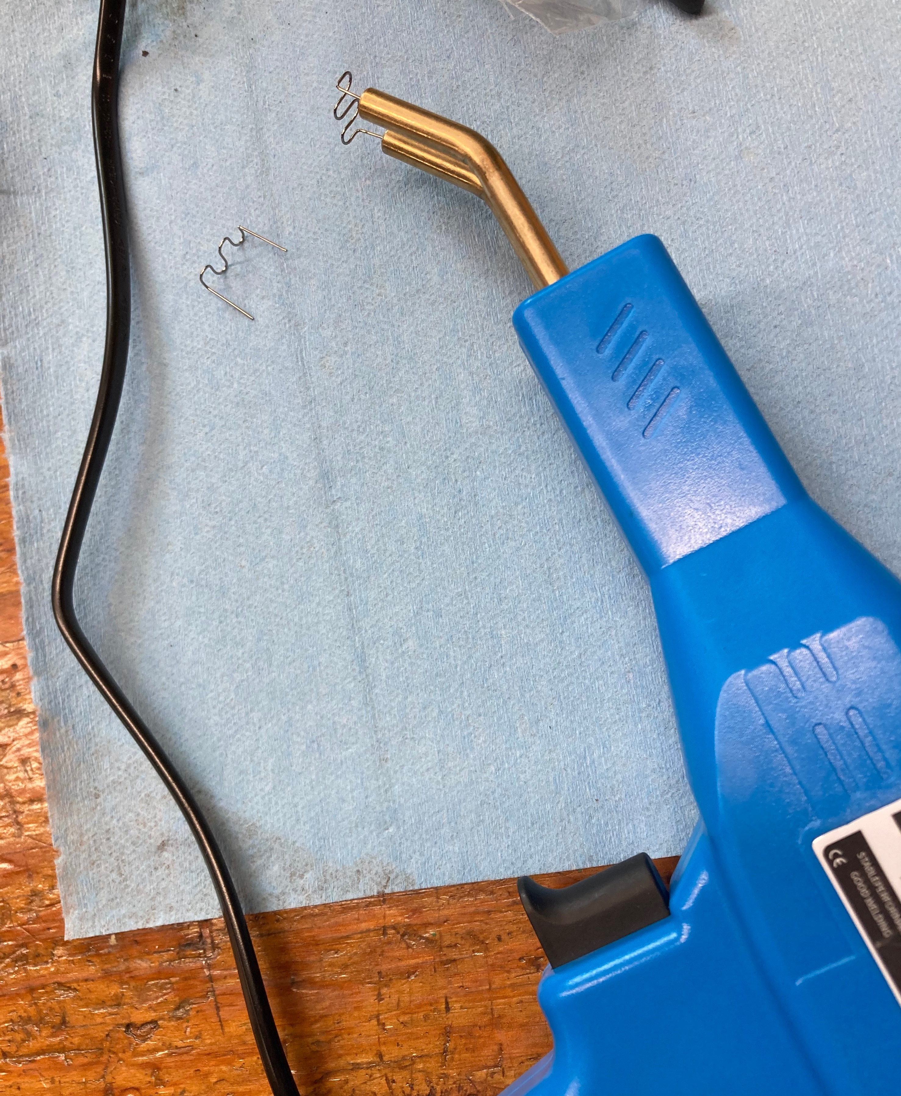

Have pics of the damage? I've found that for cracks in the plastic that heated staples work quite well to stitch the cracks together and they have held up well.
Showing crack in JD 425 side panel repaired fairly well using this staple kit that melted staples into the plastic. Wanted to get around buying new parts from after market sources as the Deere color never seems to be a good match. After two years, happy with the results of the repairs.
Showing the crack front side, the repaired crack backside, and the heating tool to heat the staples and melt them into the plastic.

Let's just say that it's quite a bit more than a few cracks. Multiple collisions with large, low hanging tree and shrub branches. I grimace every time I gingerly open and shut it. Will post some pics if I get a chance.
