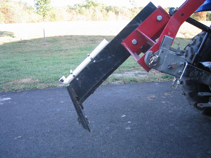

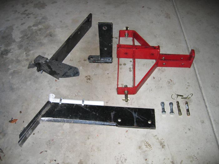

/ cable laying #4

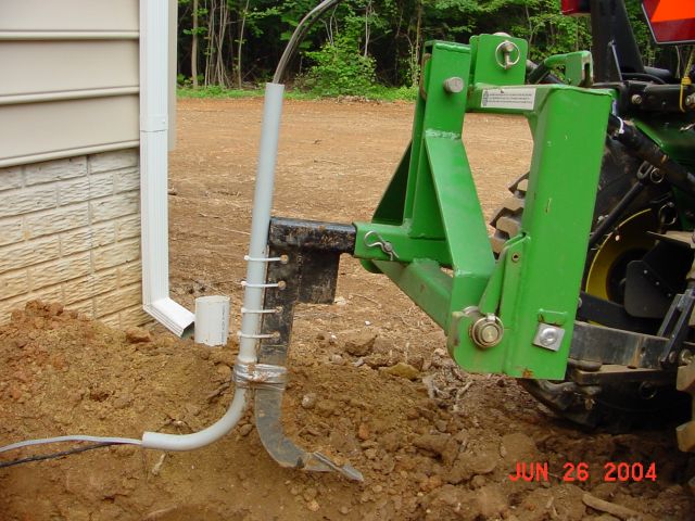

OK well you tried. So here is mine. :D
Mine is a Howse brand unit that is convertible from a Sub-Soiler to a Middle Buster to a trailer hitch. It comes with 2 bolts that must be used to attach the blades but I found them a PITA to use so I just substituted 2 short top link pins so it only takes a few moments to change a blade.
On the back edge of my sub-soiler blade I drilled two holes. I used simple hose clamps to hold a plastic pipe to the trailing edge of the sub soiler blade. To use the cable layer you simple run the cable down through the pipe and out the back, it can be tied around a stake that you drive into the ground. You simple drive the tractor forward with the sub-soiler blade down and feed the wire (or hose) through the pipe. I've also seen people use muffler pipe instead of the plastic pipe I used. Using muffler pipe would give you a larger radius curve and might allow for a semi-rigid pipe to be buried, or at least a large diameter hose.

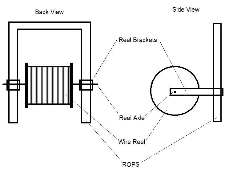

/ cable laying #5
I have pondered this one before.
I would use a conduit 90, either schedule 80 rigid PVC or metallic. It would give you a nice even sweep. Make sure you use a bushing on the top side of the 90 to prevent the conduit edge from cutting into the cable. One better would be to mount (duct tape) a funnel to the top of the conduit to help feed the cable into the 90 while protecting it from being cut by the conduit edge.
Also, you could make a simple bracket to mount off of the ROPS (see attached). This would feed the wire directly down to the 90. If you didn't feel comfortable with modifying the ROPS in this manner, than you could build this bracket off of the cable plow frame.
One other note. Before plowing in the cable, I would make an initial pass with the subsoiler by itself to make sure you have a clear path.
Once the cable is secured on the one end, this should work very well and should be very inexpensive to accomplish.

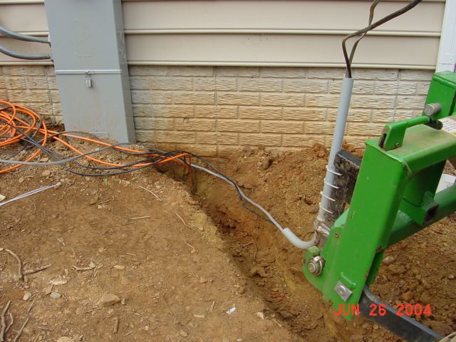

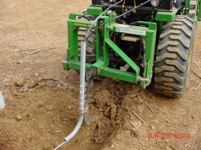

/ cable laying #10

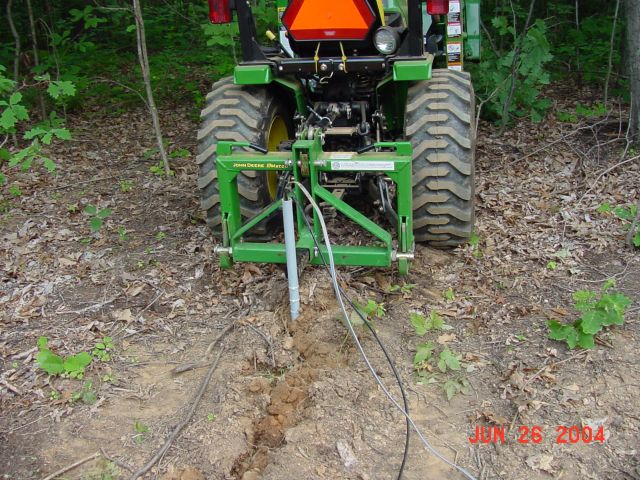

Kennyd,
Nice setup. Good idea to adapt the trencher to your 2" receiver hitch, which matches up to your iMatch. Did you make the 2" receiver setup or did you purchase it?
Good idea to use a conduit 90, it has a nice even sweep.
What type of wire were you pulling in the picture? What was the project?
Did you have the reel on the tractor or did you have someone feed the wire into the conduit as you trenched forward?
How did it work? Did you have any problems? Would you do anything different?
/ cable laying #11
schmism said:
edit... id make the wings adjustable so i could varry the depth based on need.
You don't need a spool. You can just lay the wire out to the side and have a helper guide it into the pipe by hand as you creep along.
I think your wing idea will just drag up piles of dirt and sod and be more hurt than help. Skid plates on the blade, away from the furrow, would be better because they will slide on undisturbed grass. However, I would just go real slow and control it with the 3ph and not worry about any skid plates.
gabby
/ cable laying #12
Thanks guys! I need to pull telephone and fiber over to my new barn (about 500'). I was not looking forward to fighting a trencher as I couldn't find a vibratory plow to rent. Rental cost for the trencher would probably be more than the cost of a sub-soiler and I'll have a new toy at the end!
/ cable laying #13
acutually i have made one of these for the exact application of installing radio fence for my pets. You do not wnat it deeper the 3 inches and a subsoiler sucks for this. I made wone from metal from tractor supply for aout 50 buck of materail and an hour of time with the right tools. I have the design in a autocad drawing. It attaches to my cultivator. I will try a get it posted
/ cable laying #14
Neophyte said:
Kennyd,

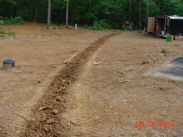

Thank you.
I made the receiver, mainly use it to move my trailer witch I keep in the woods.
It was cheap and easy, I used 1"...
I pulled a 12-2 romex and a 5 pair 22awg BSW (Buried Service Wire) for a telephone and alarm to the location where I am going to build a shed, I did this when I built my house and before the lawn was in.
No reel, I just laid the wire out on the ground and fed it myself as I drove forward. I only needed to go 225' and it was a straight run. If I had to go around corners or turn I would have rigged it onto the tractor.
It worked GREAT! I did make a "dry run" with it first to loosen the soil as I have clay and shale.
No problems! The wire was buried about 12" deep.
If I was going to use it more, I would find a better way to attach the conduit, it got real loose at the end of the run and probably would have come off soon. I would (and may in the future) weld a piece of 1" angle to the back of the ripper tooth to "cradle" the conduit, and hose clamp the conduit to the angle. Does that make sense? I can explain better if need be...
I think dog fence wire this setup would be perfect. You can use 1/2" or 3/4" conduit, it would be easy to hang the spool or reel on the ROPS to feed down into the conduit. Just be sure to plan your route through the yard and not make real tight turns if you can avoid them.
/ cable laying #15
Kennyd,
You could always use a metallic conduit 90, which may reduce the need for the angle support.
/ cable laying #16
Neophyte said:
Kennyd,
The problem I had at the end was that the round conduit kept wanting to "roll" off of the ripper shank. With the angle iron "point" welded to the shank like this >- (top view), the conduit would rest in the "V" of the angle and thus could not roll off.
Clear as mud?
