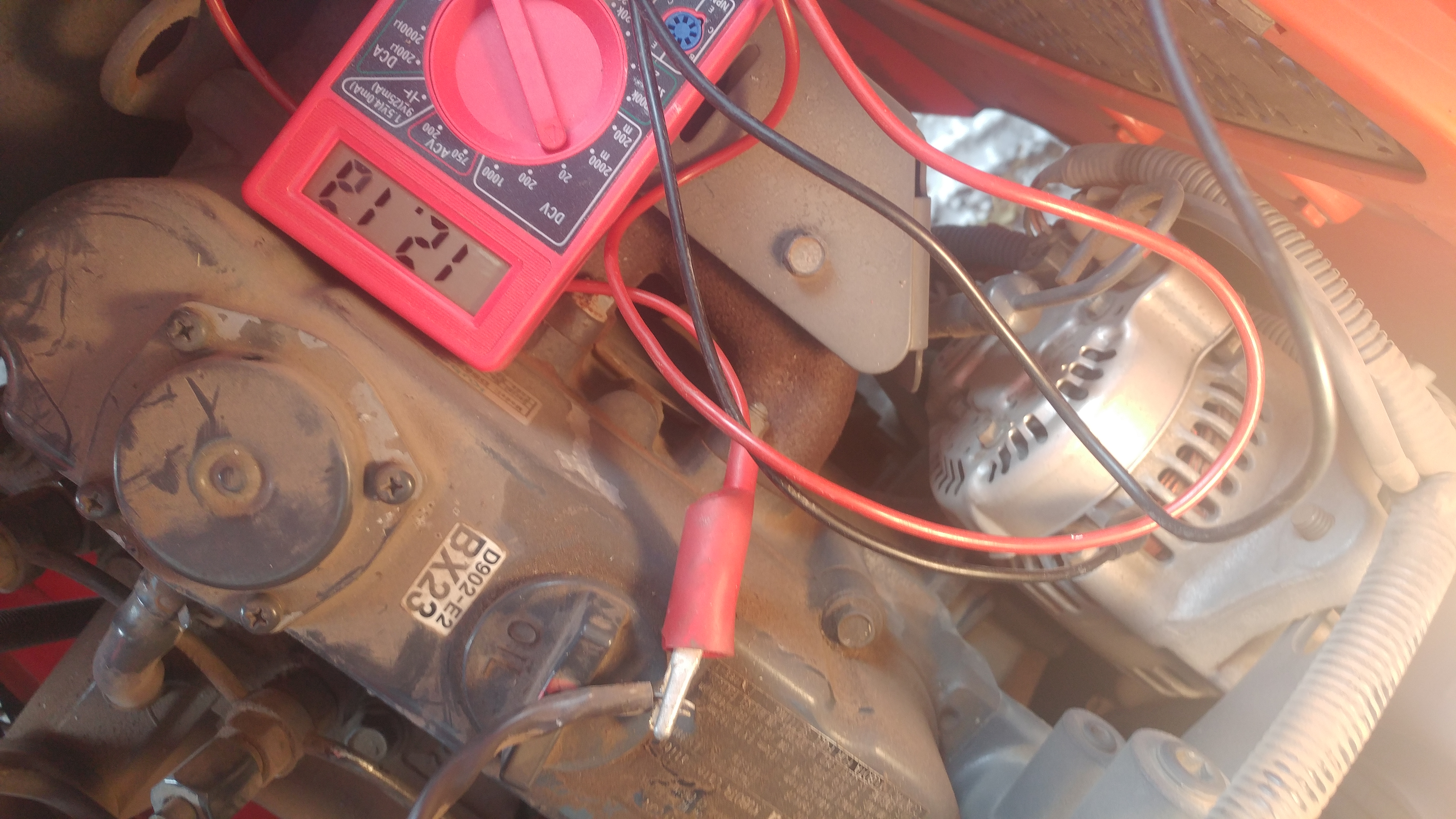

ok - im back inside from working on the BX. first - need to admit a blunder. :eek: when i at first connected the negative side of tester leads yesterday i used the "wire that i thought was a direct ground" but it was in fact the coolant sensor connector. :ashamed: coolant sensor.jpg

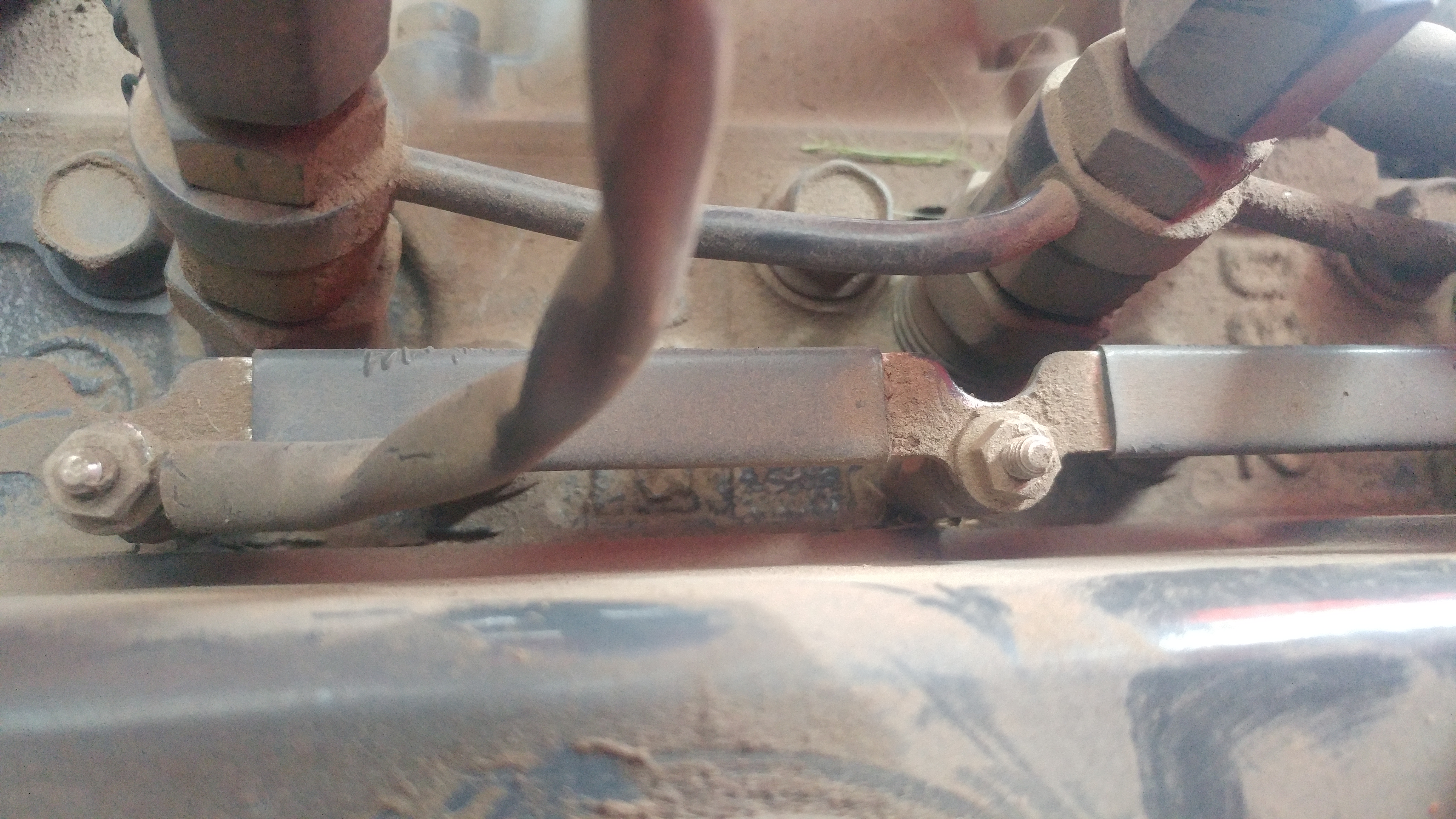

anyways here what it looks like before i started working on it. before take apart.jpg

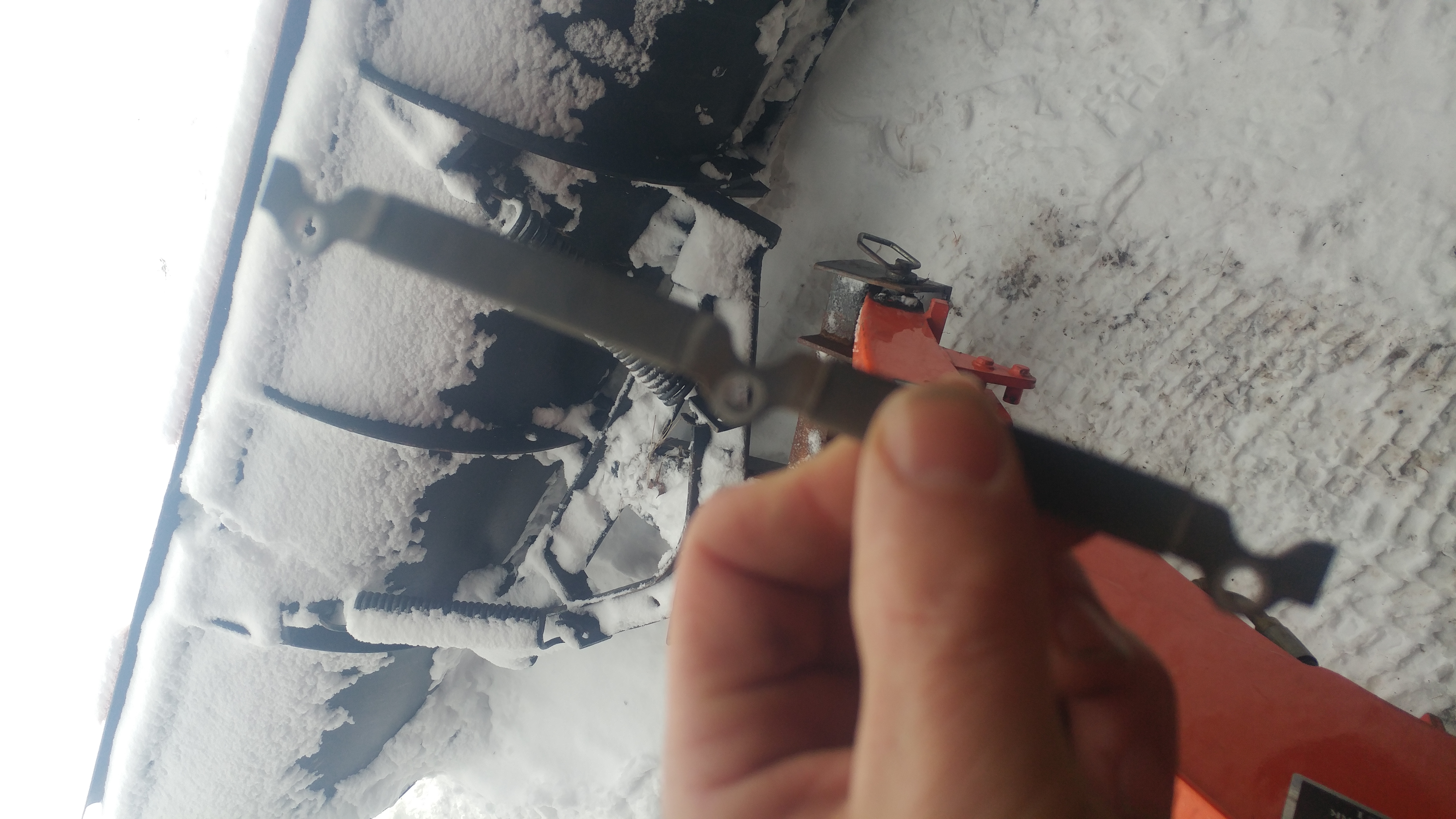

i removed the glow plug rail with 7mm socket and had the telescoping magnet ready to pick up the nuts that fell on the engine. glow plug rail removed before cleaning.jpg the mounting points looked reasonably clean but i cleaned it anyways with a small brass wire brush on both sides.

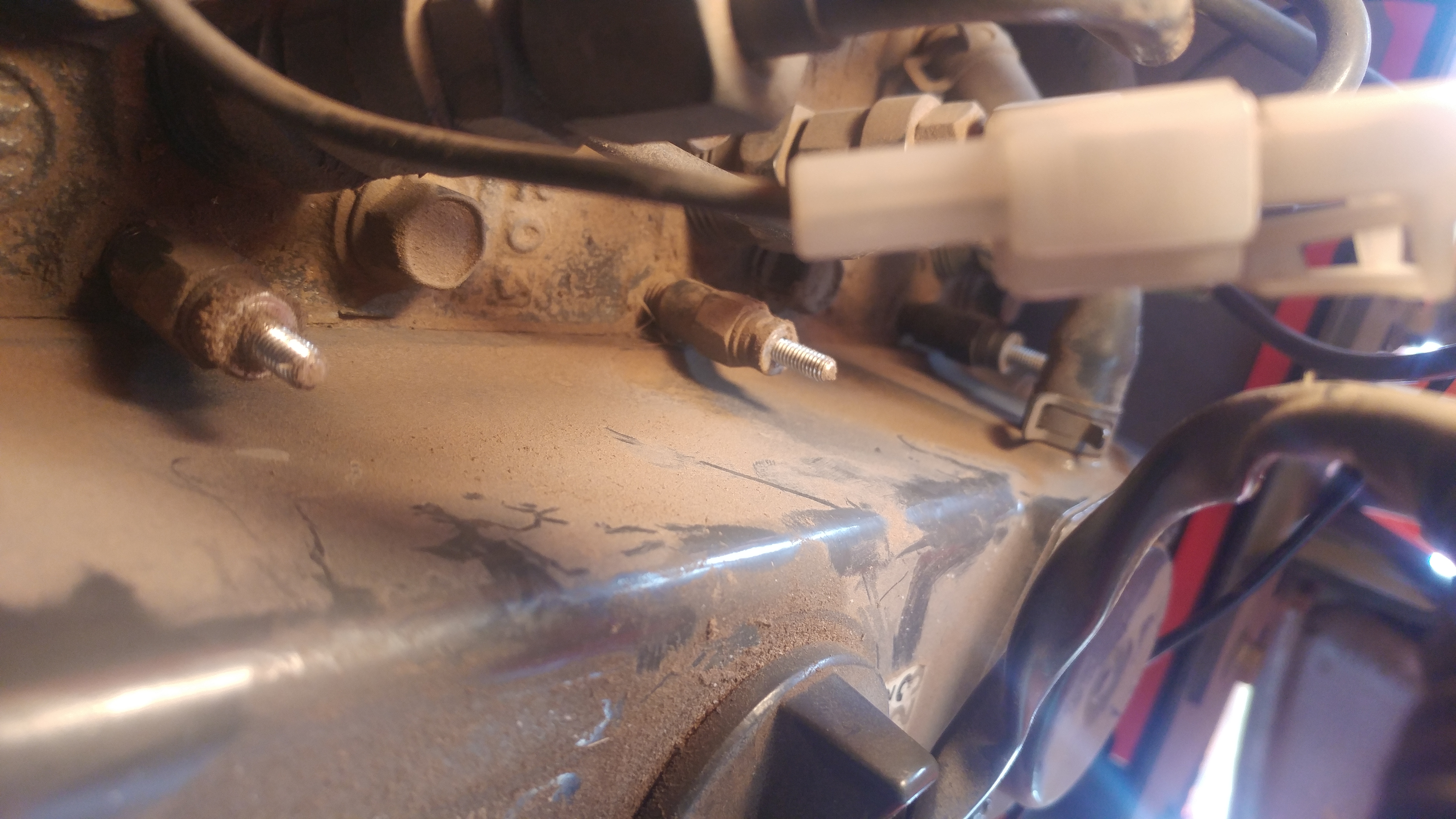

here what glow plugs looks like still in the motor with glow plug rail removed. glow plug in engine with glow rail removed.jpg

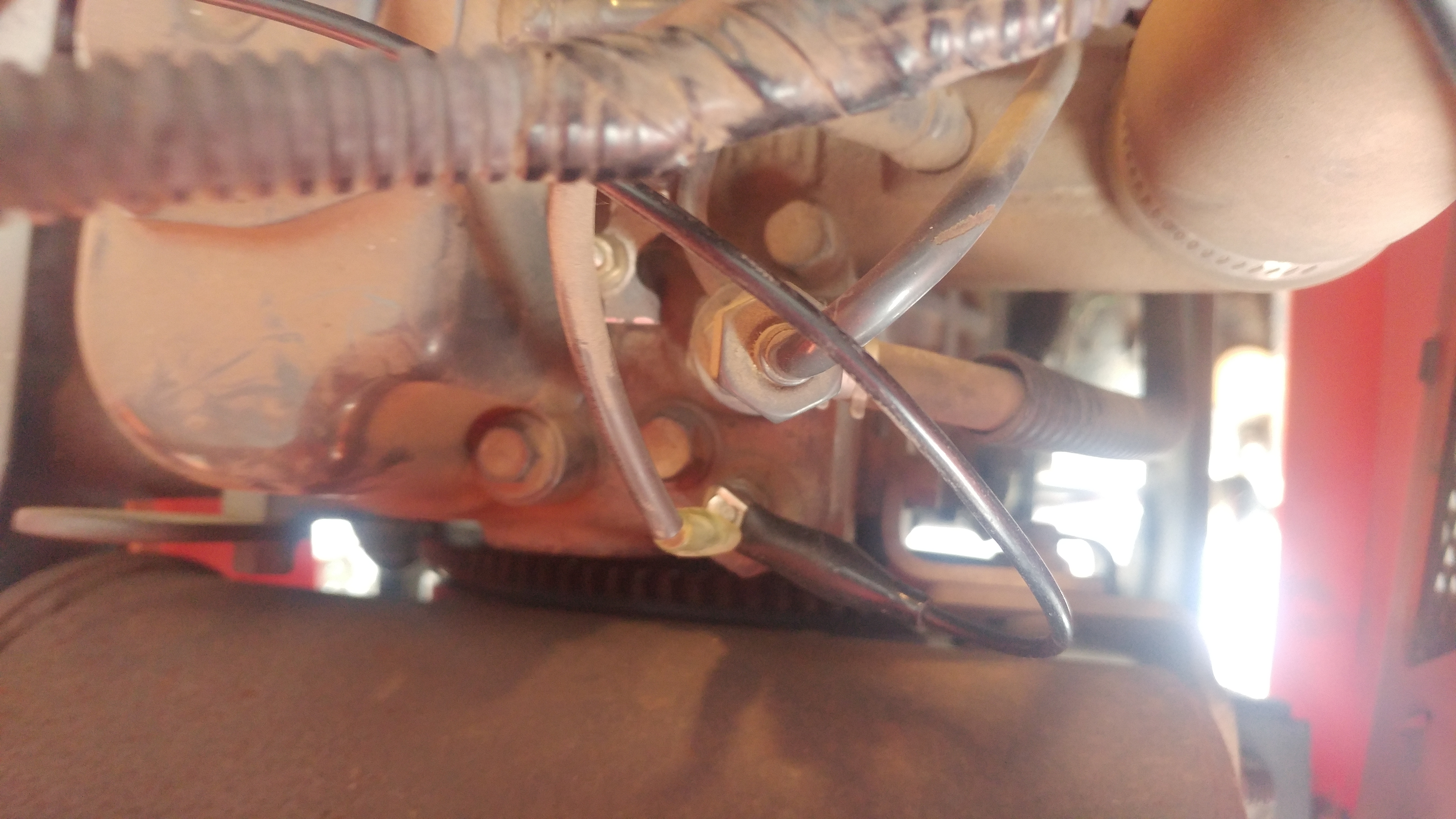

next i removed all 3 glow plugs with 10mm deep socket and small bar extension with 1/4 wrench and tested the resistance and they were all good in the 1.6 to 1.8 range . used red clamp on the top of glow and the negative glow plug resistance.jpg
next i checked the glow voltage from glow wire .. i used the negative leads and clamped on the alternator housing and red on the glow wire and got 12 v in the glow positionfull 12v glow.jpg

You could have checked the GP "operation" by applying 12v to the stud & - to the body threads & watch it glow..
Keep your fingers/hands away from the tip!!!!
They GET WHITE HOT in SECONDS so BE CAREFUL.!!!
