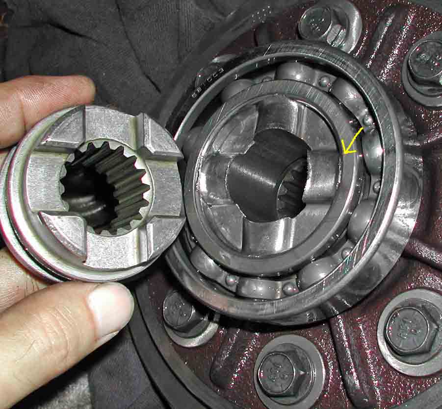

I would like to see a photo of the the failed diff lock and how it is
designed. All the owner's manuals I have read say to engage only
when stationary, BUT I think that a design that has shear-able pins
is a disaster waiting to happen.
I was disappointed in the design on my JD 4300's diff lock, too, but
at least it did not result in big pieces breaking off to be caught
in the gears. It had a hard steel side that engaged with a soft steel
side that wore excessively (photo). Maybe that was intentional....

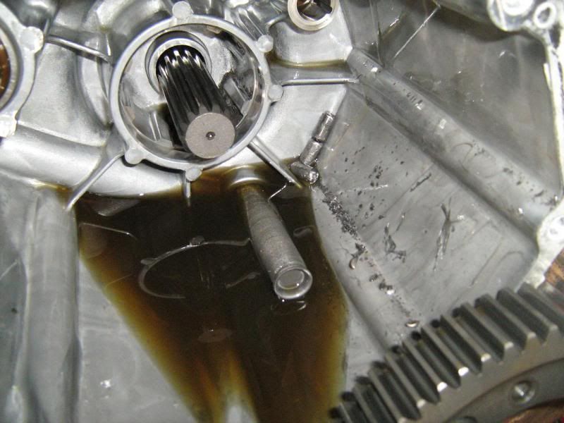

This photo of my BX24 with the pin shear off, I was lucky the case was not damage.
I understand & agree with Carl, that extra internl case clearence would make it a improve design.
The BX is still an amazing machine, but small design improvement is always welcome.
Richard
   / BX24 diff lock disaster ... How many others have had this problem? #29
I see 3 small pins of about 1/4" diameter, maybe 7/8" long. I wonder
why Kubota did not build the diff lock more like their bigger bros (no
pins to shear off).....
While a more robust diff lock (stronger than the pins) would be nice in general, my gripe right now is the way the diff lock pin failure seems doomed to cause a more catastrophic failure. (punching a hole in the case)
