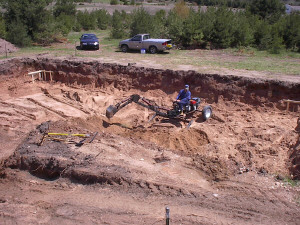

I see you have a weight box, I'm going to have to make one of those. Having the backblade hanging out the back gets in the way sometimes. The basement is dug now. took about three days. The sand turned out to be quite a challenge. Did end up parking the Kubota, once the skidsteer got things tore up enough. to rough to navagate. The kubota has got more guts than I ever thought it would. With the tooth bar on I could out rip the skid steer. The turf tires worked way better then I thought they would. But beach sand is really tough on it. I was sure something was going to break. final thought, alot more machine then it looks. As far as I'm concern it's all the machine I need. does way more than expected. /forums/images/graemlins/smile.gif /forums/images/graemlins/cool.gif

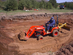

pic of caddigger in the hole. /forums/images/graemlins/smile.gif
