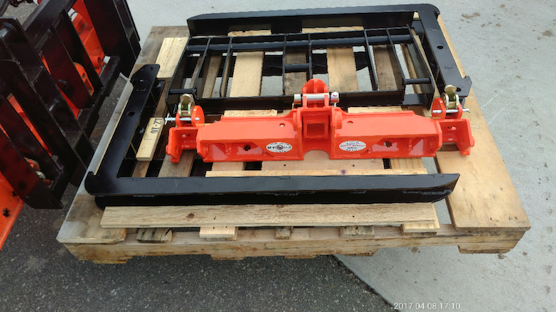

Status... Friday night order... Saturday confirmed. Saturday night pic from Jery. Order ready to ship!
Got to give a :thumbsup: for customer service out of the gate!

I am a little nervous as this was not the cheapest solution and when I look at the pictures of the forks, they look to be open C channel vs. boxed. Wondering whether I will want to stiffen the fork tongs a bit on the underside. Pics might not be doing them justice however. Hope to see them in a week.
