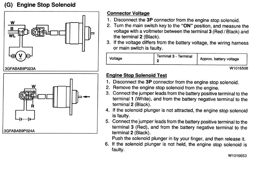

From the BX23 WSM.
Engine will not shut off when main switch is turned off:
1) Fuse blown (20a)
2) Wireing harness disconnected or improperly connected between the main switch AC terminal and engine stop solenoid.
3) Engine stop solenoid defective.
I would make sure everything tests good before I went out and bought a new stop solenoid.
The attachment is the WSM instructions for troubleshooting the stop solenoid.
Good luck

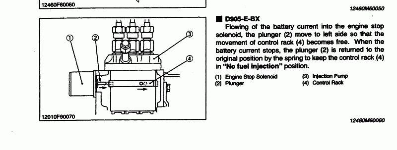

Not on the 905 engine. See attached.
well well well. nice reply. cant say i have ever seen that motor in a BX. i wonder did australia only get the 902. looked at the wsm at work and they only show the energise to stop solinoid system. well you learn something new every day. i sorta think we missed the 905 motor down here, as i have seen absolutley hundereds of these things over the years.
Yeah, sorry my answer was pretty short. Didn't mean to sound unfriendly. The BX 2200 and BX 22 here in the States got the 905. Somewhere in the middle of the model BX 2230 and BX23 they switched to the 902 but I don't recall which tractors got which engines. I remember some discussion at the time about the differences but the different stop solonoid set up never came up. I guess it wouldn't be that uncommon for you folks there to get different versions than us. Works that way with a lot of cars, too.
