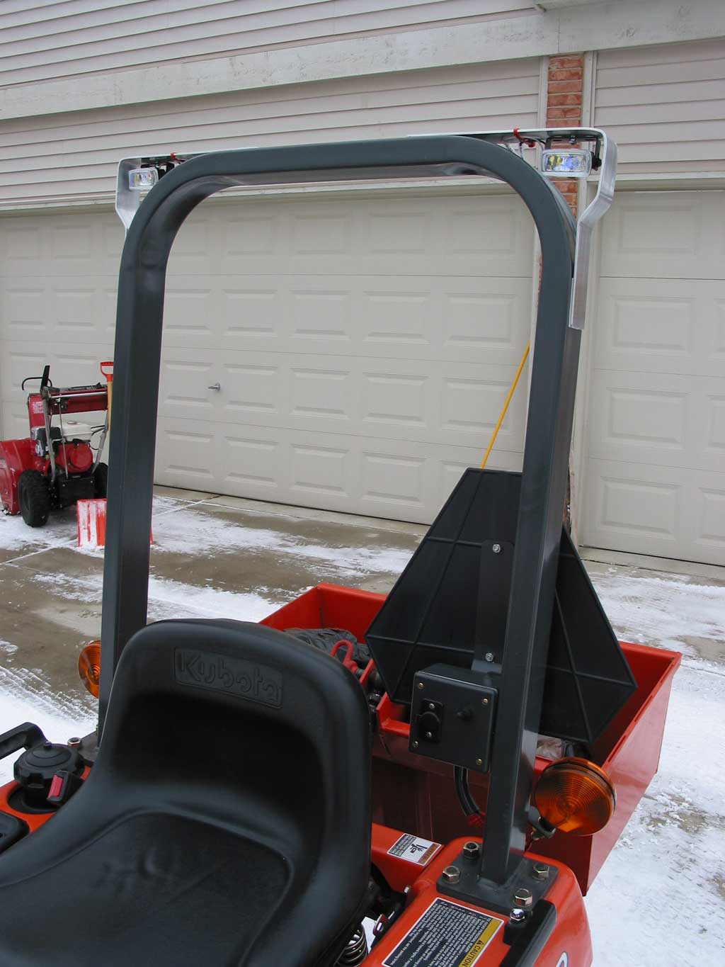

Wasn't going to add lights and then I was out moving snow and couldn't stand the lights bouncing off the loader so...

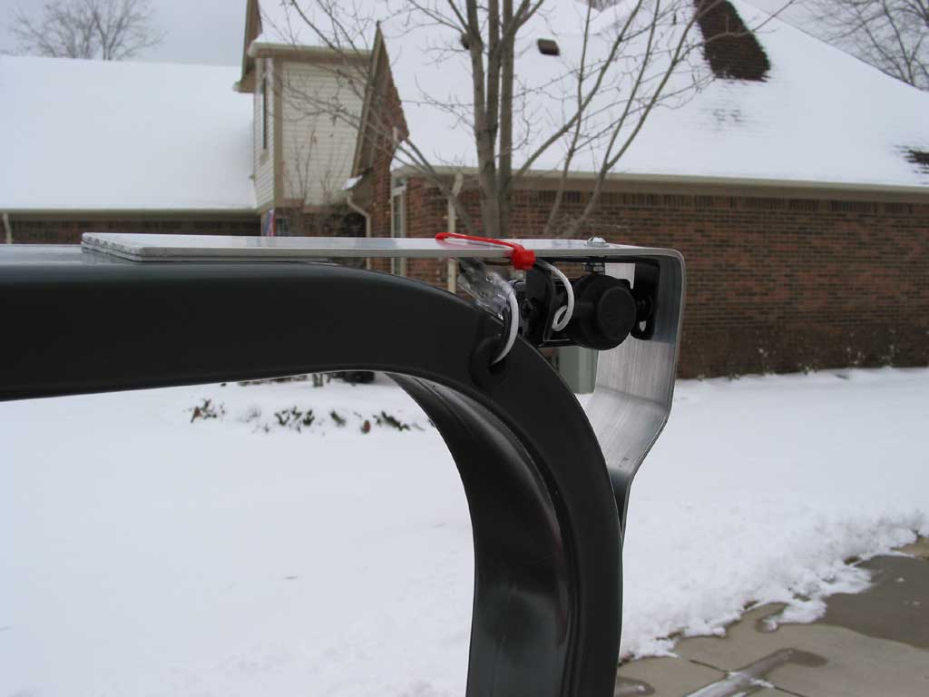

another of lights they are pilot amber fog lights not a large pattern but I didn't want lights over the rops so off to the sides they went

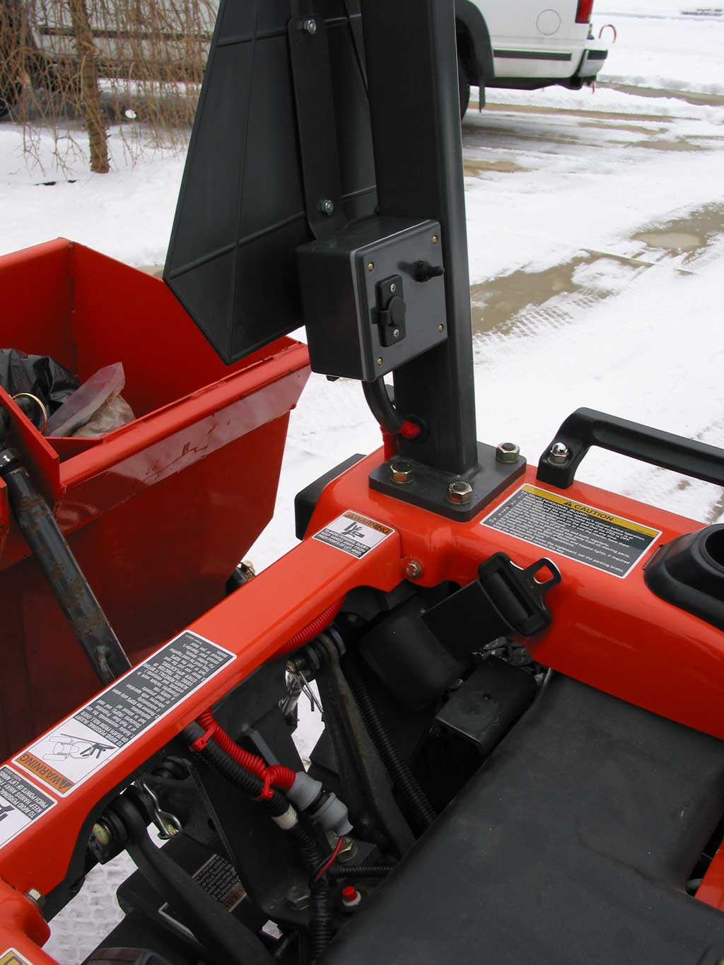

could figure out what to do for a switch housing so.. Home Depot gets a visit

rear of lights

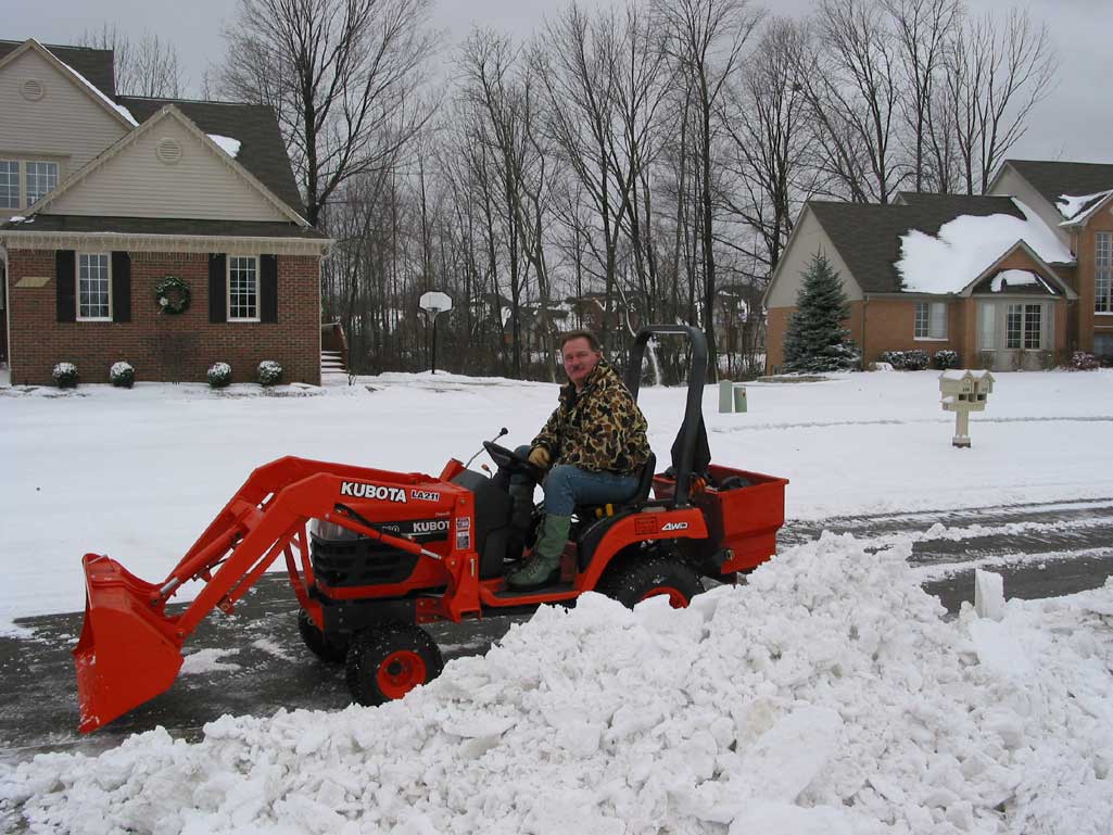

before the lights, couldn't put them inside the rops my big noggen would block out more than the loader...normally the bx is at the cottage but kinda wanted to play in the snow more!!

I just purchased a BX2200 and I am thinking about adding lights. I like you setup.
Where did you get the lights and brackets? I suspect you made the brackets.
What size of lights did you use? Where did you buy them?
Where did you connect them into the electrical system?
Where did you mount the switch?
Thanks
John

tony,
The lights look great, kind of like the set I looked at, at walmart.
Tell us more about the brakets that you mounted the lights in. They look Fantastic !!!!!
What are they made of ? did you make them and how ?
and how did you attach them to the roll bar ?
   / bx 2200 lights added
Bought the lights from Autozone they are 55 watt lights kind of a flat projection but good for me. bent the braket out of aluminium stock (TSC), switch water resistant(TSC), trailer plug and marine 12volt plug from Boat US and The Home Depot for the nifty box to put it in painted ROPS grey (could I leave it the light grey nooo just had to paint it must have to much time on my hands)
