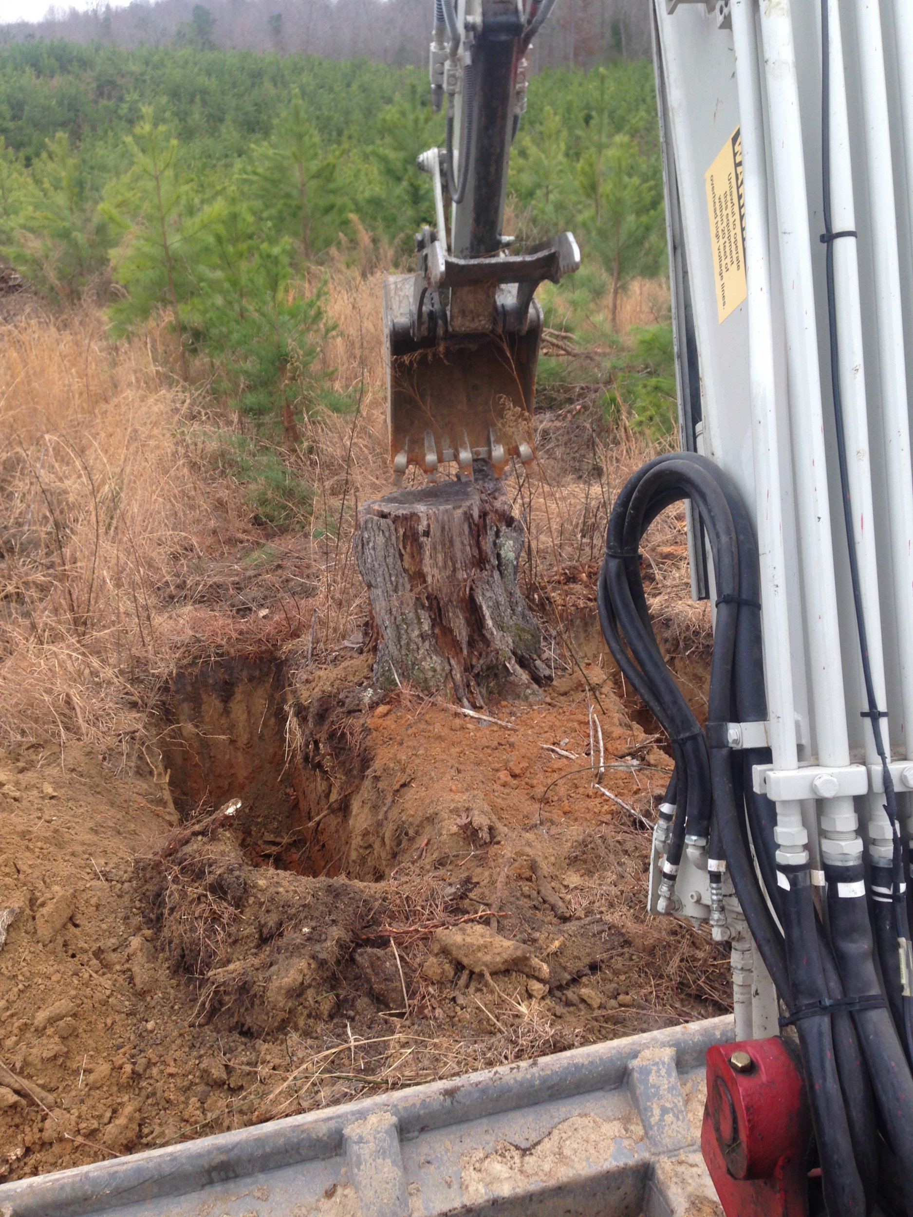

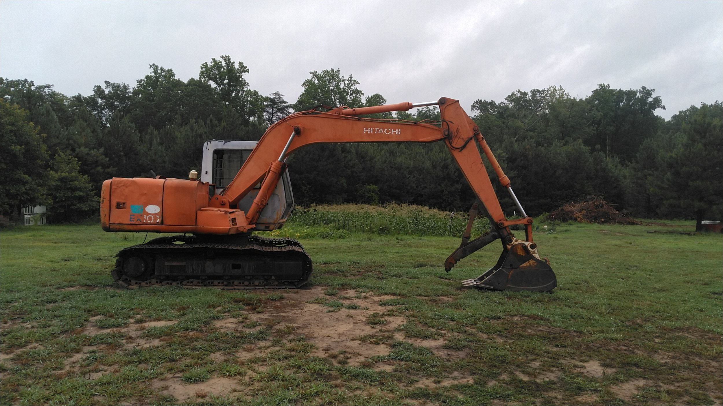

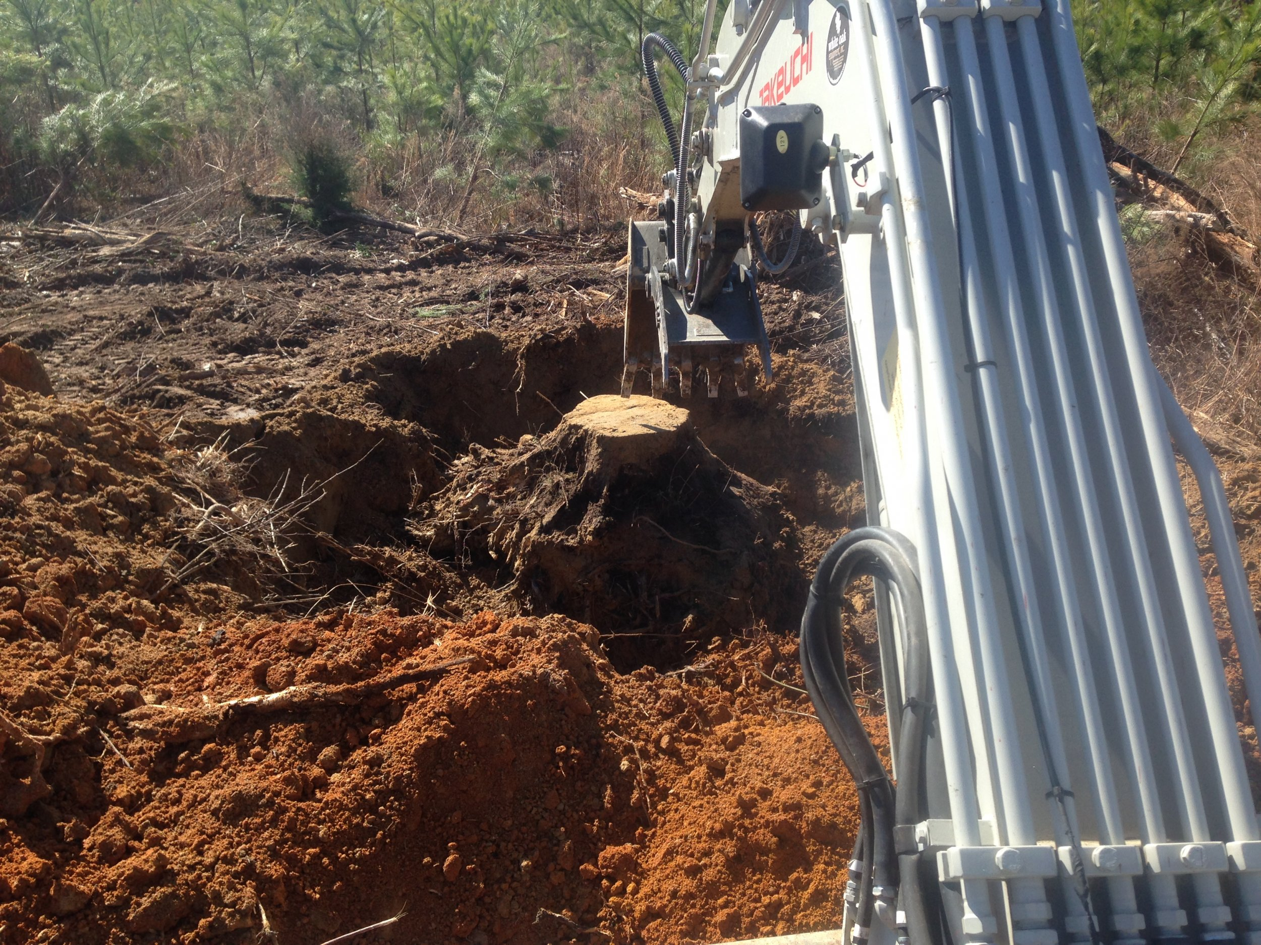

I agree that a compact with backhoe can dig out a little pond over time and lots of hours of work. However, I am never going to recommend someone spend 8 grand or whatever it costs on a little tractor back-hoe that is NOT designed for heavy duty construction. Around here in Virginia where I live, I could not imagine digging a pond out with a little tractor. The OP is ready to spend $27,000 to use a little tractor/backhoe for digging out this pond. Excavator rental for two weeks with fuel and delivery is probably $4,000. I have dug out 1 to 2 foot stumps by shovel, pick-ax and pulling out with a 40 hp tractor. Back breaking work and after a couple, I rented a mini-ex:
A friend of mine built a small pond on his farm for his cattle. He had a guy there with a dozer and excavator. It took them several weeks to get it done. I could not imagine trying to do what they did with a 25 HP tractor designed to move mulch and till a small garden. I have waited years and been looking for years for an excavator. I finally found it. Got $ 5,000 invested in to date. Machine has 5700 hours on it and digs like a champ.
If you want a small TLB, go get it and enjoy it. It will be a great machine and provide years of service for your property. My opinion though, and it might not be worth much, is get the RIGHT tool for the RIGHT job. A little TLB is not the right tool for earth removal. You can use a shovel, pick-ax and wheelbarrow to dig it if wanted. Will be a lot less expensive and like others have stated, if you have the time and stamina it will get done. I am just trying to be realistic about what you are trying to do based on what you have posted.
