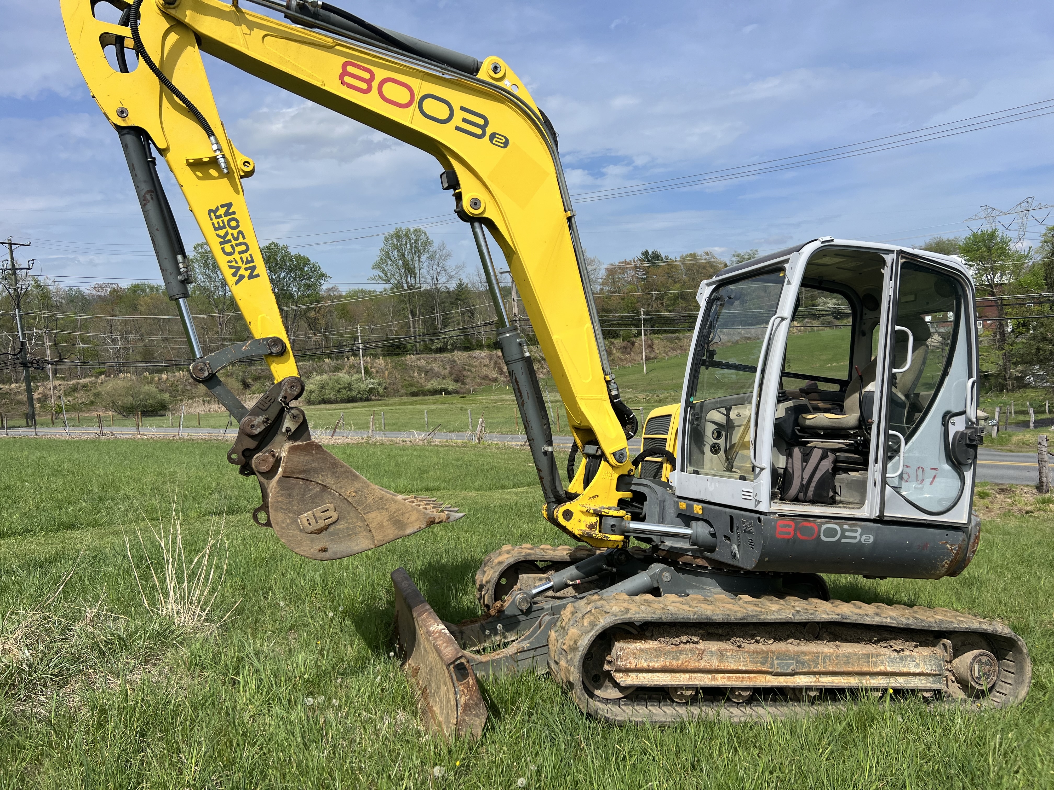

I just bought a Wacker Neuson 9 ton machine with 2700 hours for 28K. I wanted a Tak, Kubota, etc., but after 6 months of looking, I couldn’t find one that suited me. Steadily building up a fall/winter work load for it after farming slows down.
Can’t wait to get going with it and make some money.
