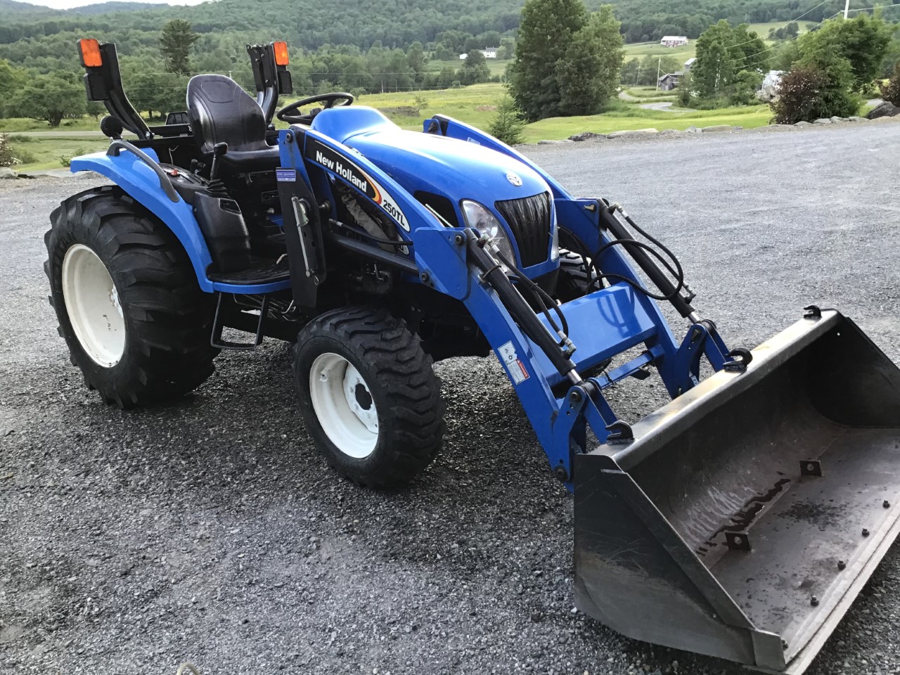

I know this is short notice but if there any suggestions on things to look for in my pre-purchase 'once over' I'd appreciate your $.02... The Tractor looks 'mint' with just under 600 hr's. Primarily I would like to tease out any transmission / cruise control issues (its a hydro) & I have NO experience with hydro tractors; all my tractors to date are / have been manual. I'm a JD owner & the last 'blue' tractor was a 90's 1720 so NH is out of my 'wheel house', so to speak... Tks

I have read of several of that model "split"(broke the casting) I would look for evidence of cracking or repair.

Good advice... Fortunately this tractor seems to be a needle in a haystack find. I'm thrilled to have gotten a 2007 vs the alternative of buying something new; for a host or reasons, lol... I hooked up my 6' Woods finish mower (will try out my 7' mower on it tomorrow) & really came to enjoy the hydrostatic trans for mowing. Not sure that I'd want it for the big heavy stuff that my larger JD tractors do, but in this application I'm really pleased with the Tc40da compact package. It is really kind of nice to be on a smaller tractor for a change & l really like the float on soft ground that these R4 tires provide. It's nice to be on a blue tractor at long last as I sort of grew up 'cutting my teeth' on my trusty Ford 1720... :)
I'll be looking into rear remotes in the near future & have gotten some useful information on making that happen from reading other posts on this website. I have to say that New Holland did a great job on these older TC series tractors & to find one 13 years later that's barely broken in is a blessing!

Do some research . Just put in Tc 40 da problems. Off the top of my head' cracks where the rear fenders are mounted, hydraulic cooler lines above battery swelling, z bar at hydro peddle cracking , turtle rabbit switch on joystick broken.. Don,t want to sound rude but it's all here . Check out Jinmans tc 40 thread . Don't let it scare you great machine just all pittly sh--t but it's good to know . Also read about adding oil slowly. Thats my next tractor I buy:thumbsup: Looks like a beauty I'd buy it.:drink:
