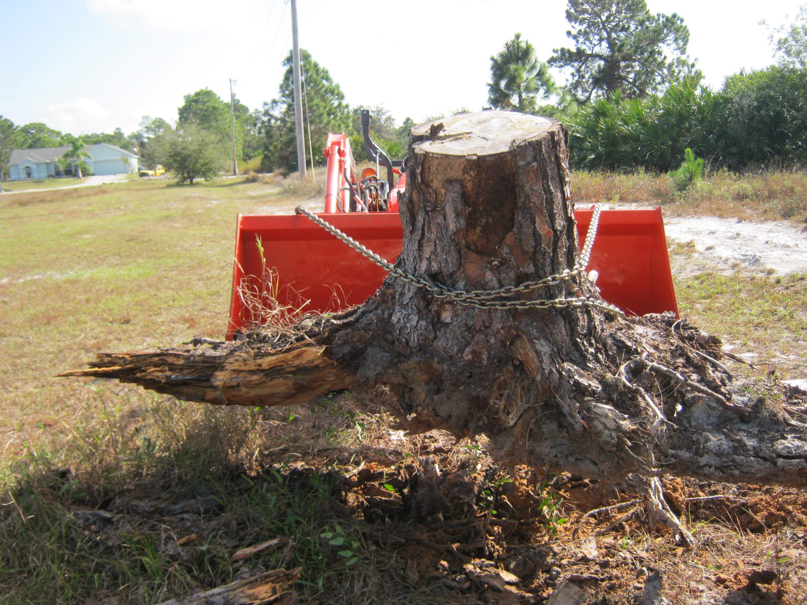

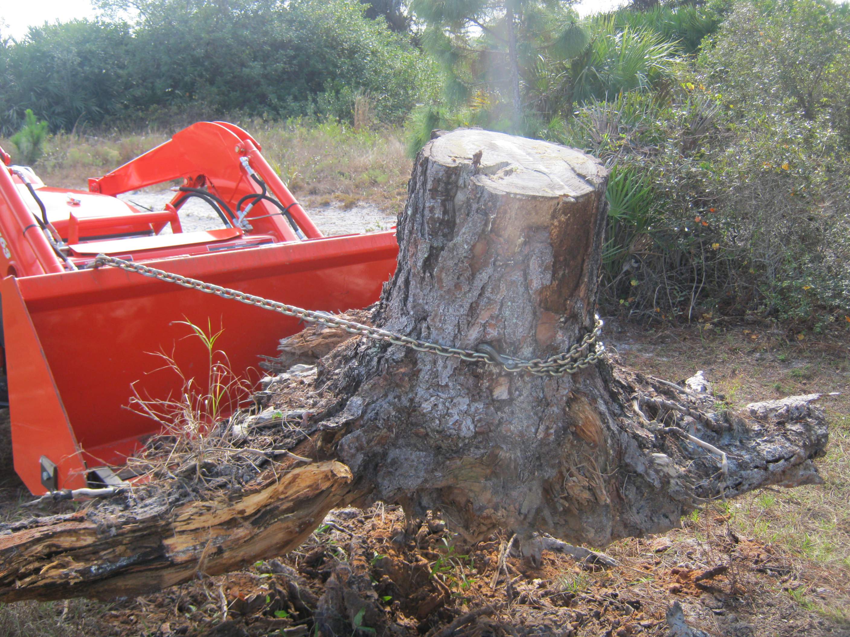

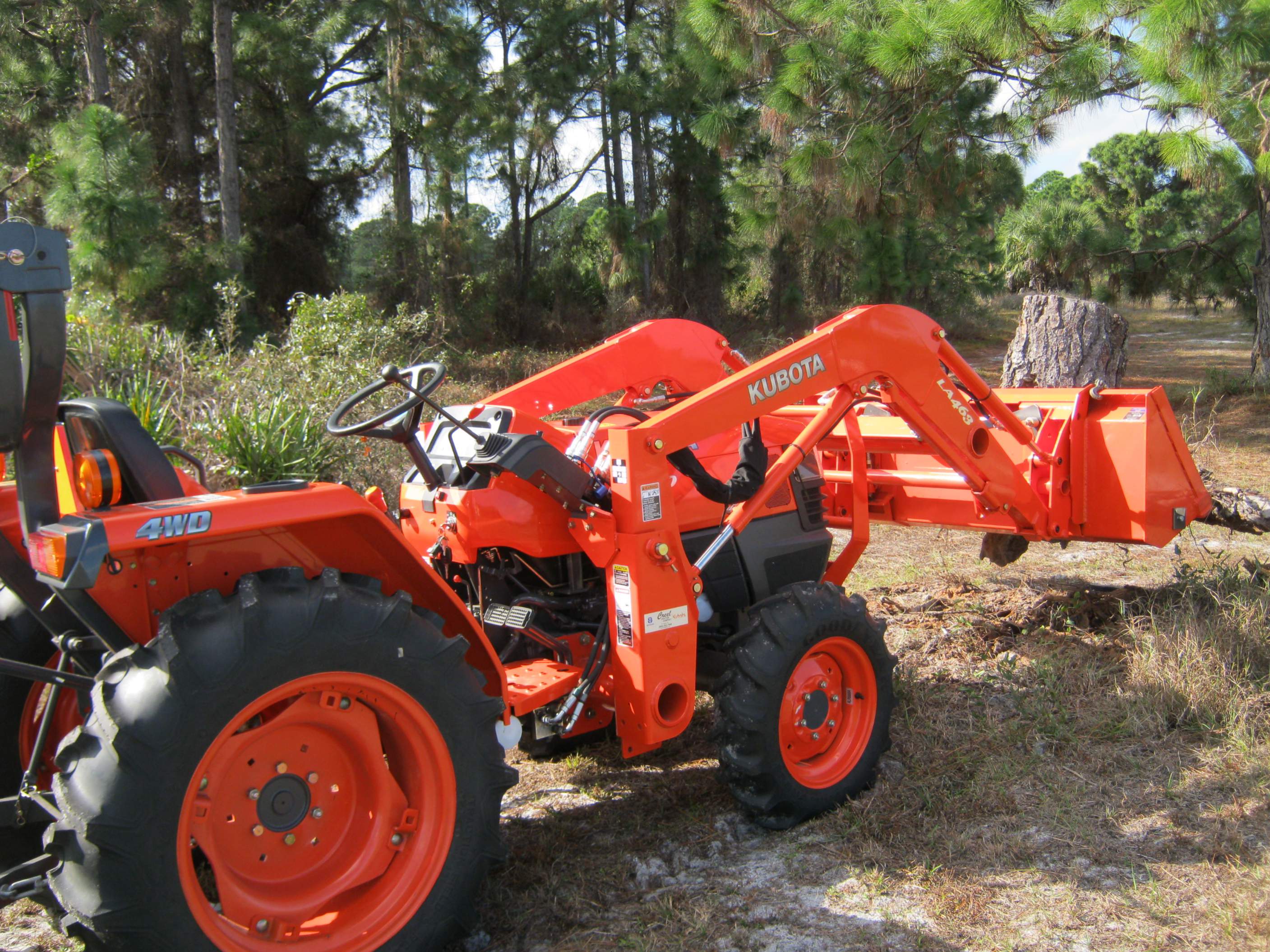

Picked up and moved tree stump I had cut while back. Left it to rot some came today with L3400DT fel w/toothbar. Scooped up and back and chained in case it flipped forward. With extra spec legal bump up my L3400DT (gear) thinks its the mouse that roared. Been real happy with my Bota, this one didn't come with "painters option". Thats where you tie your paint cans that need shaking onto 3 point lift arms to shake paint cans before use. Saves trips to local hardware/HD/Lowes etc. :)
