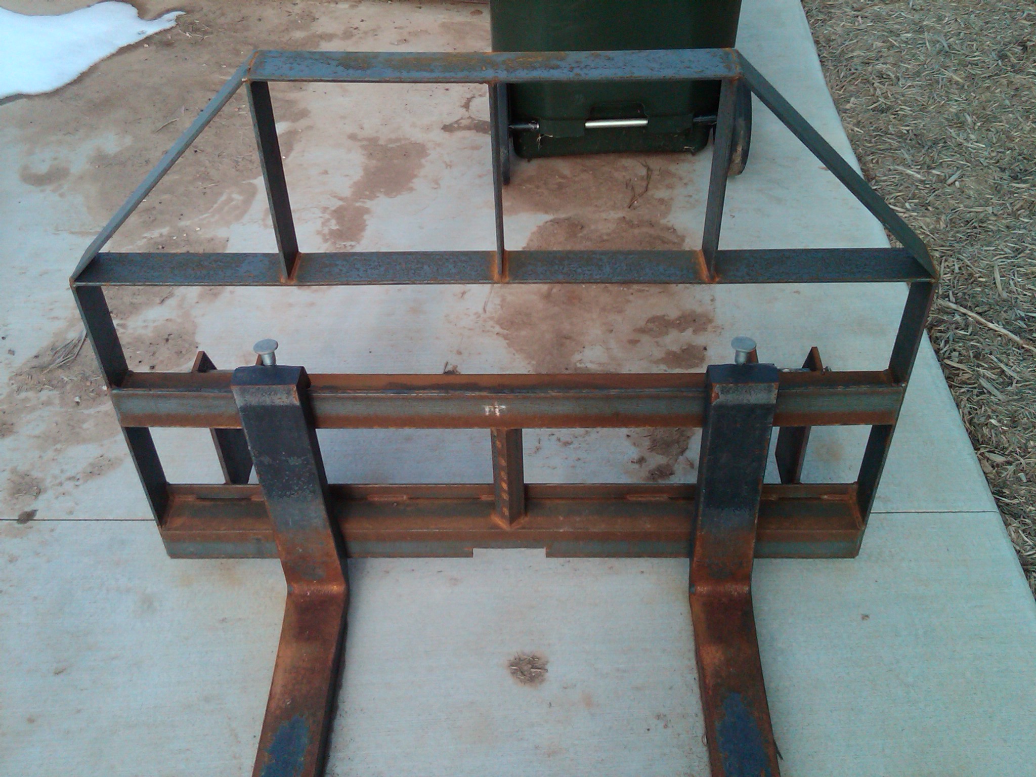

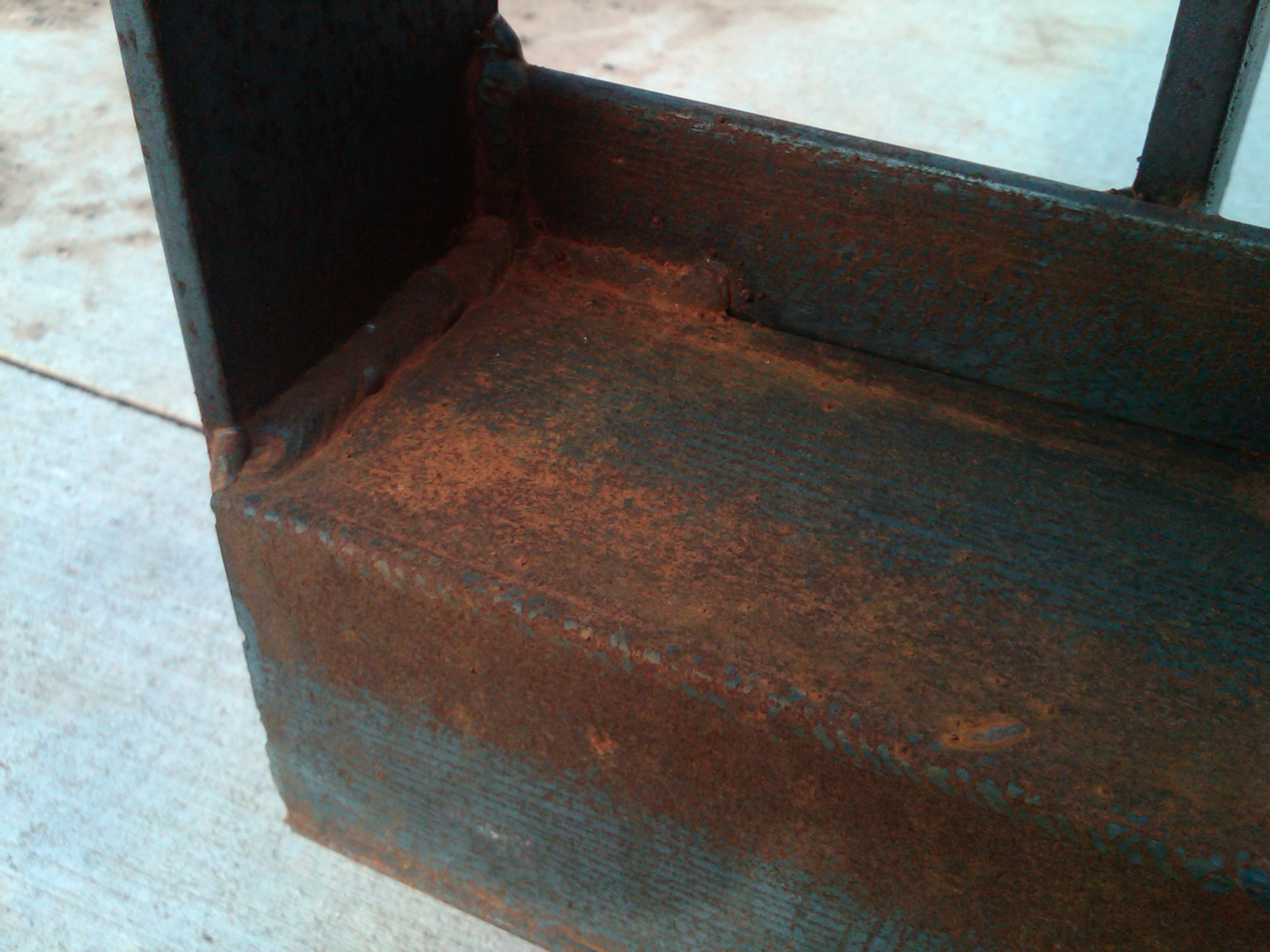

I'll put a few pics of the build I did late last Fall just as the temperature dropped away, before I could get the paint on. I used paired 3-1/2 x 1/4 angle for the frame members, stitched together to form an offset box. The attachment plates were from 3/8 plate. It's setup for quick attach pin style coupling for Massey Ferguson. The biggest obstacle is finding forks. I ran across some 48" forks on craigslist and that launched the project.

I also just bought a pair off of craigslist 48" way overbuilt for my loader cap. but $150.
a local dealer had used OEM JD pin type forks for my loader for $600 ouch. and even though they met my loader's capacity, I am sure I could and would have abused them and broke/bent something.
