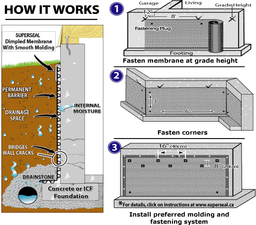

you just need to provide a less resistance channel for water to go to. Just apply dimpled membrane to the walls on outside and then you can backfill with clay. membrane.gif

One way to relieve any water pressure against the walls of your foundation is to use a foundation drainage mat attached to the foundation wall. When I built my house we have clay soils and our neighbors had wet basements so I used it. It is a dimpled heavy plastic barrier that allows any water near the foundation to just drop to the drain at the bottom of the wall. We then just back filled with the subsoil. In 17 years I have had no water in the basement and when it rains the sump pump is doing its job. Just an alternative to the many tons of gravel that others have suggested. Rick
Hmm. Learning something new there. Thanks. And thanks for the illustrations RadioMan.
