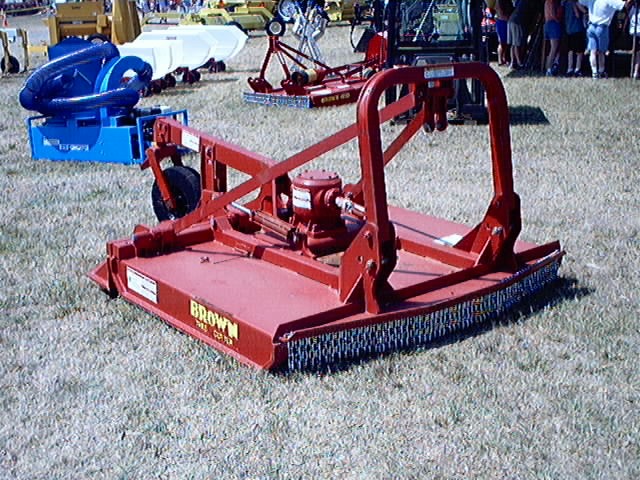

Brown Tree Cutter at Empire Farm Days
This was hefty, but the fit and finish was very crude... right down to the welds...

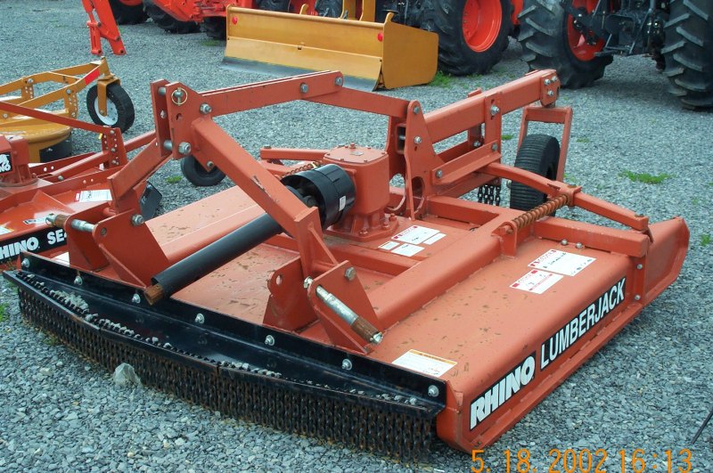

An updated picture of Rhino's Lumberjack...
(correction- Blade holder alone weighs over 600lbs. (not 355))
(see attachment)
Notice the rear of this unit with spring loaded "arms"... you back up to a tree and it "chops" it down... the first picture has hydraulic doors that open up as you back up to the tree.

I looked this unit over at the Louisville Farm Show last feb.. The first thing i noticed was it didn't look like it would cut grass well. I need a cutter that will cut heavy grass too, as i don't want to have a cutter just for trees!! The person in their booth told me i was right, it didn't cut grass very cleanly, it was made for heavy brush, and trees.
I've taken out 4"+ trees with my Woods Cadet 72, and i'm now tradeing for the newly designed Woods Brush Bull!! It's the nicest designed cutter i've ever looked at! It's designed with a top that won't hold water or trash on it!! All so Woods easily has the best blade holders, that allow you to take the blades off with out haveing to buy a giant socket to get them off!! I've never had a problem getting the blades off my Woods cutters!
It comes in three HP size rateings, and several different widths. The HD verson has a 150 HP gear box, but i'm going to buy the med. duty cutter, with a 120 HP gear box rateing!

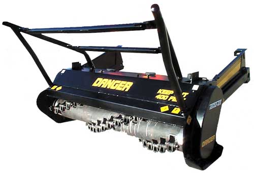

I saw one of these in action. Used mostly for ROW clearing. A real sturdy flail mower!
Will handle up to 10" trees. Ouch!

Another PIX/ the results.
Note the warning on the previous PIX.
"KEEP BACK 400 FT".
