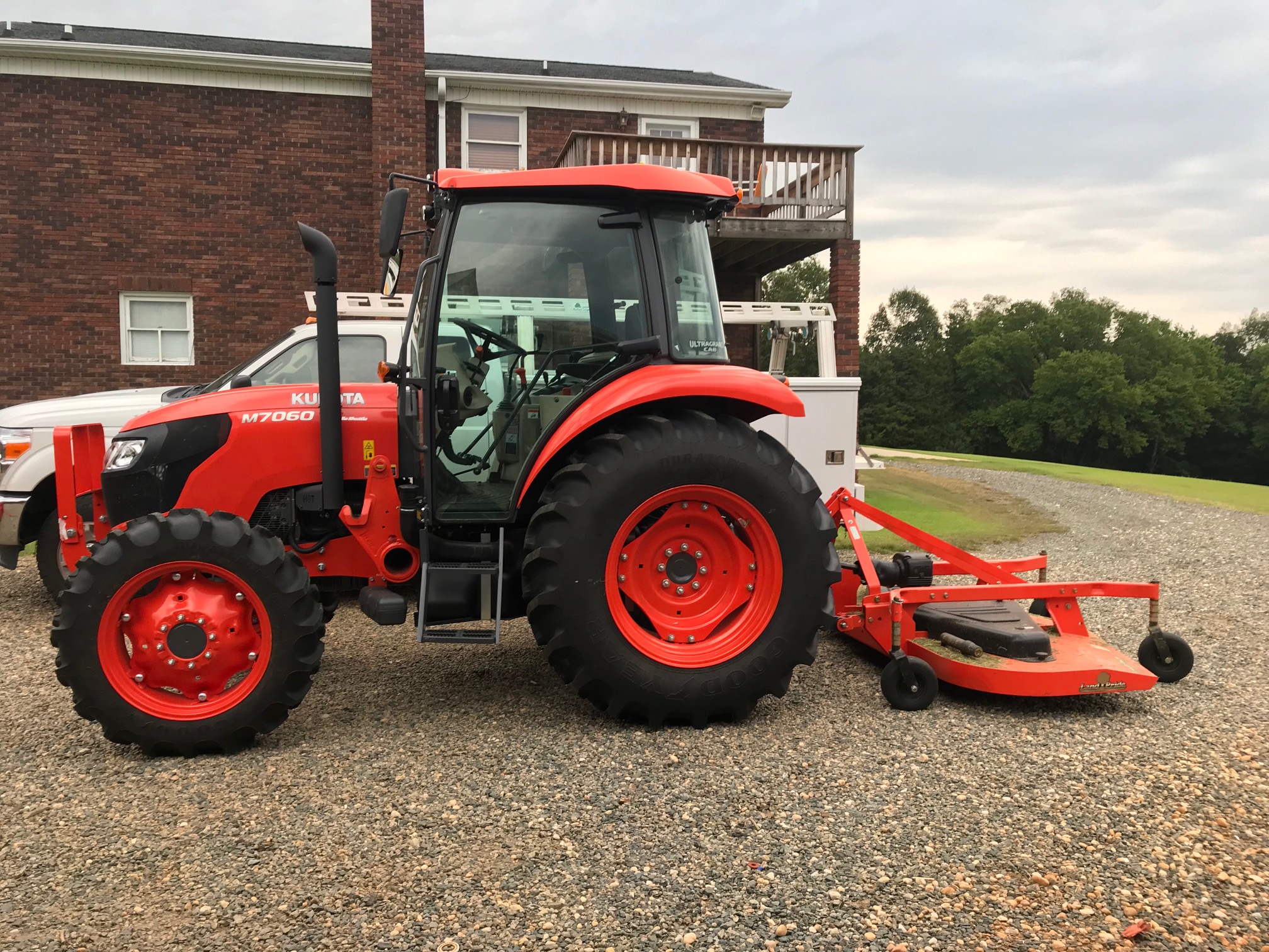

OK , I got my tires filled today and it drives much more "planted" to the ground. I tried to widen the rear wheels, but I was by myself and they were stuck together so I canned that idea. Most of my land is flat. When I am mowing and want to gear down or up, using the clutch and shifting seems to make the tractor jump at pto speed, I tried just knocking the shuttle to n and changing gears and then back to f, any reason I can't do it that way? her the pic I promised

I think hou missed something. They wouldn't be stuck together. Soon as you remove the bolts the rim will try to separate from the center. Now that they are filled this will be a dangerous job. I don't think you should try it.
   / Brought my new M7060 home today , need some advise #18
WHOA - your tires are now filled with some fluid??? Each tire/rim combo will weigh 1000 pounds or more. This is NOT a DIY project. Not unless you have the necessary equipment and experience. Let the dealer do this. I think you might be very lucky that you didn't get hurt, trying it yourself.
Also - how do you change gears - READ YOUR OPERATOR'S MANUAL.

The liquid solved most of not all of the squirrely actions and I grew up dealing with tractor tires full of water and using a fork lift to man handle them around. My rear tires and in the second to furthermost outward and since I live on mainly flat ground and have been driving tractors for 50 years I think I will be fine. Now i still have to figure this shuttle transmission shifting thing out.
