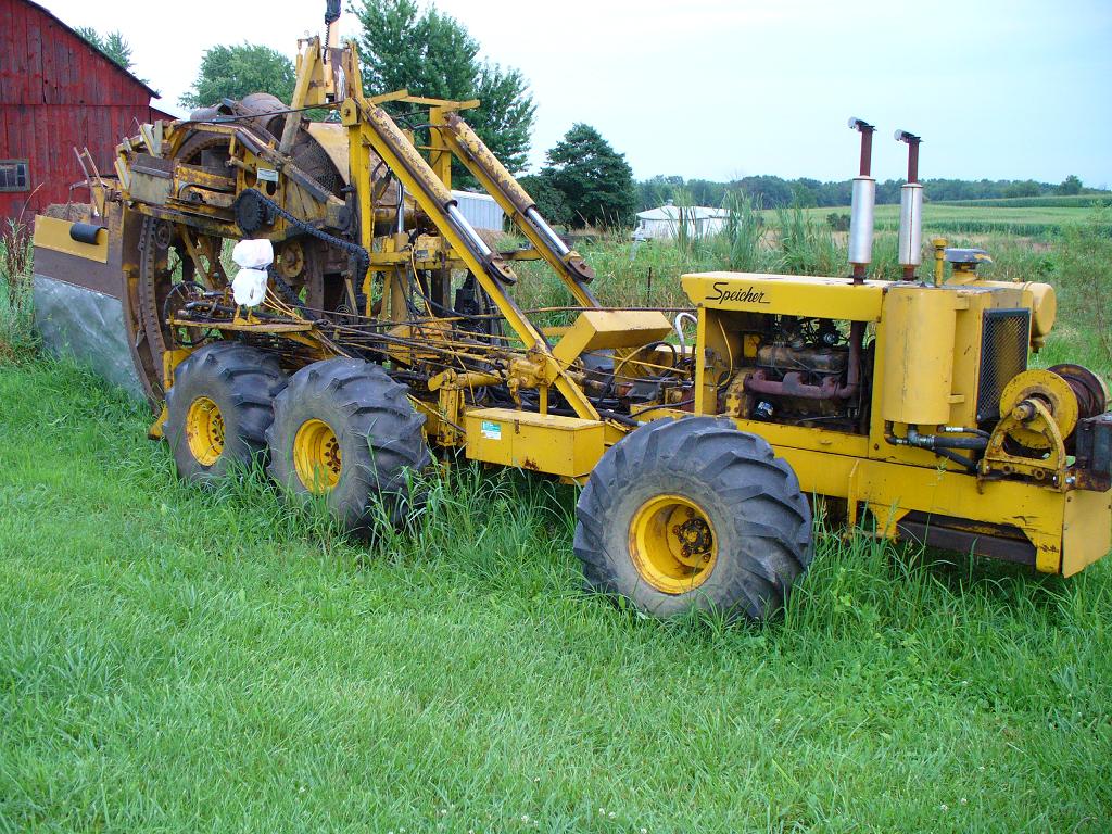

Our neighbor had a late '80s C-IH tractor, about 120hp that suffered a similar fate. It sat broken in the field for months before they fixed it. On the flip side, out at my Uncles farm in IL, we were coming down a back road one evening and there was a huge tiling machine completely blocking the road with a snapped off rear wheel. This was about the biggest tiler I've ever seen, must have had about a 20' dia bucket wheel and used 66" terra tires (it was every bit as big as a Terra-Gator floater.) Anyways, came back the next morning and it was already gone! Not sure if they fixed it right there that night or somehow got it on a big lowboy and hauled it off, but I was amazed they got it out of there so quick.
For those who don't know what a tiling machine is, I've attached a pic of a small one. The one with the snapped axle was more than triple the size of this unit (and only had 4 wheels)
