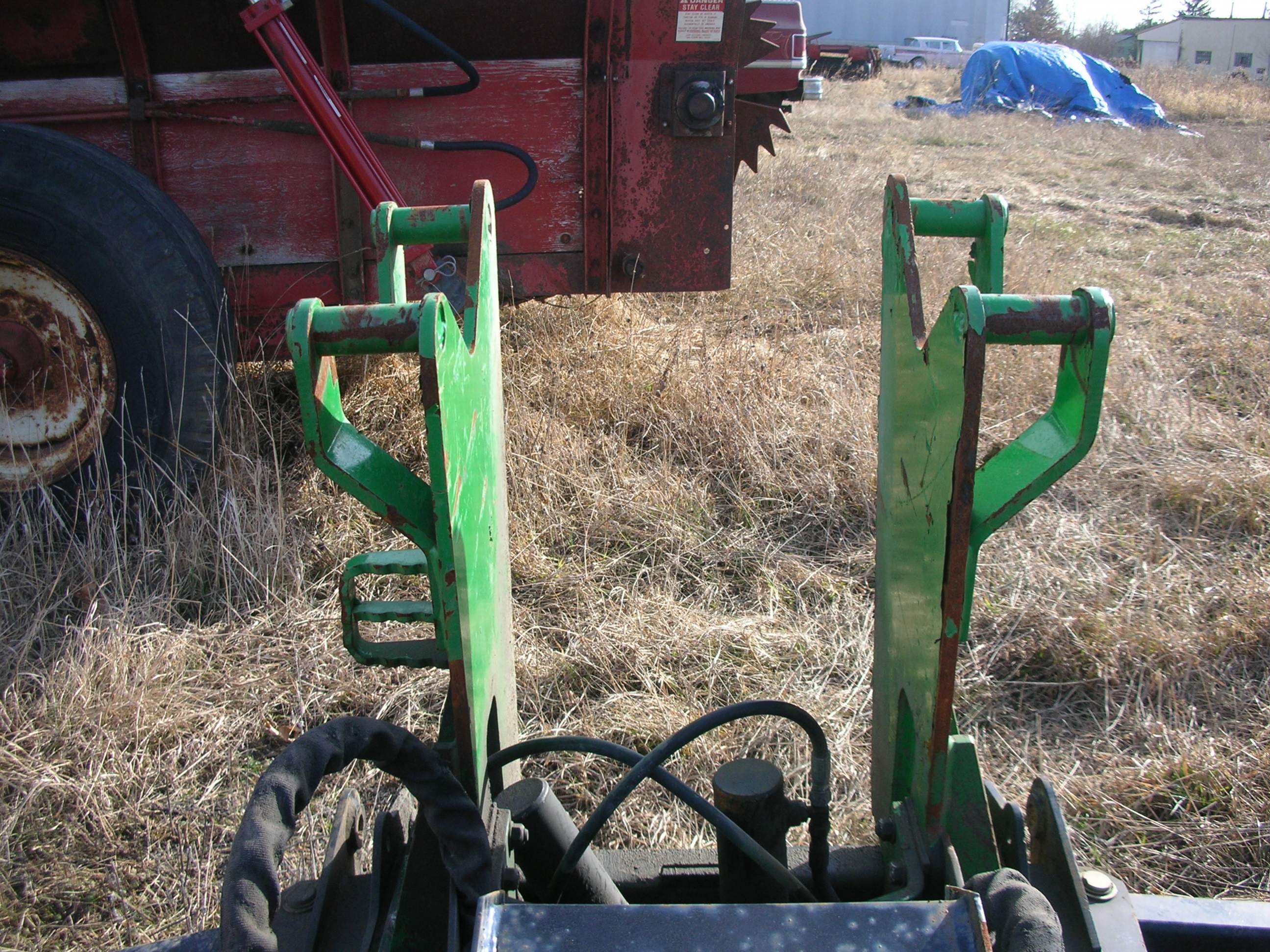

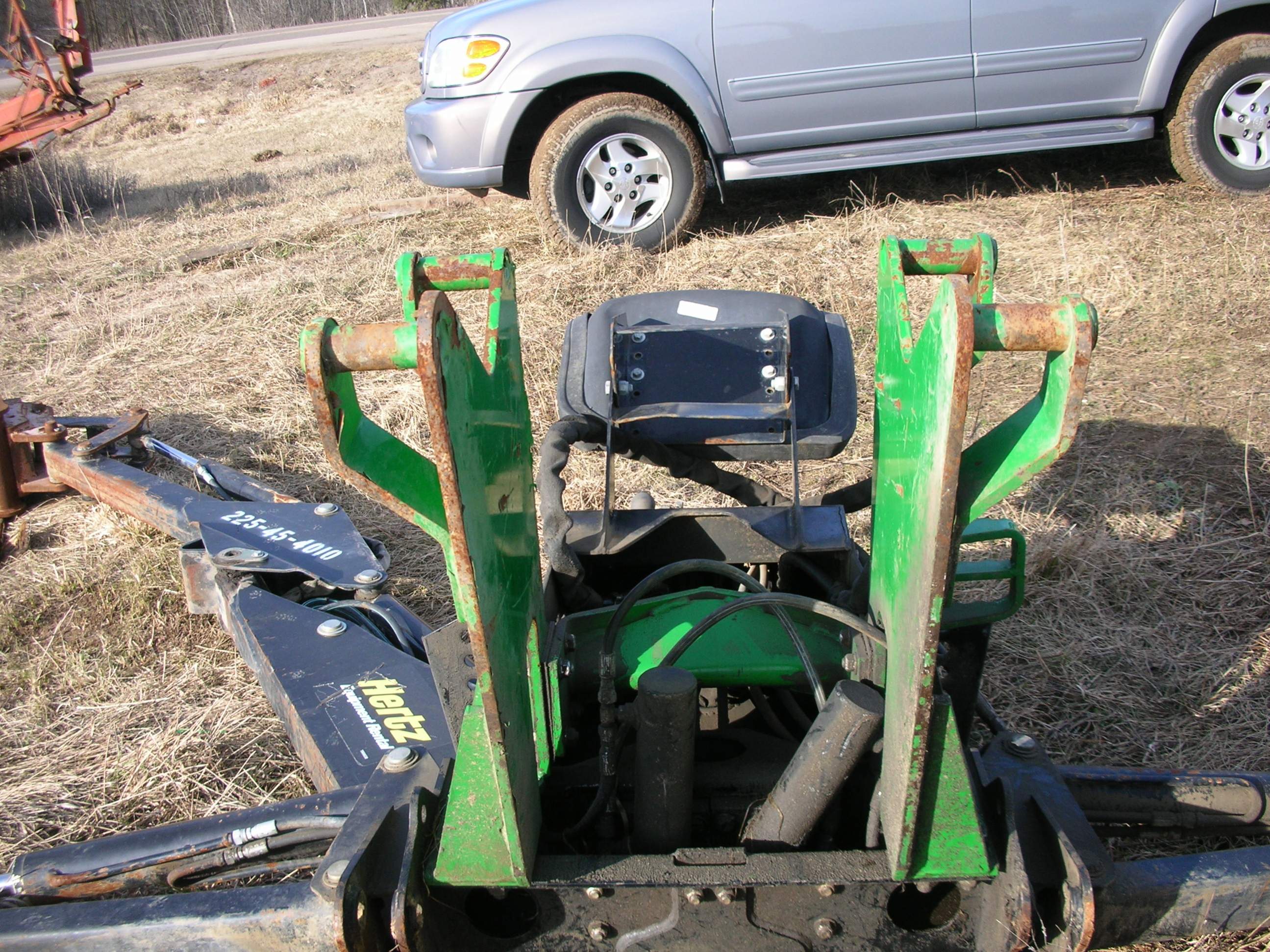

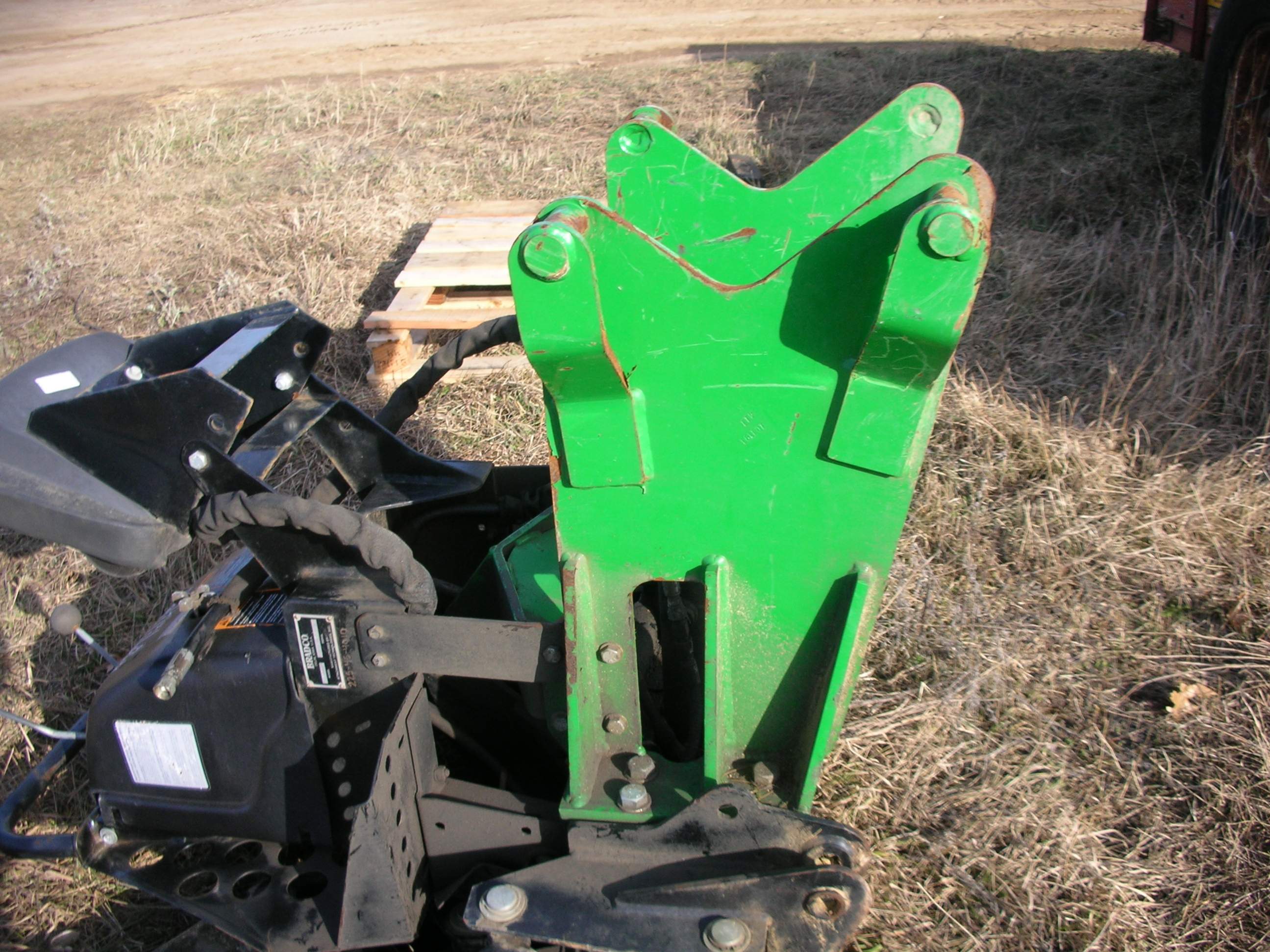

I made it up to the implement dealer today, took some pics of what the mount look like. Any ideas on what it is for, or if it is worth using?
The backhoe is not as clean as I remembered it, but it was in two feet of snow. I am pretty sure we could still back out of the deal if it is not what we thought it would be.
The green part is the hoe side of a 4-point subframe. The tractor side is
not in your pix. It would be valuable to get the other half of the subframe,
or at least find out what kind of tractor it was for, even if it can not be
adapted for your tractor.
Anyway, a fabricator can make a tractor-side subframe to match up to
the four attachment points. Four-point mounts are about the
best type of subframes.

Making a mount for the tractor is exactly what we are thinking would be the best. I am guessing the three point is usually removed from tractor for this?
As for the 4 point, I am guessing that it may be from a deere? but who knows.
I doubt the implement dealer. He said he bought it at an auction, but why would a guy sell a backhoe and not the mount for it, unless it is still on the old tractor.
Eh, more phone calls.
Yeah the green paint says prob a JD. The rest of the frame is prob still
on the tractor (no fun to remove), or rusting in United Rentals' yard. You
might check with the UR yards in your area.
As for the 3-pt hitch, you may be able to leave the arms on, but most likely
need to remove the the stay chains and lift links. The best subframes
do not block the 3-pt hitch when the hoe is off.
I am working on a subframe for a JD as we speak. Happy to help.
