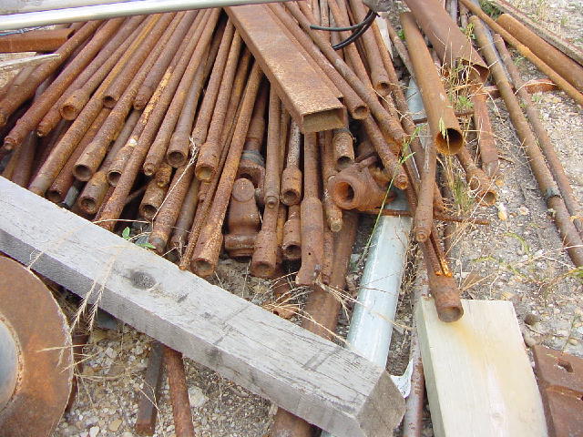

Garland Steel has about five hundred ten foot pieces of bore stem. Randy the manager there over the scrap has quoted me five bucks each for them. There has been the temptation to buy the lot and try to resell them to the owners of Maxi or Mini Sneakers. You see the new stems run over fifty bucks each going through conventional dealers.
But there is a reason these perfectly fine looking pieces of stem are sitting there in the scrap yard. All it would take would be some thousandths off on either the male or female end anddddddd ole harv has some steel toothpicks. Of course it could be just the factory dumping excess inventory but..........don't have enough teeth left as it is and steel toothpicks....
You could rig up your pto boring rig. The question is would it be worth it. If it's for fun and just cause you want to (my most strong motivation) then I say go for it. If you're doing it to save money, I doubt it unless you can get the pieces all free and your time is worth less.
I'll try to take some pictures of the stem and it's componets today at the shop if you like.
   / Boring Unit #7
Here's a picture of the bore stem. You can see the universal joints, the male and female ends, and in there is a three pointed carbide boring tip.
These rods are held together by square shouldered looking staples. Losing one under a drive could be expensive and irritating.
