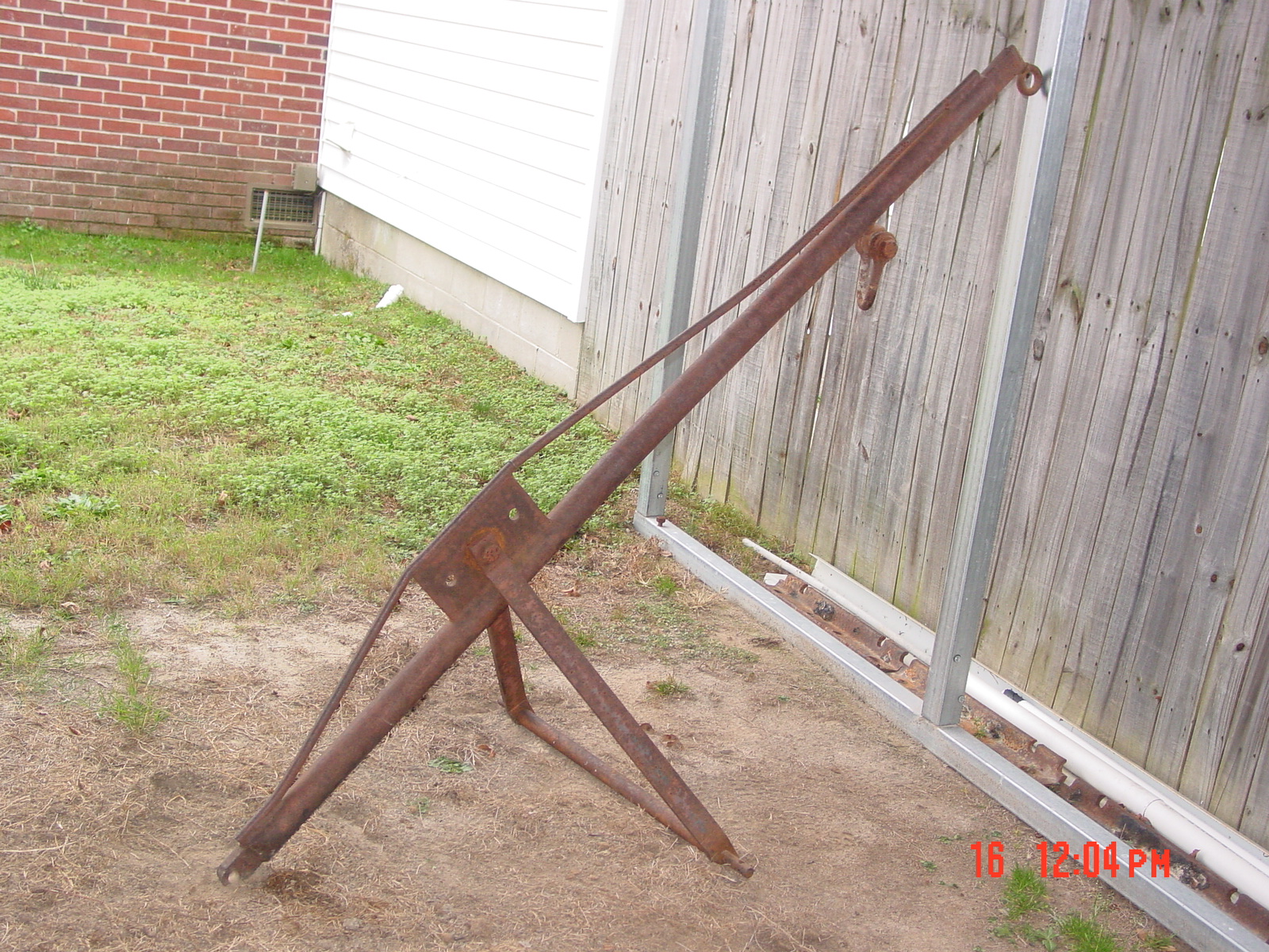

I have two boom poles, one is a hinged homemade design, the other is factory made one piece welded design (no hinge) that most people have and use. Maybe I am blind, but I just don't see any real advantage to having the hinged design, so maybe someone can give the reason(s) if there is an advantage in doing it that way? The only possible advantage I can see, with all things being equal, the hinged design might give you a larger range of motion, or lifting height??

A picture would help, but could it be for compact storage?

I'm certain that the hinged design (part of boom pole replaces the top link) would allow for a greater lift height at the expense of lift capacity.
   / Boom poles - hinged vs not hinged ????? #6
IF the hinged design you are talking about is as Daves3032E describes, where you dont use a top link, rahter the boom itself is hooked straight to the TL bracket on the tractor, then yes, that gives a MUCH greater range of travel, but does reduce the lift capacity. IE: Double the range of motion, half the lift capacity.
The "hinged" method is how most post hole diggers are. For range of travel. The homemade one was probably made out of a old PHD that blew a gearbox or something.
Yep, I think that higher lift is the answer, as I had guessed it. Here's a pic of the homemade one, it was made out of steel pipe and other steel pieces. It will fold flat for compact storage too. :)
