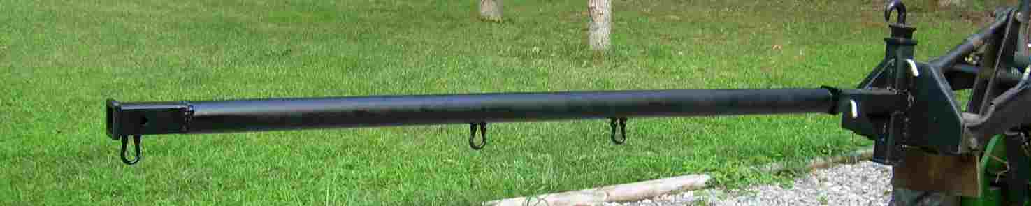

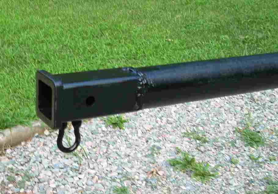

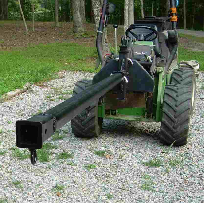

I finished the long boom pole today. It is about 6 feet 6 inches long, if you add that to the 2 inch receiver quick attach plate, it come out to seven feet. Please note that it has a 2 inch receiver male on one end and female on the other. I plan to make a digger/scrapper plate and other attachments that I or others can think of. I have a 3 foot section of the same pipe and will probably make a short boom pole.
I put 250 pounds on the end and the PT422 rear end did not quite come off the ground.

   / Boom Pole on 2 inch Receiver #17
Bob,
That boom pole really turned out great. I must say it is one very large pole.
Now we need pictures of it in action.
PJ

I will be making attachments for it and will be sure to have pictures soon.

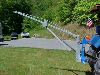

Nice job. I would recommend that you attach a steel support cable to the tip of the boom, and the top of the vertical 2 in receiver. If you happen to pick up a large weight with out it, something is going to bend, or pop a weld or bend your QA plate. I built a similar pole for my tree snipper. You can get more lift by inserting the pole in the top receiver, and using the tilt to raise and lower the pole. I have a picture of one like this one if I can find it.
