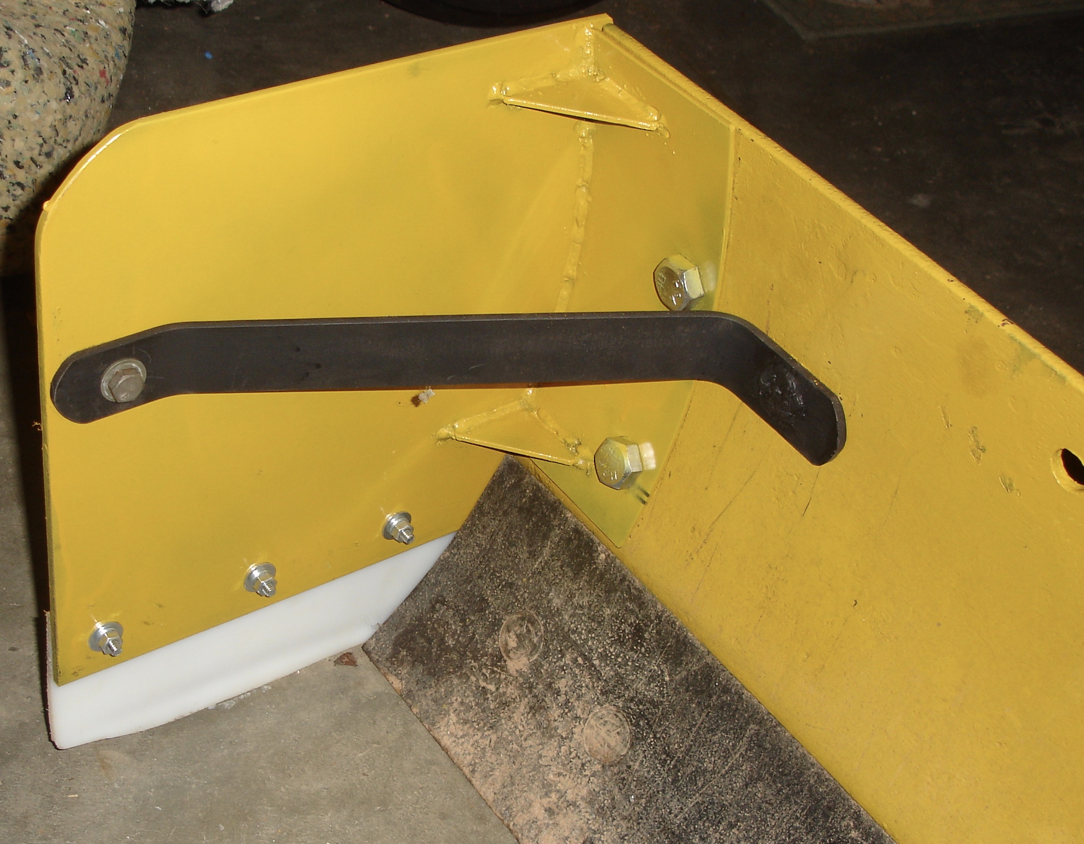

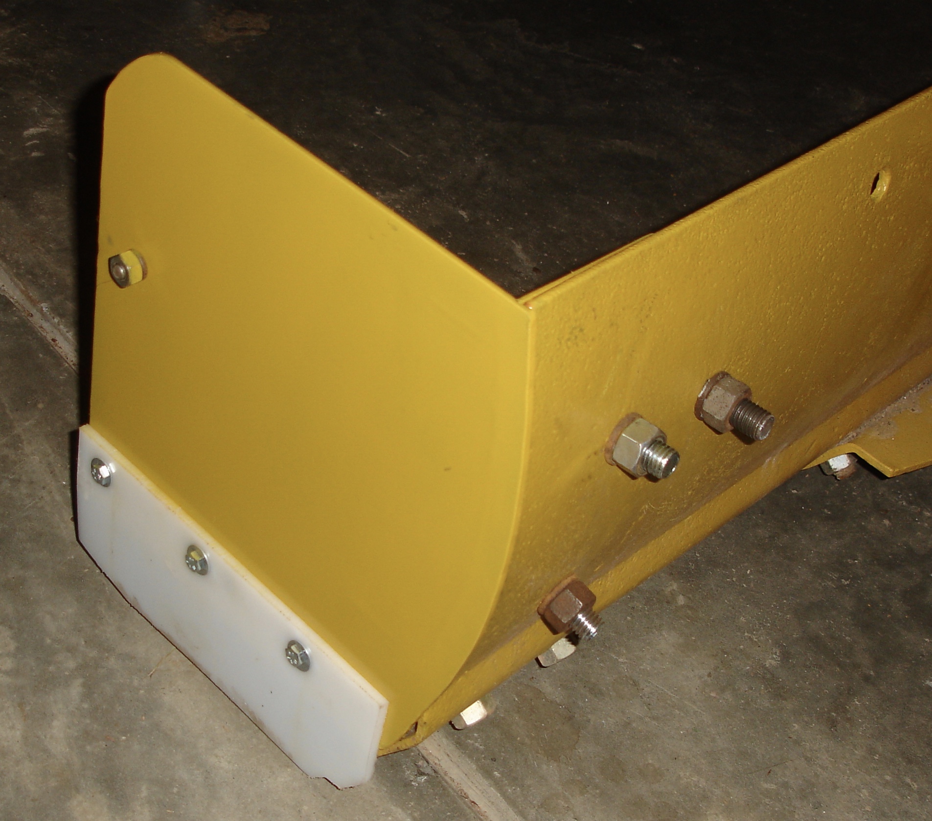

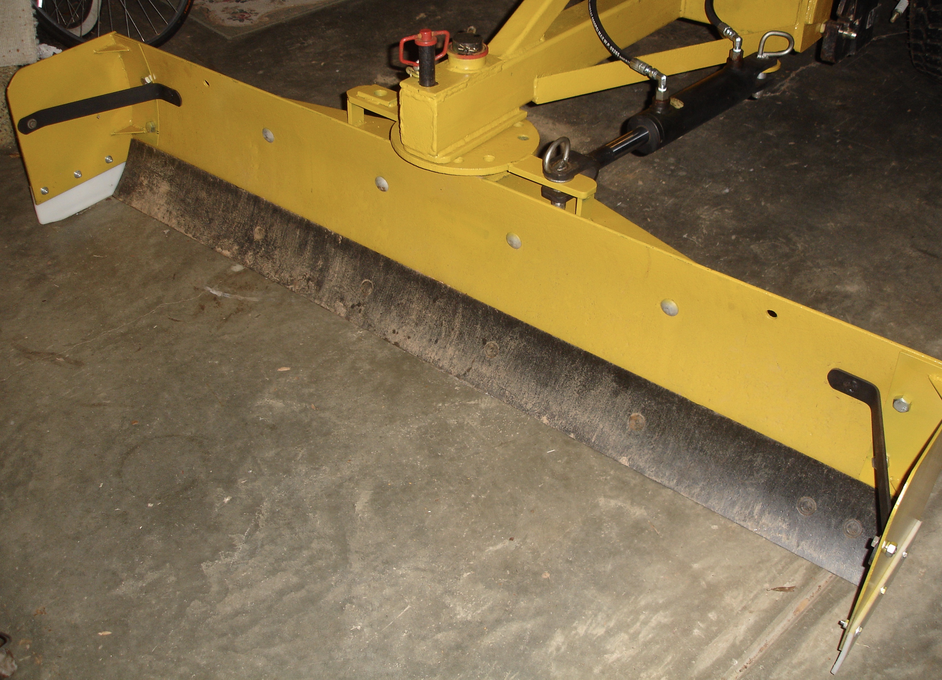

Here are some end plates that I fabricated for a 6 foot wide 3 Point Blade.
Why did I do it? Snow. But it could be used for loose material as well, dirt, woodchips, sand, etc.
1. Had the idea.
2. Had the steel lying around. Only thing I bought was some 5/8" bolts and some 1/4-20s. I truly have less than $10 in this project.
3. Had the time.
4. The moldboard already had some factory 5/8" holes in it. :thumbsup:
The real "why" is because I do as much pushing of snow as I do plowing. I plow the driveway back and forth, but the area in front of the garage, beside the garage and a parking area in the front of the house all get snow pushed off of the pavement into lawn areas. Here in the Mid-Atlantic we can get some heavier wet snow, very messy for the blower, but it still needs to be pushed out of the way.
A dedicated snow pusher would be overkill and a big expense, not to mention adding it to a front mount plow blade and the 3 pt. blower.
When using the front or rear plow for the large rectangular areas, extra passes always have to be made due to spill over, or taking half-passes to keep the snow going where it needs to go.
This scraper blade was a "barn find" on Craigslist, last spring, but luckily it had been under a tarp, and parked on blocks, so it didn't have ground rot like so many old attachments that die slow deaths sinking into dirt for years. It had it's share of rust, got disassembled, wire wheeled, and painted. It also has a nice reversible cutting edge, that had never been turned over. The used edge has plenty of life left and there is a brand new beveled edge when flipped.
I didn't get the blade for this project, but after thinking about it, getting some additional use from it would be nice.
The end plates are 3/16" or thereabouts, maybe it's 10 gauge plate?? The lower white pieces are HDPE, cut out from the top of a car wash barrel. The idea is that the HDPE is sacrificial if it hits an obstruction, then the 3/16" plate steel is next and would bend before the moldboard would deform. I cut a few more HDPE blanks while i was at it, to have on hand for replacement.
Will it work? Will it be more efficient? I think it will be, it will be proven (or be a failure) when we get some plowable snows.
That's the story, for what it's worth.
Thoughts and comments welcomed.

Very nice job! The poly edges on the side plates look perfect for maximum containment. I ordered my LandPride blade with factory side plates that did ok, but are an inch or so off the pavement, and no poly so they spill some snow. It still made dragging turn around areas easier and faster though. I had to remove them when I replaced the steel cutting edge with 1.5” thick poly because of the way they bolt on to the moldboard.
I may revisit the end plates, and put poly or thick rubber on the bottoms after seeing your setup.
   / Bolt On End Plates for a 3 Point Rear Scraper Blade for Snow Pushing
A fellow Marylander! Thanks for the info on your LandPride factory end plates. I looked at a lot of images on-line for inspiration.
I have used black rubber conveyor belt material with good luck on other snow blades. That is what I would have used if I had any scraps lying around.
Another thought, was to cut 1/4" slots in the white HDPE so it could be adjusted up or down, or angled. I'm thinking beyond snow, that maybe for ground work they should be up a little bit.
That may be what LandPride was thinking with their factory ends being up?
   / Bolt On End Plates for a 3 Point Rear Scraper Blade for Snow Pushing #4
I think the LP ends are designed with dirt in mind. They are designed to bolt over the very end of the main cutting edge, and with my poly 1.5” thick edge I would have to either cut about 3” off each side, or cut a slot out of the plates. It would likely be easier to start from scratch and fab some new plates.
Drifting somewhat off topic... what I would REALLY like is a front blade with hydraulically operated side plates like HLA makes for larger tractors. My Kubota isn’t big enough to handle it though :(
