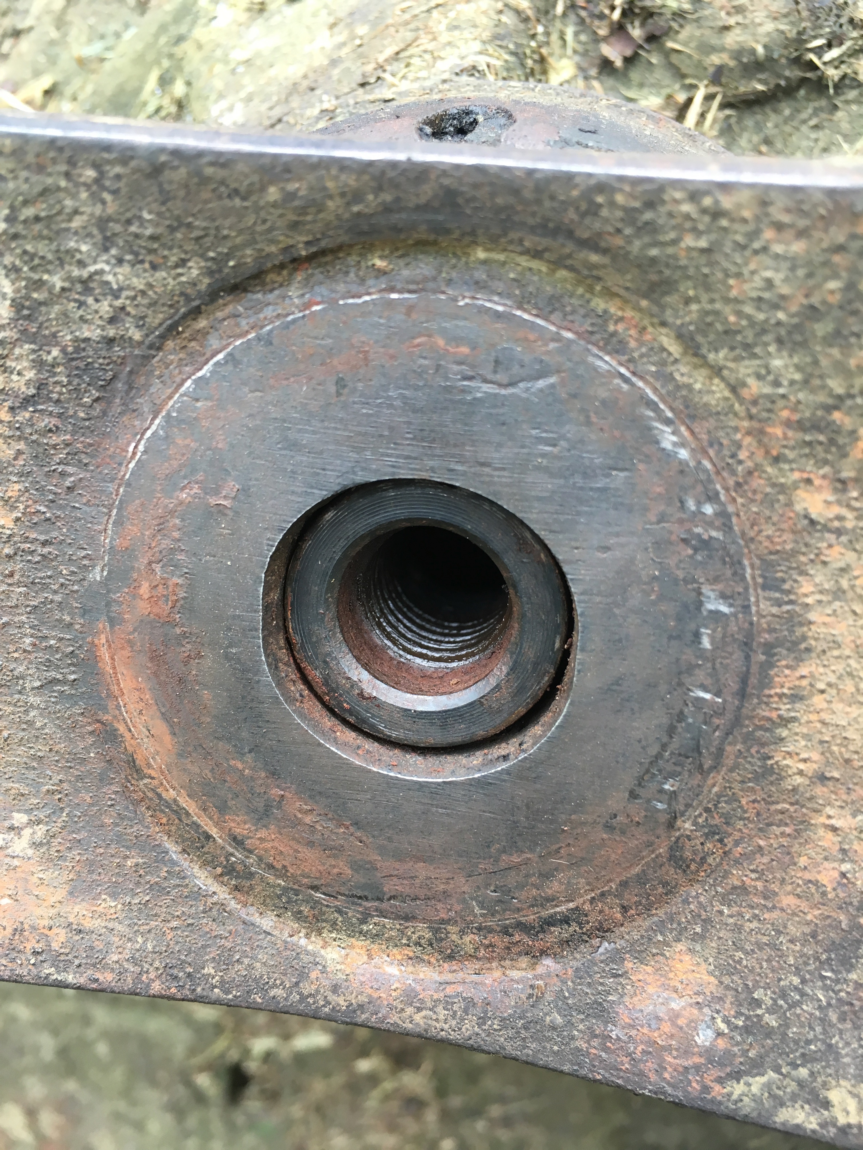

To clarify one detail, these are OEM blades that are original to the deck. They've been taken off and remounted a number of times for sharpening, cleaning and routine maintenance.
Take them off and start over and you should be fine.
The solution to the issue I encountered was as simple as this. The spindle has a shoulder that the blade rests on, as others have said. The bolt simply holds the blade to the shoulder. In the relationship between the hole in the blade and the spindle shoulder, there is maybe 1/8" of slack or "wobble". I took the blades off and put them back on and there was no issue. Then I loosened the two outer blades and pulled them each toward the center blade and tightened them down. When I did this "on purpose", I was able to re-create the issue. So my problem was a product of misaligned variables and just going too fast. I brought the question here because I thought there could be a problem much bigger than that.
Hopefully this thread will help someone in the future. And again thanks everyone for the replies.

Thanks for the update on the issue. Seem weird that there is that much play between the hole in the blade and the shoulder on the spindle. Decks I've had didn't seem to have much play at all and seemed to have 1/4" or so between blades even if I did line them up to meet.
I'd suggest for anyone installing blades to ensure when you put them on that when you spin them by hand they don't meet up. If two end up that way loosen on up and re-clock it. Little insurance for situations like yours.

Thanks everyone for the support and replies, and I'm sorry about my apparent misuse of the forum and poor forum etiquette. This was not my intent. When I created the thread, I thought I had checked the box to receive notification emails when replies were posted. I guess I didn't after all. When I didn't get any emails, I just didn't check back until the weekend. Apologies.
Red color is my doing to highlight just what I complained about (sloppy fit) in my comment #22. And of course a few chimed in right away about having the wrong blades, etc, when I had two sets of O.E.M. blade for my deck. Now you just confirmed the same poor design that I found. :thumbsup:
