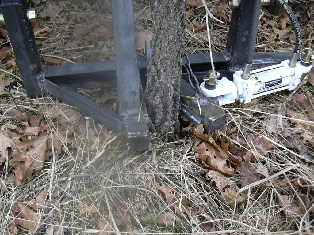

Bob, If you will look, I pulled 3 trees that I took pics of, more that I didn't, and some I couldn't pull. If you will look at the reason for the post, your answer has nothing to do with it.
Casey, Please explain how to do the narrowest part of the V where most <2" trees will go. If your refering to something like a dremmel tool, can you imagine trying to hit 3/4" plate with it. A 4.5" angle grinder will hardly show any progress on 3/4" plate after 10 minutes of grinding it. I also mentioned bolting blades on, as in drilling and tapping the steel, and attaching the blades with bolts through them. Sorry I was not more specific.

Mark,
I'd go ahead with bolting an old lawnmower blade to each side. Old leaf springs would be even better.
If they are too hard to drill, temper them into submission then re-harden afterward.
Make up two sets. One beveled and one not. I'll put my money on the non-beveled ones doing a better job as the blades are thin enough to get a bite without sharpening.
Another benefit with the bolt-on edges...you can adjust the angle of the throat by re-positioning the holes in the bolt-ons.

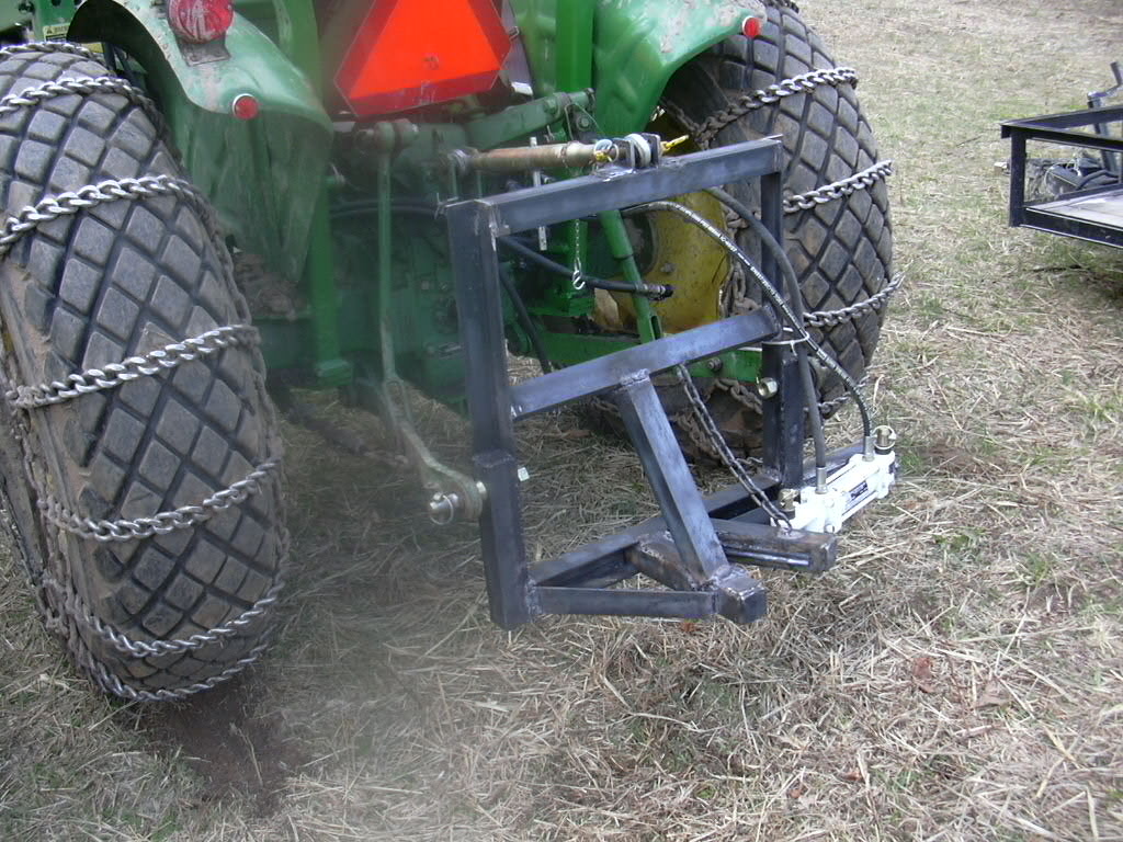

Nice Design you have too! I think all you need now is a few ground and pointed 1/2" x 3/4" x 1" long stock pieces welded on each side. Weld them on at a slight angle upward. This will force them into the tree trunk as you lift the 3pt arms and will let them release as you drop the arms. The thicker stock will prevent them from penetrating like a nail spike but stop the slippage from the bark sliding that annoys us so much. just my 2 cents.

For what it's worth the few companies manufacturing something like this commercially use a beveled edge...

Renze said:
A small hydraulic clamp finger would help better than a sharpened cutting edge.
Here is a unit I built for just that purpose ...

Nice, Another arguement for rear remotes. I wish I could afford some.
