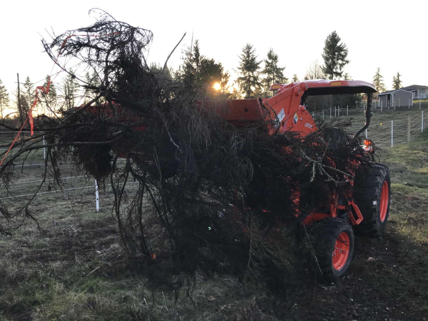

R4 are working well once I got the air pressure set right with the filled tires
They had 25 PSI in the rears so I dropped em to 15 and all is well.
The filled tires and psi to 13-15 and the subsoiler with the 6060 - even with the R4s with it as wet as it is here right now I have to watch my speed while ripping (1 mph or just under) or I can snap the shear bolt on the ripper shank with no warning - don’t ask me how I know about the speed or the shear bolt working as designed ......
LOL
Traction is NOT an issue.
I know the trade offs for ag vs R4 so I operate accordingly when it’s really wet.
I thought the same thing with the single step off the left but now with some hours it’s really not a big deal at all - at least for me - I don’t even notice it.

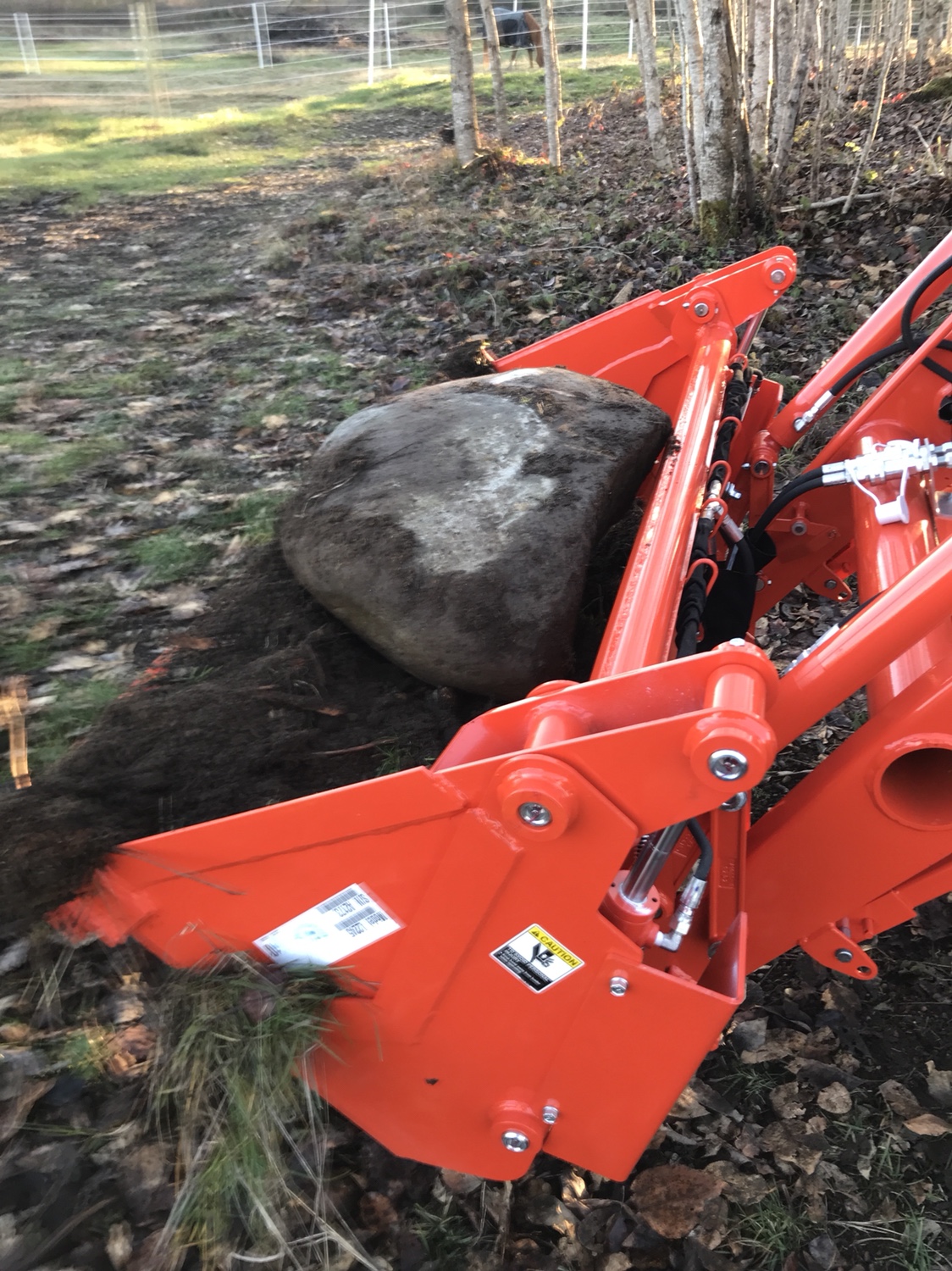

Those are the main hydro and the 3rd function cluster (I got a 4-1 bucket). They are all well routed and protected - don’t expect any issues.
The 4-1 set up is a total win win for me
The subsoiler pulled this Cooper Mini out of the ground and the bucket did the rest - and moving brush piles so I can sub soil
What a workhorse !!!
I have ZERO buyers remorse with this set up
Only problem I have is why I waited so long to get it.
Scott
