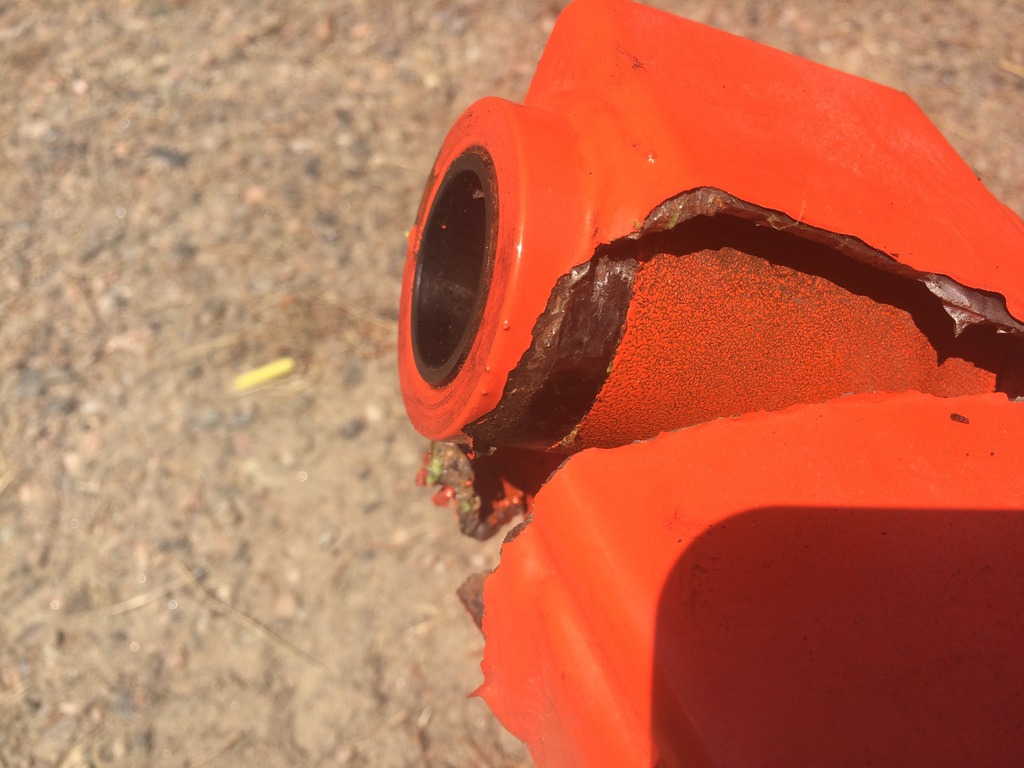

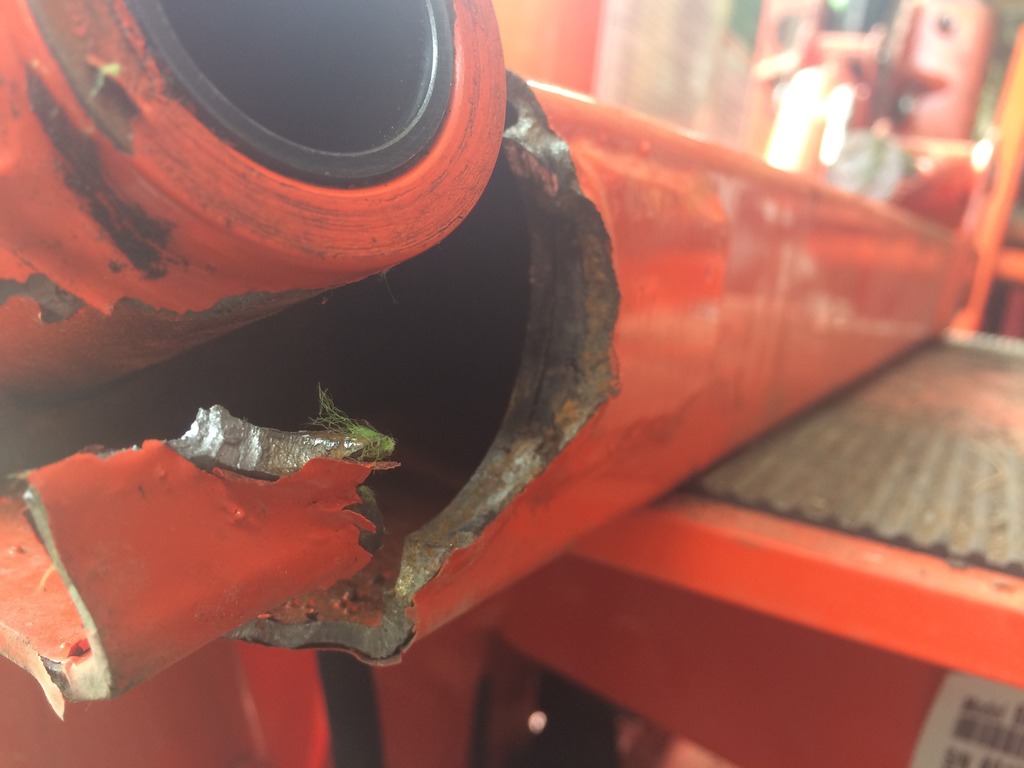

From the photos, it appears to be a bad weld which caused the breakage. I doubt that you need stronger metal although that would certainly prevent bending but it doesn't look like the metal bent any at all which tells me that the metal arm is plenty strong if properly welded. Lack of penetration is a common issue with MIG or FCAW welds which all manufacturers use. This is going to be an expensive repair due to having to replace the stab cylinder. I don't know what a cylinder costs but my neighbor just paid almost $200 for each dump/curl cylinder repair on his FEL and this was just to install new seals. Kubota might just replace the cylinder rod it the housing isn't damaged which would be a little cheaper than a new cylinder. (maybe /maybe not when cost of labor is figured in).

I was looking at the arms on the B26 and they have a plate welded around the pin to make them stronger, which is what this backhoe should have, not just a small piece welded in front of it.
I am aware that modifying something would void my warranty, but can't have arms breaking off like that. it appears it was a weld that failed, however now I'm concerned after seeing how weak these are made. I may do some measuring and see if a pair off a B26 will fit, or make some plates to weld around the pins in the same way as the B26.

That new, and under 100hrs......should be a warranty claim for sure.

Pulled the arm off and had a look, doesn't look like the weld had much penetration.
Could somebody with a B26 be so kind as to measure the width between the brackets where the arm mounts? The BH77 arm is about 85mm (3.35") wide, if the ones off a B26 would fit that would be much stronger.

That is definitely a flawed weld. Should be covered by warranty as it is obviously defective. Provided the pieces they install for the replacement are not flawed I think the strength upgrade you are looking for would be a non issue. Just my two cents.
