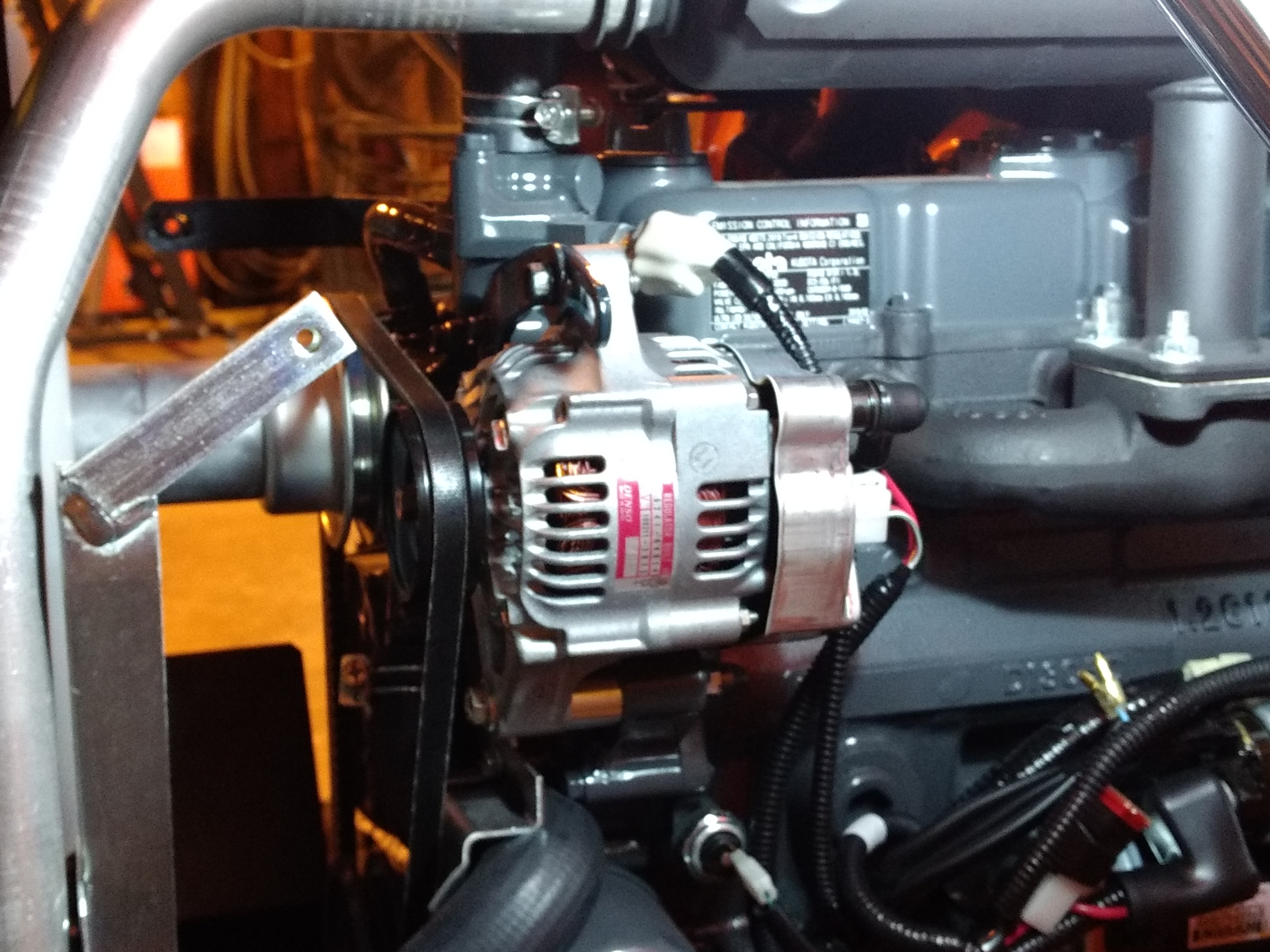

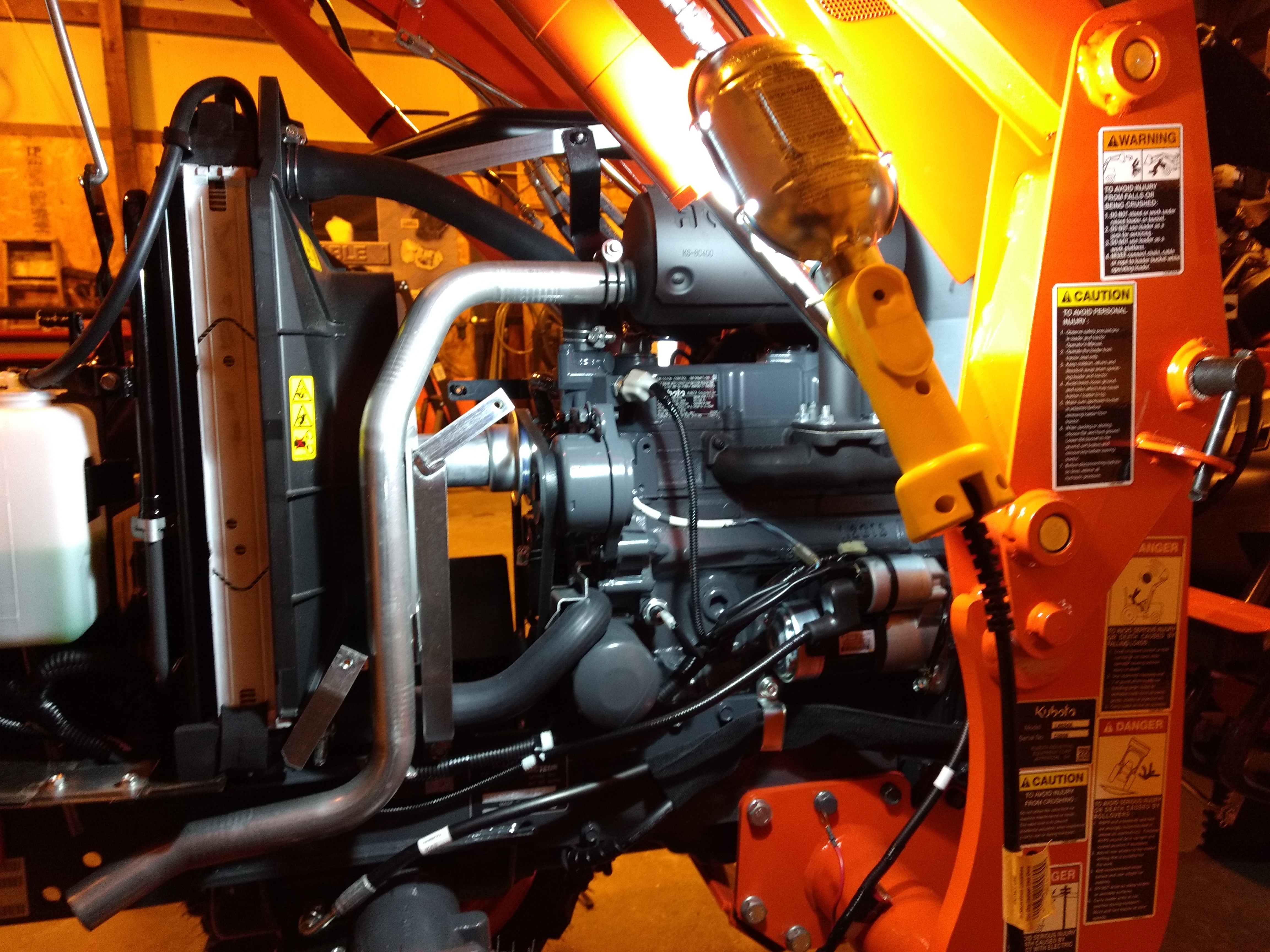

I have upgraded my G5200 with an alternator that is similar to the kit that Kubota offers to upgrade my B2650 from a dynamo to an alternator, I even used the same belt on the G5200. I believe it is a 40 amp nominal alternator, tested output of 54 amps, DB Electrical 400-52014.
