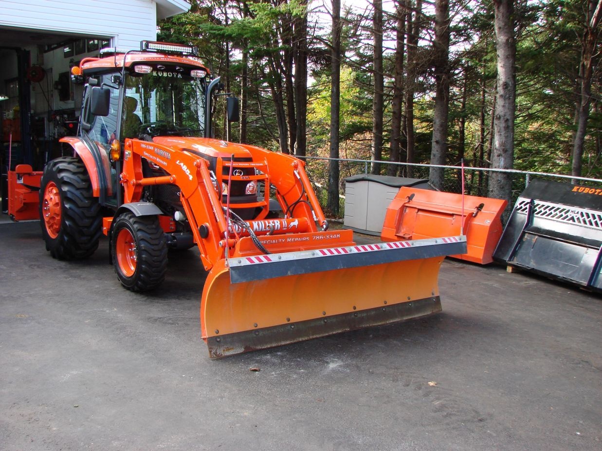

Thanks guys for your comments on my tractor. For me it's the perfect set up. The rear blower don't get used much. The only time I use it is inside a fenced compound that I have to keep free of snow. With out the blower I'd have to go in and take ever bit of snow out of the compound with a bucket because there's no place to push it. With the blower I back in and blow the snow over the fence and what used to take 1.5 hours can be done with the rear blower in 20 minutes.
For me personally I'd never get by using a front mounted blower. One reason Is they are just to slow going for my needs plus we get a good bit of wet snow and plugging would be a real issue. With the front angled snow blade it's fast as you can go. Only once was the snow to high to butt through with the blade so I made the first cut with the rear blower and the rest was done with the blade. The blade is a poly type blade so the snow can't stick to it. I do find the rear blower great in driveways where there's no room to push the snow. I don't use chains but I do have rear wheel weights on the machine. 800 lbs worth.
I like the fact that I can drop the blade and pick up my bucket in a few minutes. It's the ideal machine for MY needs. The cab is really nice to have. Yes the cab is a good bit extra on the cost but if your keeping the tractor for many years the cost will be minimal over the life of the machine and you'll have total comfort in with and summer with heat and AC.
