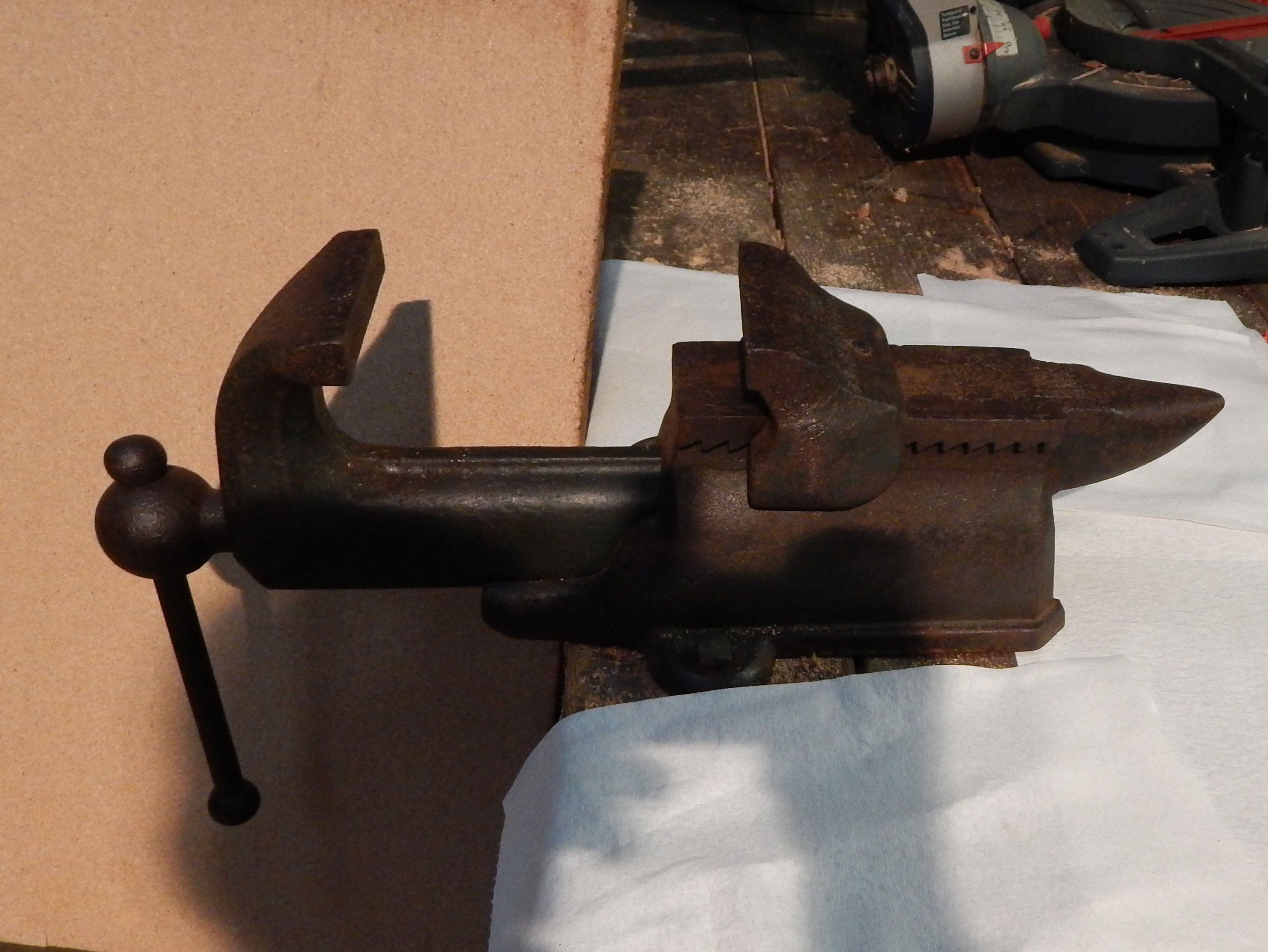

I bought a Rigid Machinist Vise in the 80's that serves me well... don't know if they are still made the same.
Here's a link that looks a little different than mine
https://www.ridgid.com/us/en/f-series-vises
Also have a hand-me-down that was blacksmith made... hand forged and I bet it will be here long after I'm gone.
If money is no object we had Bessy vises at the machine shop... guaranteed unbreakable with 90,000 psi drop forged steel.
http://www.besseytools.com/pdfs/sales_sheets/en/BESSEYVises_Eng_Mar212013.pdf
