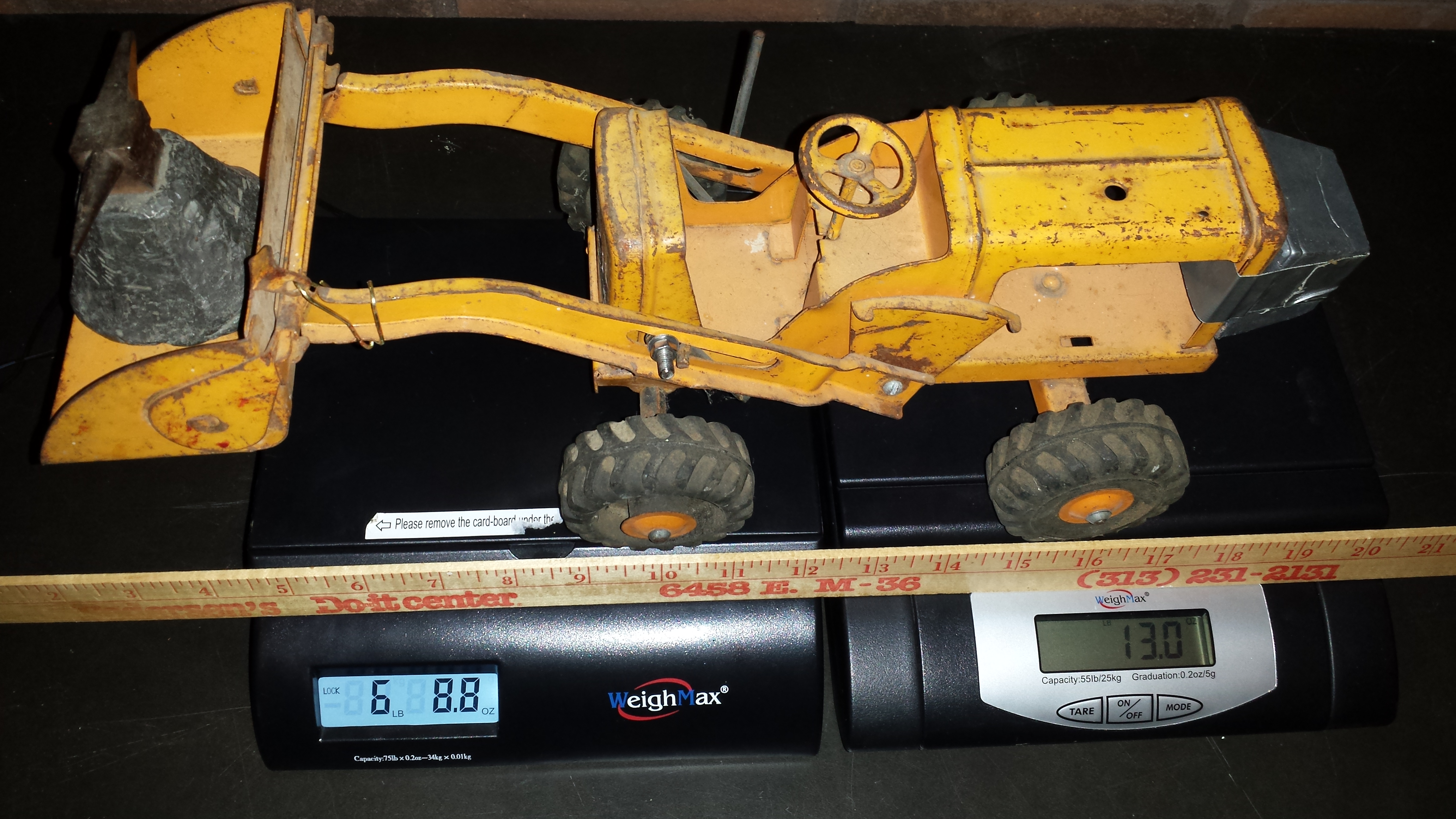

Construct an analog: take a paper plate, face horizontal and load it with sand to represent the 3/4 fill. Then measure where the balance point is. If the juice and sand filled the plate circumference, the CG would be in the center. At 3/4 filled, it will not be centered.
The use of fluid in the tires vs. equivalent weight by iron attached to the wheels will be the same as far as tread traction is concerned, but the actual difference comes into play when starting the tractor rolling. The iron will be part of the rotating inertia so the clutch/transmission final drive feels the extra load. Since the juice does not start rotating immediately (and actually may take quite a while to stir) the loads on the final drive are much less.
BTW: The use of a toy tractor, some fish weights and a couple of postal scales answers the question posed a while back about loader ballast, wheel loads and bucket position stuff. 20160307_230509.jpg
