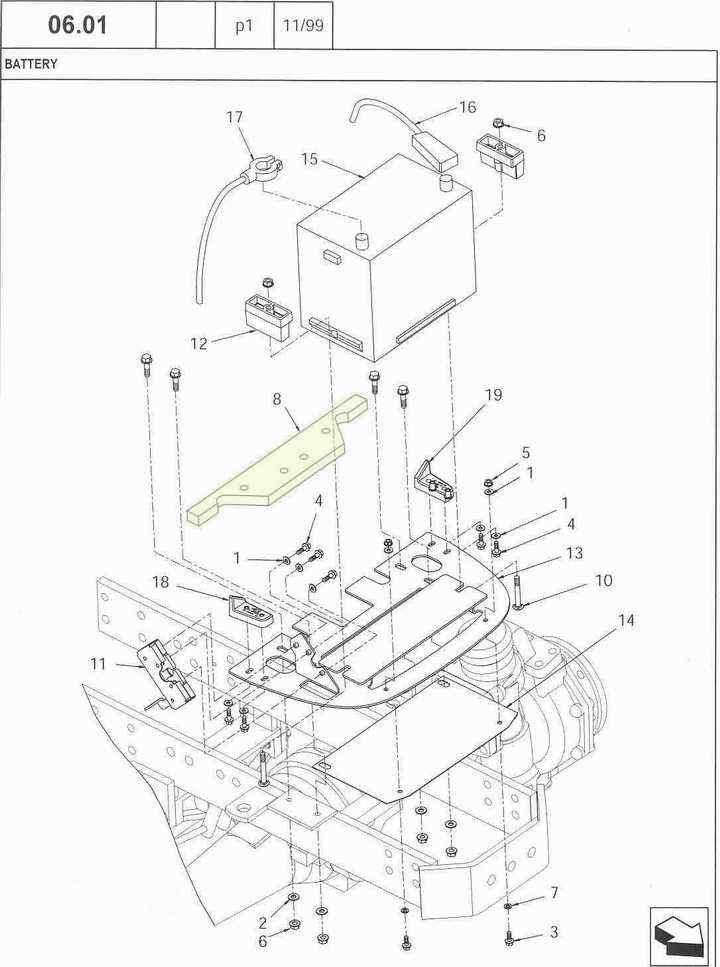

Mark, that's a nice job on your battery. You really have a great dealer who is taking care of you "above-and-beyond." I am curious about the grass I see behind your battery. The front of my radiator never gets anything but fine dust in it due to all openings being that small mesh screen on the top and sides of the hood. It's the same under the battery, a fine mesh. How is that grass getting into your radiator? /forums/images/graemlins/confused.gif
I went back and looked at your picture and mine. I think you are missing the foam piece that seals around your hydrostatic cooling lines. That piece keeps out lots of debris. When I got my radiator and hydrostatic cooling lines replaced, I got a new foam seal too. My radiator stays really clean. All I ever get is fine dust on it. It probably won't be a really big problem with your tractor, but I just felt like I should mention it to you.

Thanks, Jim. I'll check it out. The stuff in the radiator came from finish mowing a field after someone else had bushhogged. Some of the stuff left was so tall it was forcing itself into every nook and cranny under the tractor. If foam is missing, I'm sure it would be forced up there.

Mark, I'm attaching the illustrated parts catalog picture of the battery shelf and surrounding hardware for the Class III Boomer. The foam part is no. 8, shown with the light yellow tint (it's actually black). There are two part numbers listed in my book for this "rubber seal." Part no. 8 is 86400277 and they list a part no. 9 as 86400546. Both are called rubber seal, but I could not find part number 9 in the diagram. My guess is that the same part is use for hydrostatic and non-hydrostatic tractors and the part no. 9 covers the holes for the hydro coolant lines on non-hydro tractors. That's just a guess, so I may be way off on my guess. I hope this will help you identify the part if it's missing from your tractor.
