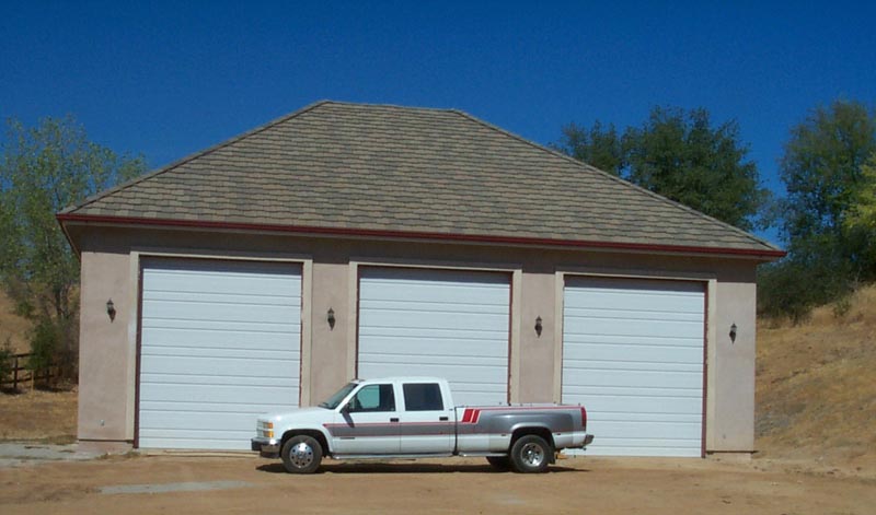

Here is the Barn I just finished. (This is the California wannabe-farmer-who-lives-in-a-place-with CC&Rs kind of barn). It is 53'wide, 42'deep, 16' ceilings. The doors are 12'w X 14'h. It has a clear span with no posts. The entire frame was covered with shear wall to pass local building codes for earth quakes. I am still building a saparate 30' x 50' shop that should be done in ~1month.

   / Barns and shop layouts #6
Sorry, Here is the picture.

Roger,
That is a pretty steep hill right next to your barn. Do you have any drainage problems when it rains?

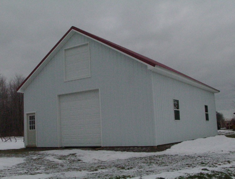

We just finished a 30'x40' barn with 12' ceiling and attic trusses. The attic trusses puts a room 14'x40'x7' upstairs that the guy will use for storage. We added a 6'x6' overhead door upstairs for moving large items and there are two end doors 10'x10'.
