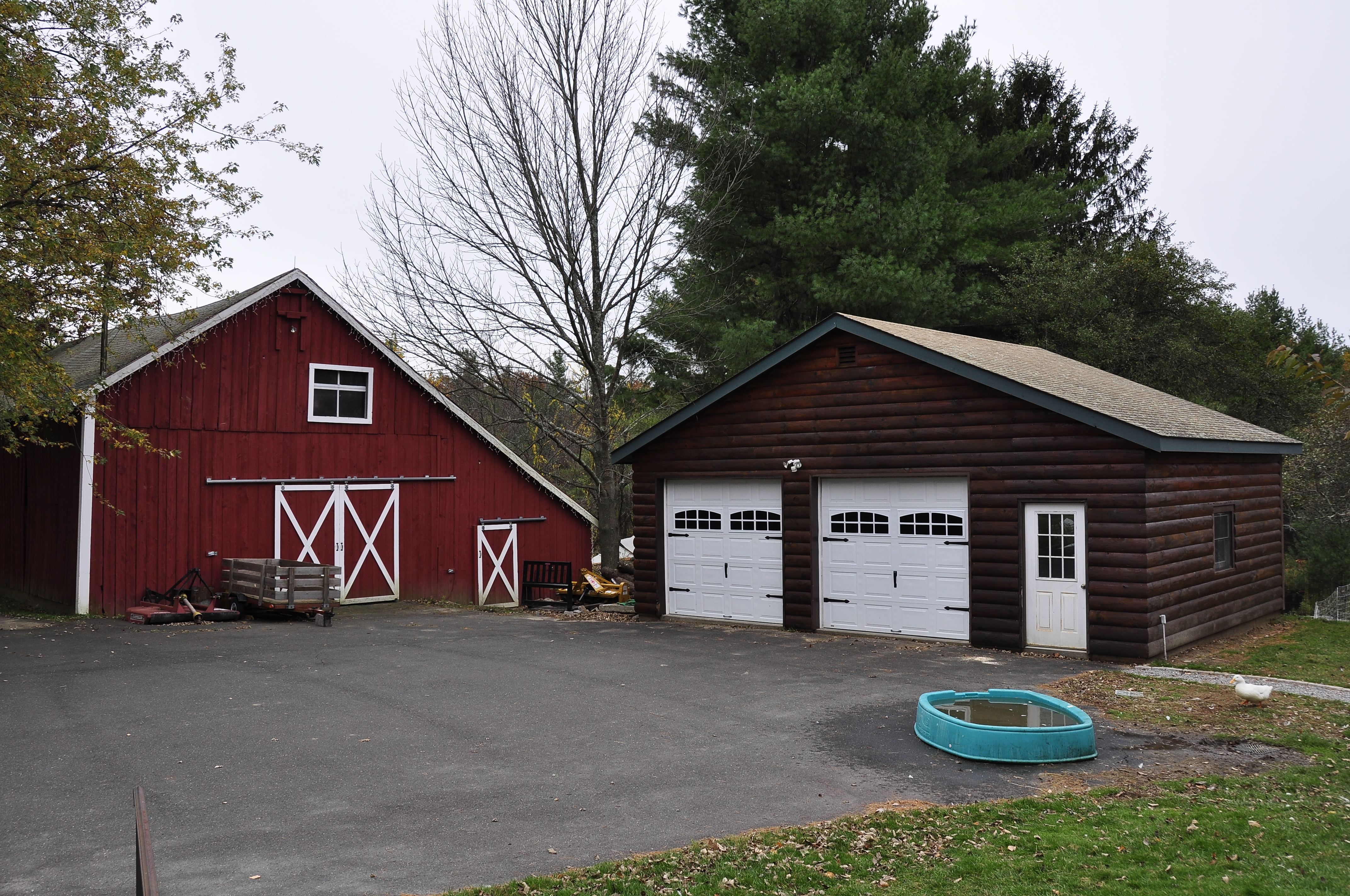

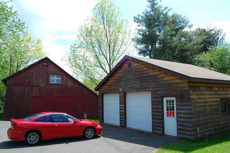

My place came with a 40x50 barn built in the 1800's, and the previous owner had boarded up the main opening with several sheets of plywood with a small people door in the middle. I built two 4.5'x8.5' doors from locally milled rough cut hemlock and hung them on tracks. Very easy to do, no maintenance, no issues. Hinges will sag over time, so I would avoid them. Rollup is good too, if you have a modern barn - would not look good on my barn.
