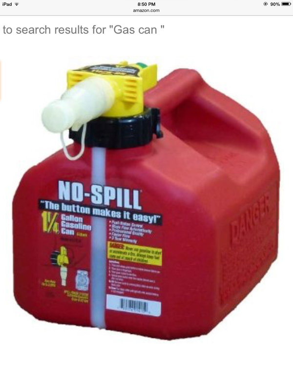

It doesn't help the op much, but you can still get a metal can with a funnel that is the best of the current cans. I have a 1.5 gallon can like the one pictured below. The 5 gallon version sucks and takes way too long to empty, but I actually like the small one for filling my small mixed gas tanks. The push button valve makes it easy to not over fill the tank or spill fuel trying to get the spout in the tank. It has a nice large opening when you remove the the spout.

The link I provided has a vent included in the kit.
