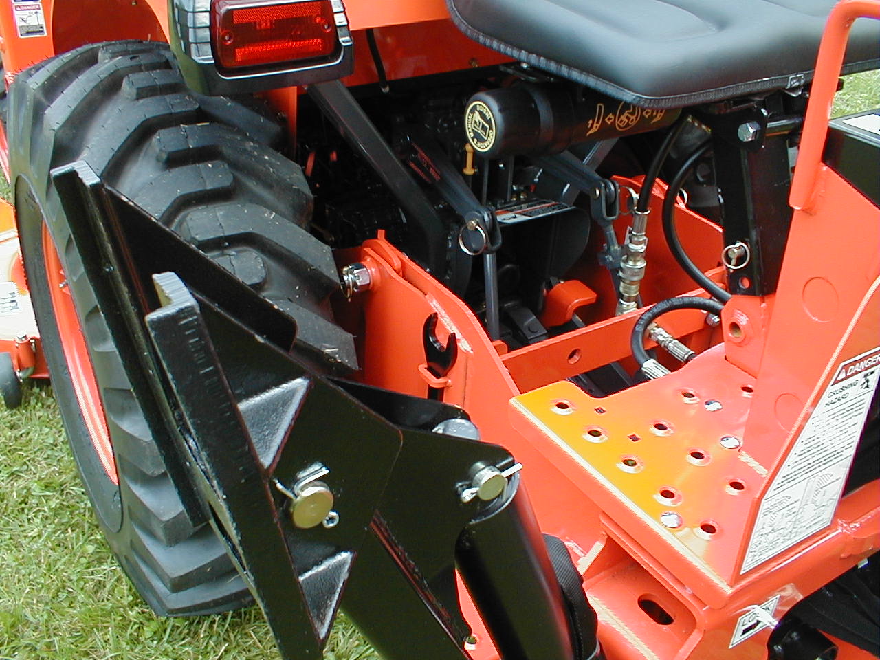

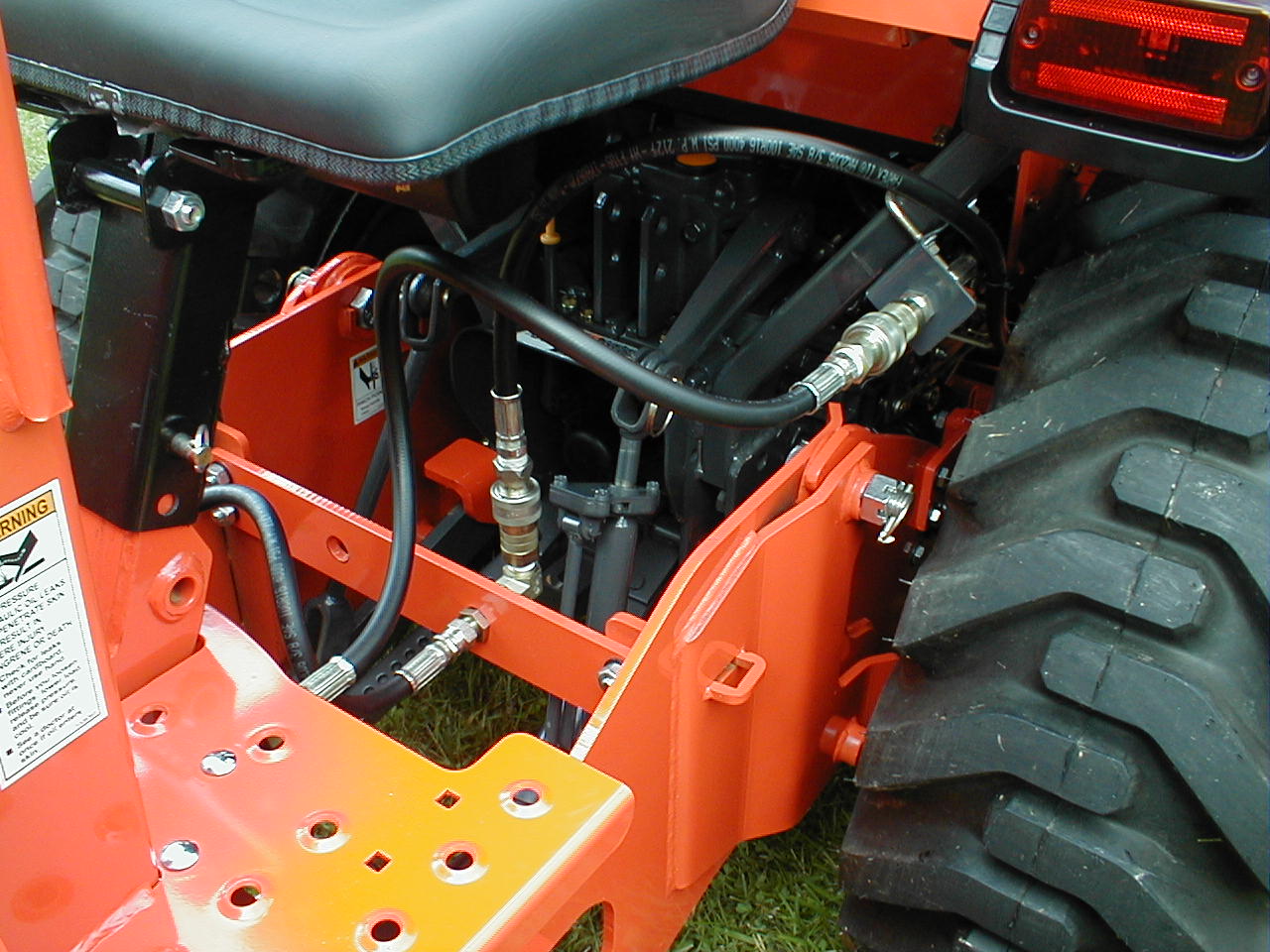

Yes, Woods has a 4-pt mount subframe that runs the full length of the tractor, and it is some serious steel. The 4-pt mount is roughly the same concept as Kubota's, but instead of pins at the top there's large bolts. The way the Woods 4-pt mount is designed I think makes it a little bit trickier to install than the BH75, but with practice anything becomes easy. I've attached a picture of how it looks on my B3030. They even give you a "ride-along" wrench for the top bolts, you can see it in the one picture (black).
You do need a FEL, but not necessarily because of the subframe. A FEL is a must because it acts as the counterweight against the backhoe. When digging you plant the front of the front end of the tractor firmly on the ground using the FEL bucket. Otherwise the backhoe is just going to throw the tractor around like a rag doll, and possible even upend the tractor. Not to mention all of the hundreds of handy uses for a FEL.
So FEL first, then Backhoe. For your L size tractor, you shouldn't consider anything smaller than the BH80-X. It would be perfect for it. You'd forever kick yourself if you got the "little" BH70-X. It's better suited for a B7610.

Does anyone know if you need to remove the 3 point hitch lift arms with the wood backhoe, and sub frame? Maybe it depends on the tractor model itself?
Thanks
Allan
   / Backhoe for B3030 - Kubota or Woods? #18
In Diesnutz pics I do see that you can leave the 3pt hitch on. That is one thing you can not do with the bh75. Although I have gotten pretty quit at switching everything out it would be nice to just leave it on ;)

DiezNutz,
Thanks for the response and the pics. Really helps to see it to understand how it connects. Dealer couldn't tell me if it had a sub-frame or not. He wanted to talk to an installer later this week. If the sub-frame is in the deal, it looks like it will be a BH-80X for me.
