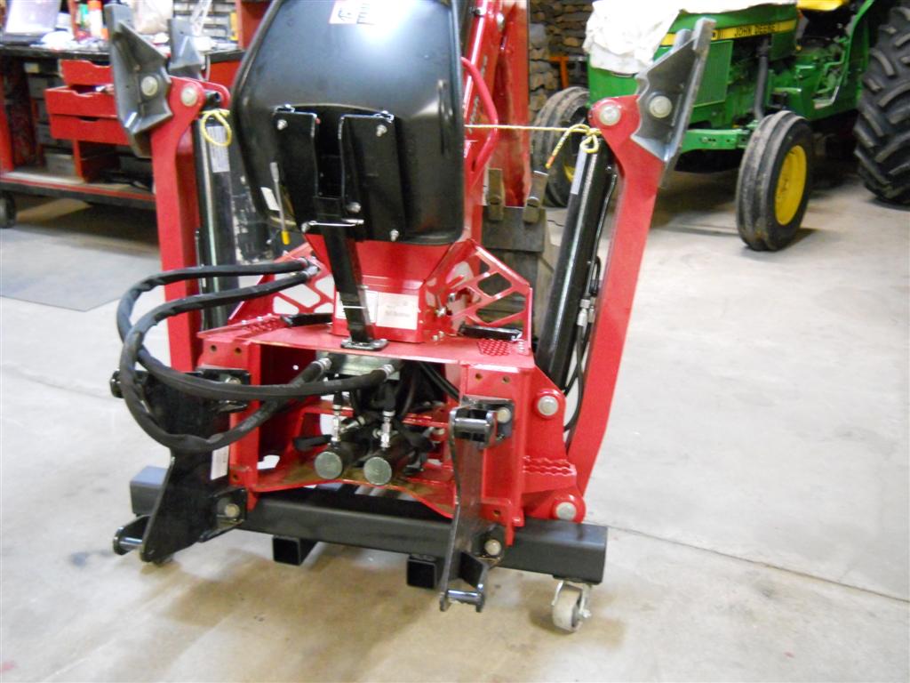

I'll be dropping the backhoe (a 448) off within a month (if the snow is gone!) and I'd like to store it in my garage, if it's not to tall for the garage doors.
Anyway, I know some of you have built dollies and I'd like you to post pictures of what you've done.
I have some concepts rattling around my head, but I'm not sure they'd be adequate for a 1500 lb 'hoe.
So, let's see what you've got!

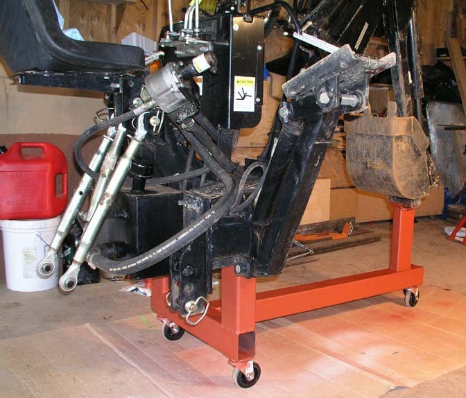

   / Backhoe Dolly #2
Way back in 2007 (http://www.tractorbynet.com/forums/...pineridge-bh-dolly-wow.html?highlight=backhoe) I built a steel dolly and it has been perfect. I don't know that PineRidge's original plans are still available, but I'll try to do a search. I know several others used modified versions for various brands. Not sure what my little hoe weighs (sure it is way less than 1500lb) but I can easily move it around on the barn floor.

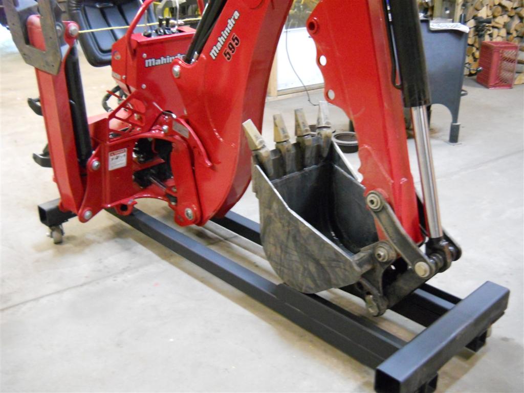

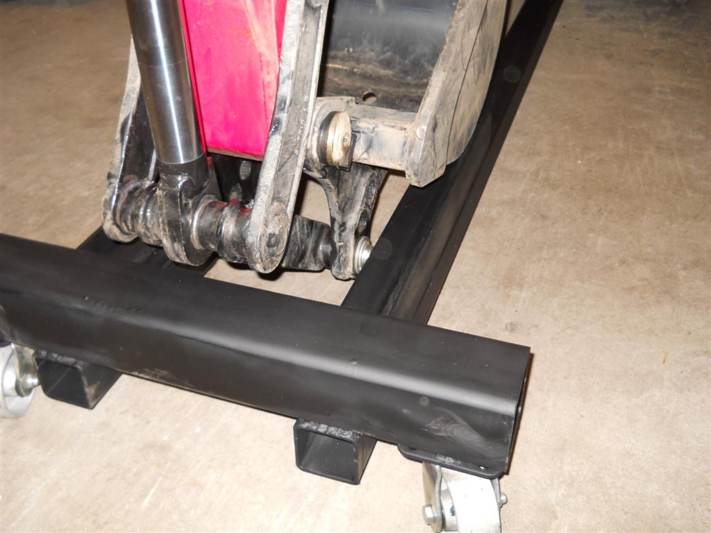

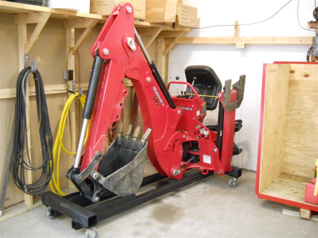

   / Backhoe Dolly #3
Here's one I built about 10 years ago.
   / Backhoe Dolly #4
Very nice. I'm jealous. I don't have a concrete surface to store mine so I block it up on 6x6 timbers outside. Always a bit of a hassle lining up the subframe the next time I mount it. Would love casters like yours.

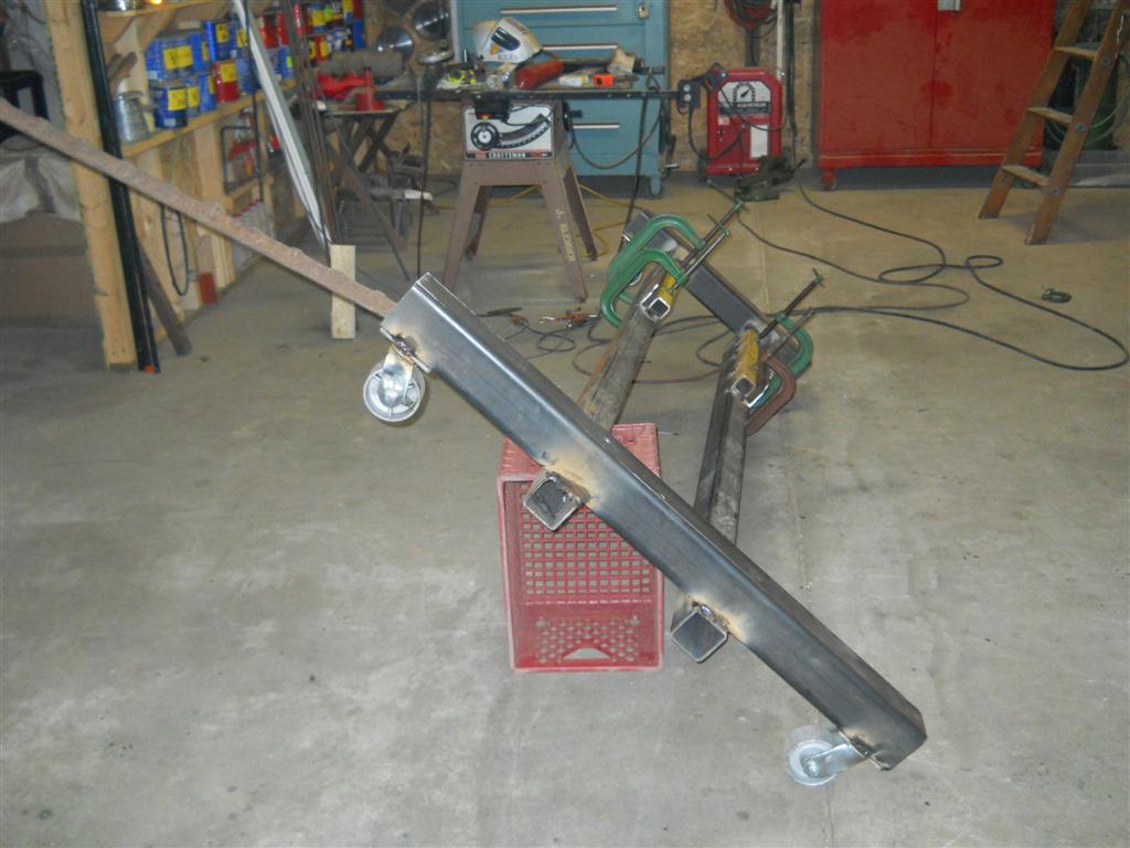

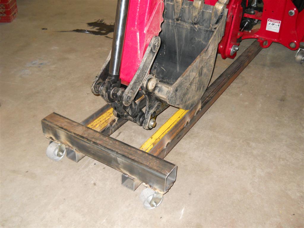

   / Backhoe Dolly #7
Built this for a 1500# Bradco built hoe... 4" for the cross pieces and 3" for the runners. Yellow 2" stock was put on to keep the knuckle of the hoe bucket from hitting the floor during loading/unloading. Heavy duty casters... The hoe sits down inside the frame a little and can't slide off... Takes a little to get it rolling, but the big thing is trying to stop it... :) Lay a couple two by fours under the hoe, raise them up and see what you can come up with....
