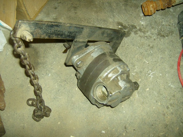

There's no model number, but it has "Webster" stamped in two places on the housing.
You might have the answer: bigger cylinders and lower relief pressure. I guess that if I used bigger cylinders then I could simply adjust the relief pressure to match the power of the tractor. If I find that I have power to spare, I could simply increase the relief pressure and have more force to work with.

Does this look like your pump?
   / Backhoe Design Ideas #147
I am used to seeing the PTO pumps like the ones by Prince. However, your Webster pump, looks like a regular hydraulic pump with a a PTO shaft adapter on it. What I am thinking, is that they are using a large cu in pump, and just running it at 540, or whatever the PTO rpm is. With 18 HP available, and a pump pushing 9 GPM, at 3000 psi, would require a pump with a displacement of 3.9 cu in. while turning at 540. If the pump displacement is larger, that means that you could use less rpm on the engine.
How much HP did the other guy have on his tractor, and maybe I can figure the size of the pump. The Prince PTO pumps also pump at 2000 psi.
#148
His tractor is a Massey 85. I think that's about 50 hp.

You could put some short hoses on the pump, prime it, and turn it by hand say 10 revolutions to measure the output in a graduated bucket or big measuring cup. 1 cup = 14.44 cu in.
   / Backhoe Design Ideas #150
A 50 HP engine can run a 25 GPM pump at 3000 psi, at 540, and the pump displacement should be around 10.5 cu in.
