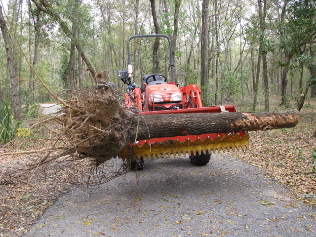

B3300SU has been excellent. My one niggling complaint was solved by replacing Kubota "turnbuckle" 3-Pt. "check chains" by Stabilworks pin-adjustable rigid stabilizers, which not only make mounting implements easier but are much stronger when pushing implements in reverse, most particularly pushing a Box Blade and pushing a Rotary Cutter.
I like the 14" ground clearance and excellent, open, flat-floor operator's station.
Now I want more overall weight plus more FEL lift capacity and draft control for pulling a two bottom Ford Series 101 Moldboard plow and box blade work. The Grand L's are also quieter.
