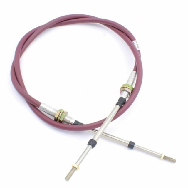

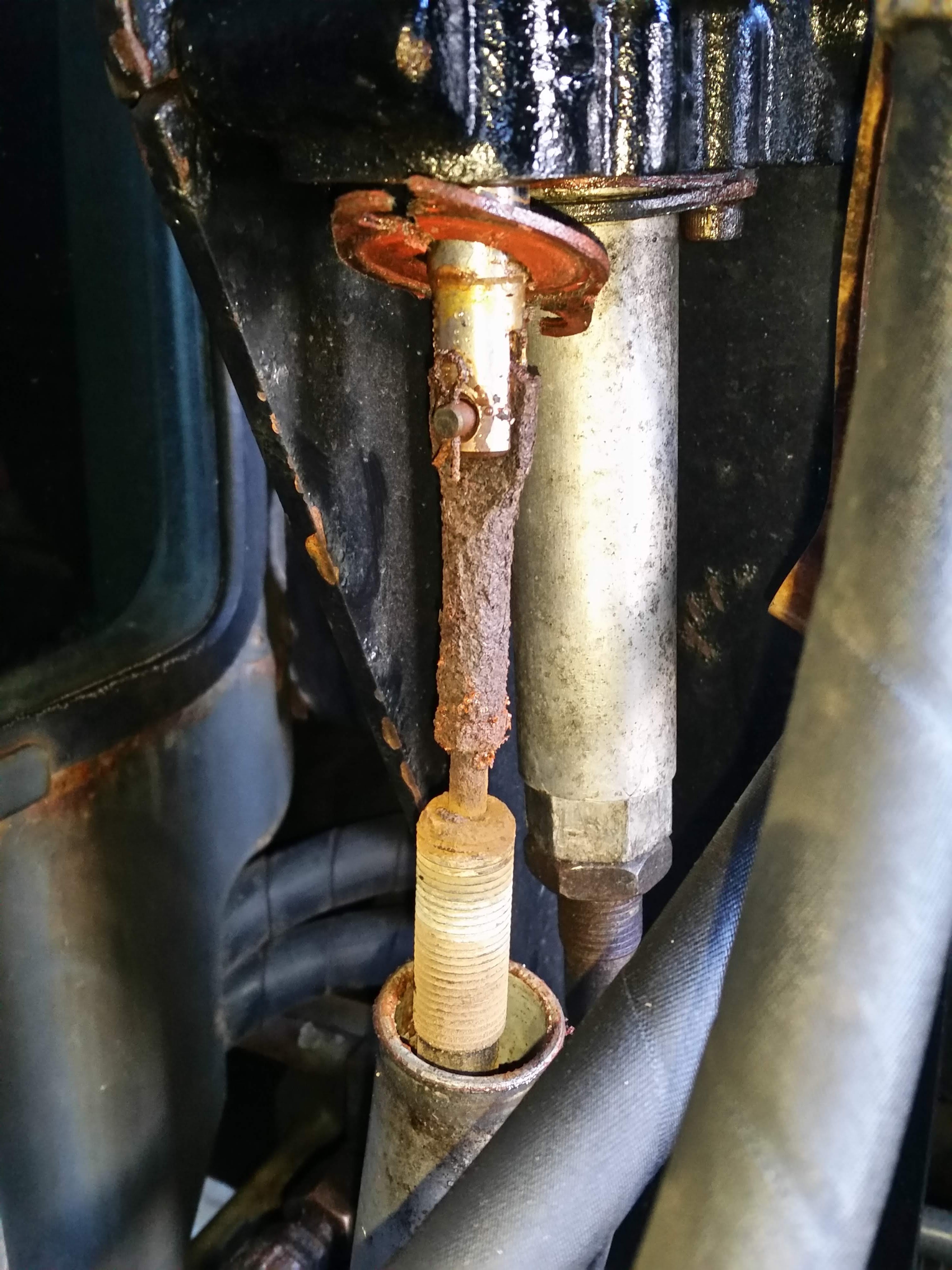

I'm having an issue with the cable to raise and lower my front snowblower freezing up and not allowing the joystick raise and lower to function. When I used it last weekend, it was a little stiff but loosened up as I used it. I always clean off the tractor and blower and sweep off the snow after using it, and it got stiff while I swept it off. Tonight out of curiosity, I went out to my pole barn to see if it would be stuck, and sure enough it was. I aimed my salamander heater at the low point in the cables under the cab and a few minutes later, the joystick was freed up. Looks like I'll be disconnecting the cable at the valve and seeing if I can get the ice/water out of the cable housing. Anybody else ever run into this? I replaced both cables three years ago.

I think you will find the Kubota cables are a more complicated design than the typical motorcycle cable tool is intended for.
I bought a large animal syringe at a TSC store and used its needle to pierce the rubber seal and inject gas line anti freeze into the cable.

Sure it’s the cable? Look at the loader valve that cable runs to. On opposite side where cable enters their may be a couple spring caps. These often have water in them that freezes. Often as warmer oil circulates in valve, it warms up and becomes easier to use. Unscrew cap and drain.
Quick test would be to heat caps only next time it freezes, with a hairdryer or quick flick with propane torch and see if lever releases frees up (not freeze up).
