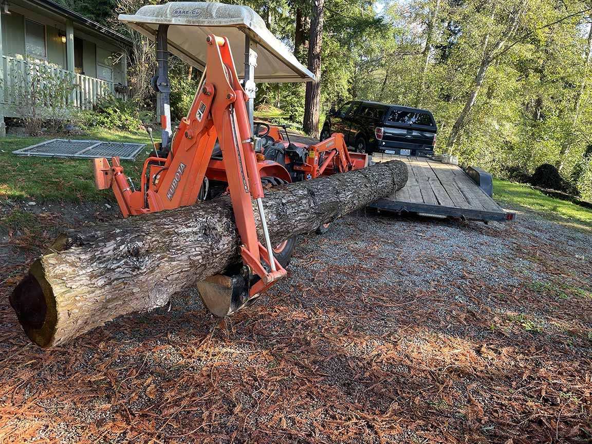

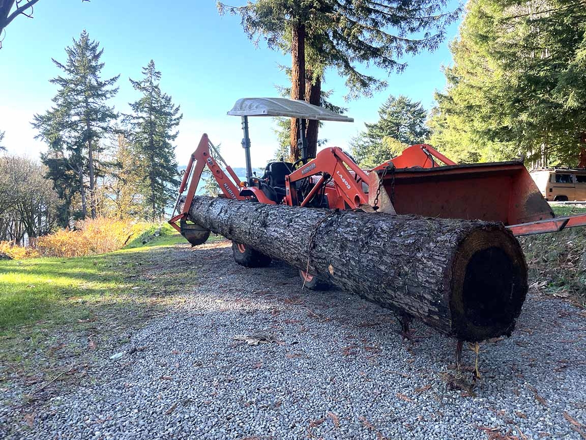

Was a little tippy but I got it on the car trailer.
Redwood, 22 feet long, headed for my bandsaw mill...

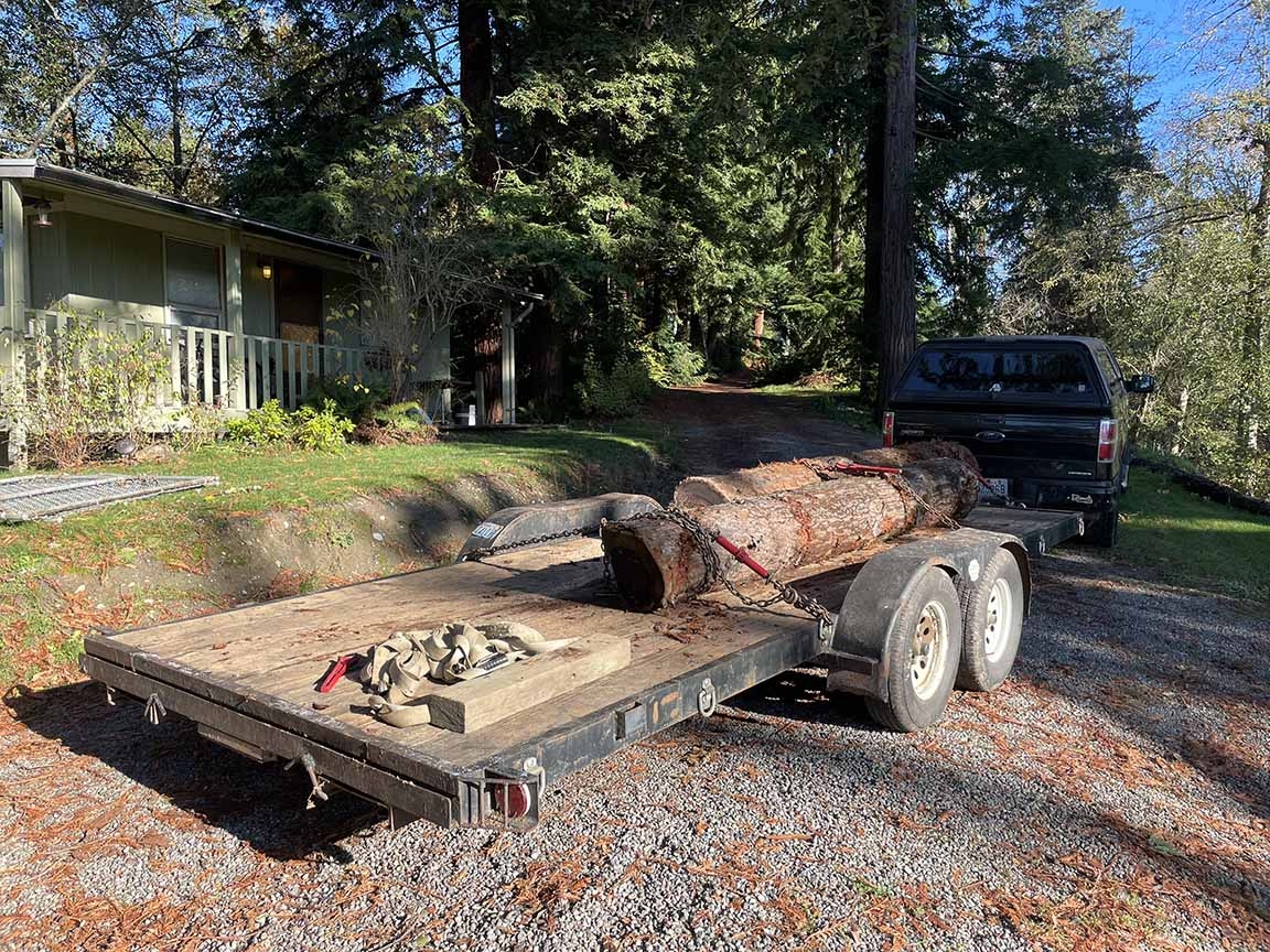

I didn't like the tongue weight so I had to cut it in half, (dangit).
Ready to roll

That's one neat way to carry a log like that! Another use for a BH....
Too bad you had to cut it.

Ingenuity. I love it. How heavy you reckon that log was?
   / B3030 gets it done! (backhoe carry 22’ log on side)
Thx!!! No idea how heavy. Been down six months.

Was there any other short logs that you could have loaded ahead of the tailer axles to balance the overhang? I have done that to help on the tongue weight. Jon

I like it - very clever !! A little tippy you say - I bet you were leaning left :) That should make some nice lumber.
I have used a similar method with my L3010. Pick up one end and back under. Then push it up.

   / B3030 gets it done! (backhoe carry 22’ log on side) #7
There are several log weight calculator charts available on the internet.
Example - log species...coastal redwood... average diameter - 20"... length - 22'... estimated weight - 2400#.
I use a log weight chart when handling my big 'ol Ponderosa pines.
And I must say - a most interesting way of moving a long log.
Thx for reminder 😤 that there’s Log weight calculators all over the web.
Nice one on www.woodweb.com
Redwood 2nd growth 19”, 15”, 22ft 1300lbs.
It felt like more.
Anyway if thats true I bet I could carry about 25% more.
B3030 is only one step up from the smallest size Kubota.
Agreed it wouldn’t take much to weight the trailer but I thought I’d be cutting 10footers anyway.
